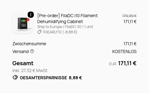

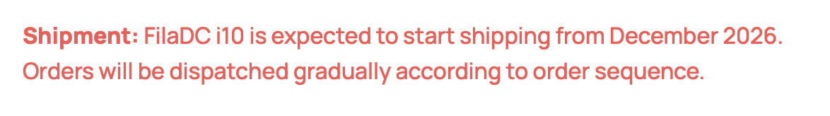

So the great Sunlu release has come and gone. I ordered within fifteen minutes or so of the opening for orders.
Today I thought I’d check in and see if there was any word on when I could expect delivery, since the documents I had were somewhat circumspect.
Imagine the outcry if this was a Prusa product!!
Well now I have time to experiment with other desiccants!
I imagine that depends on whether they have a big pool of orders ready to go and fully functional, -or- instead they trickle out not-quite-finished initial builds while frantically trying to get the product working as advertised while delaying the builds to a trickle.
