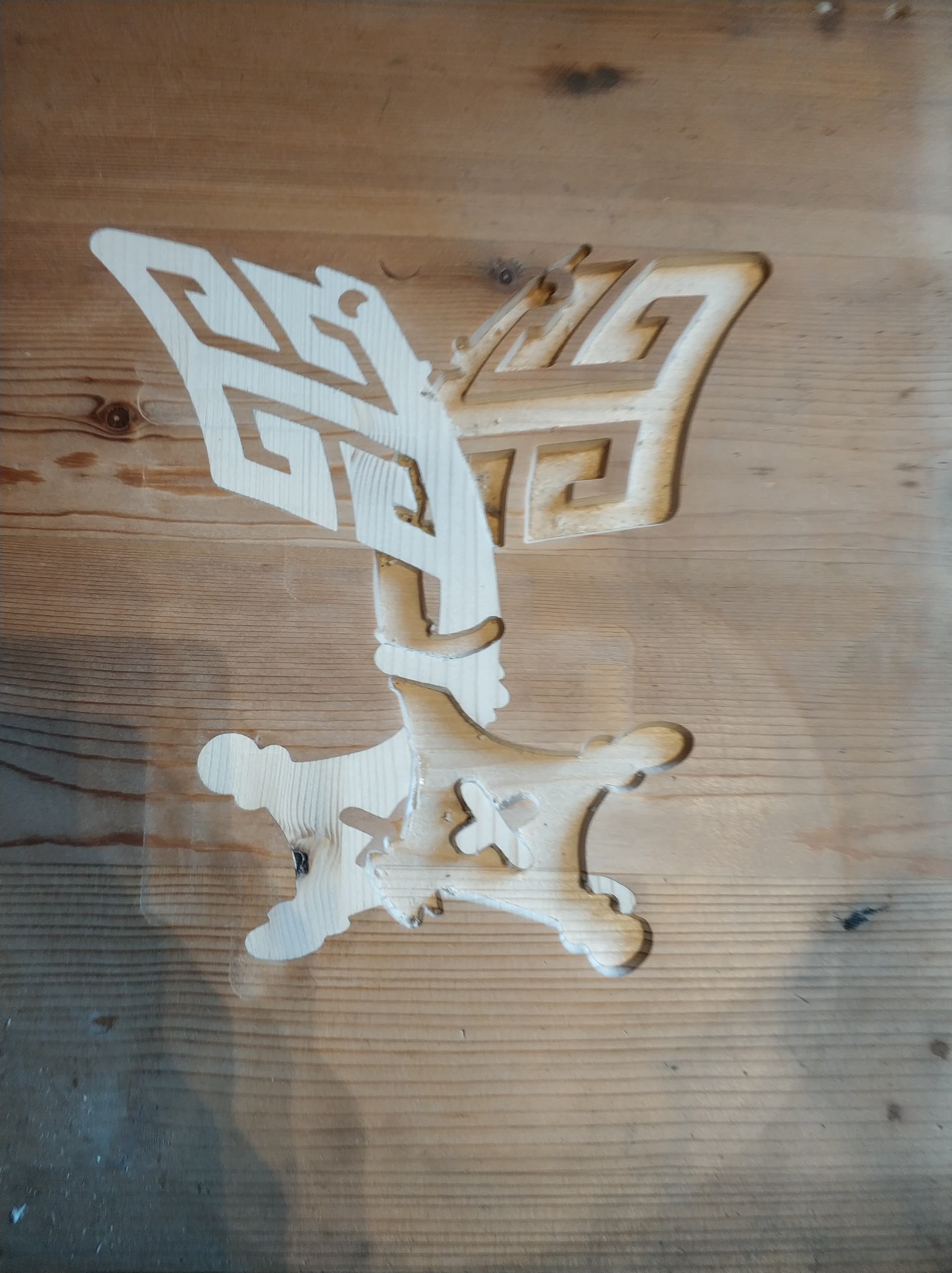

Hey Tony, I have been playing around with different methods to do inlays. For shallower inlays I use Estlcam and set the starting depth for the plug lower (there is a thread around somewhere on how to do it), for deeper inlays I use F-Engrave. I had the same problem you have in the beginning where I had two V-Carves that had to be done separately because it was a two-colour inlay. I cut the negative with Estlcam using two layers and the plug with F-Engrave. That worked surprisingly well. :slight_smile:
Interesting approach. Makes sense to cut the plugs in f engrave. How did you ensure that the size was identical between both programs? Maybe that’s the part that can save my bacon.
I’m also looking at vcarve right now. Solving the problem there is trivial. I can do it in Fusion with a fair amount of ease, but the second part of the job is much more tedious in fusion, and it looks like I’m finally jumping ship anyway.
I took the same dxf for both and left the size on 100% in F-Engrave. For the depth setting I used the same depth that I used in Estlcam.
For the cat in another thread I tried to leave some space for glue and set it to be milled less shallow but somehow that didn’t work at all. I planed 2mm off of it so I’d have some space for glue, then it also worked. I haven’t really found the best way to do deep inlays.
V-Carve does (ironically) not offer a good solution for V-Carve Inlays either as far as I know. I did install the trial, but it does not have the same options that F-Engrave has, the prismatic overcut option does not exist in any other program as far as I understood it, and that’s the most brilliant thing about F-Engrave (even though it is missing the option to leave a gap for glue). Maybe V-Carve can do negative offsets for carvings, then it would be easy peasy lemon squeezy to do deep inlays with it.

Okay, by chance I stumbled upon a V-carve video and the guy really opened my eyes. Not because of the video, but because of the trick he uses that you can find in the description. This is the video: https://www.youtube.com/watch?v=t3whlKDAxYY
And this is the genius thing he does:
Vcarve Pro - Vcarve Toolpath
Pocket:
0.0" Start Depth
0.25" Flat Depth
Inlay:
0.27" Start Depth
0.01" Flat Depth
Granted, you need to be sure your endmill can mill 6mm deep, but that should not be a problem if you are going slow. He explicitly talks about it.
We did have a similar approach in the thread about inlays with Estlcam and me saying that going so deep is not really easy, having starting depth plus inlay depth etc. The genius thing is to set the flat depth to basically 0 and then just cut the inlay part without the need to go lower. If he wanted to have some space for glue, he’d start at 0.1 flat depth. Maybe that was obvious to you all, but it just clicked for me, because it is basically what I am doing for my shallow inlays, but I somehow miscalculated and thought I needed like, 10mm DOC in one go, but no, 6mm DOC is absolutely possible, I did that before. Just go slow. I am going to report how that went.

Flat depth is basically the bottom of the inlay. When just mirroring it with the same cut settings the plug won’t fit. So you are pretending that the bottom of the plug is only 0.5mm deep when cutting it (which is the space for glue later), and then tell the CNC to start 6.5mm below the surface. The cut will be 7mm deep then (in one go, that is the drawback compared to F-Engrave). You then have a 5.5mm deep inlay and 1.5mm overcut that sticks out of the pocket for easier removal.
Edited for details. :smile:
Why do you have to make the full cut with the v bit in one go?
Can’t you cut all the flat part first with an endmill, then sneak up on the profile with some outside-in roughing passes using the v bit at full depth? Very little load that way.
For the inlay pocket you can use your normal strategies, limiting DOC etc. For the plug that does not work because you are cheating the program in doing a plug with the right size. Since you are pretending you are cutting air and starting deeper, you can‘t do it with the DOC settings. It is cutting 6.5mm of „air“. You can definitely add a flat endmill for clearing first (and you should), but when you look at his video, most of the carves are so small that there is nothing to clear before, so the V-bit has to cut the whole 6.5mm of „air“ plus the 0.5mm until it reaches the flat depth (bottom).
