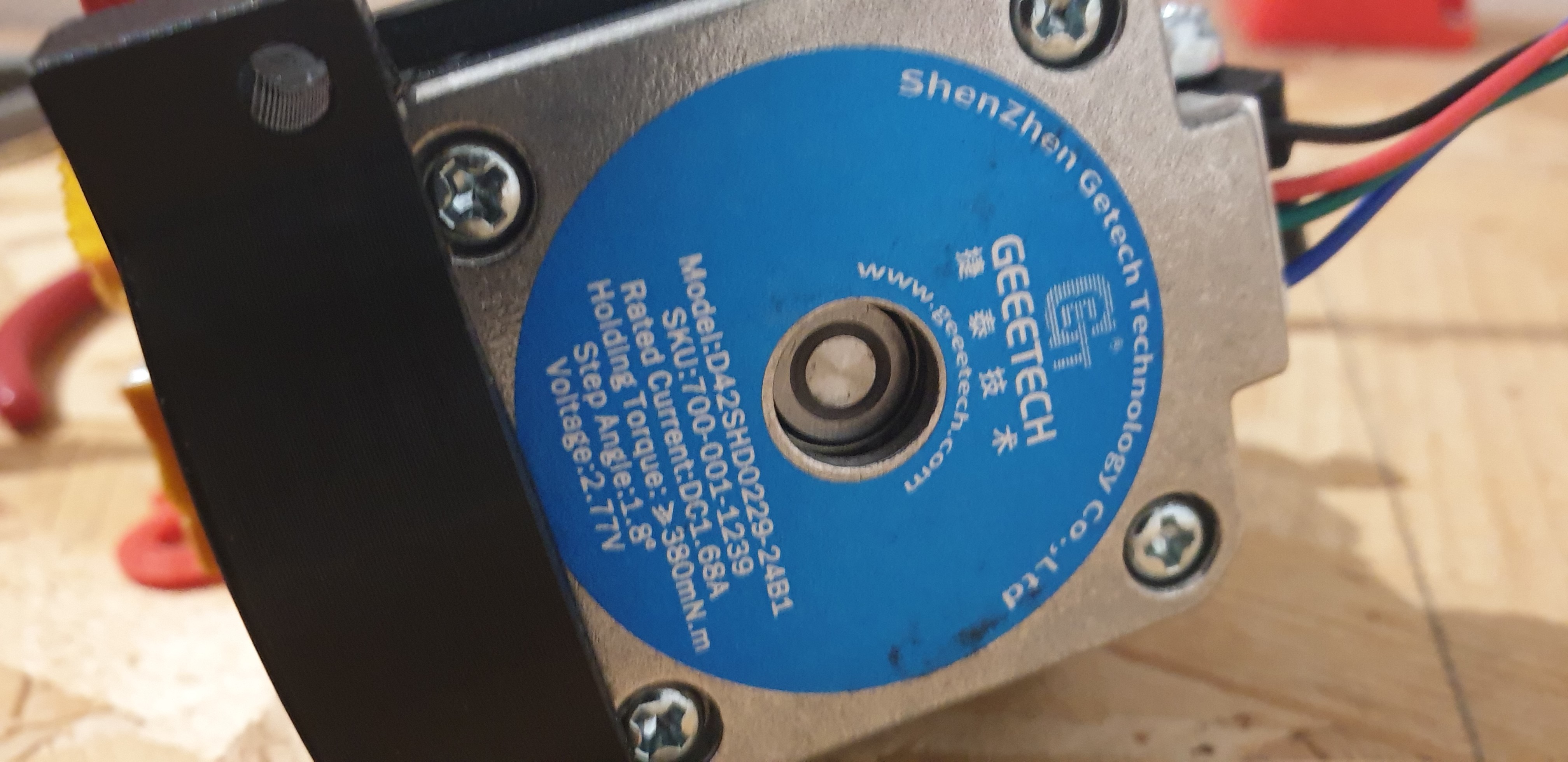

For the life of me I cant get my mk8 extruder motor to turn a full rotation it seems to skip around back and forth. I even took the whole thing apart and tested the motor alone.
Its some geetech motor.
I have read that this could be voltage issue. So I tested the values of your firmware which is 138 which is 70% and also tested 90%
I have switch driver with z axis motor it rotates perfectly. But the geetec wiggles back and forth while in the z axis driver.

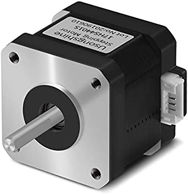

I bought a new cheapie motor off amazon and it behaves exactly the same.

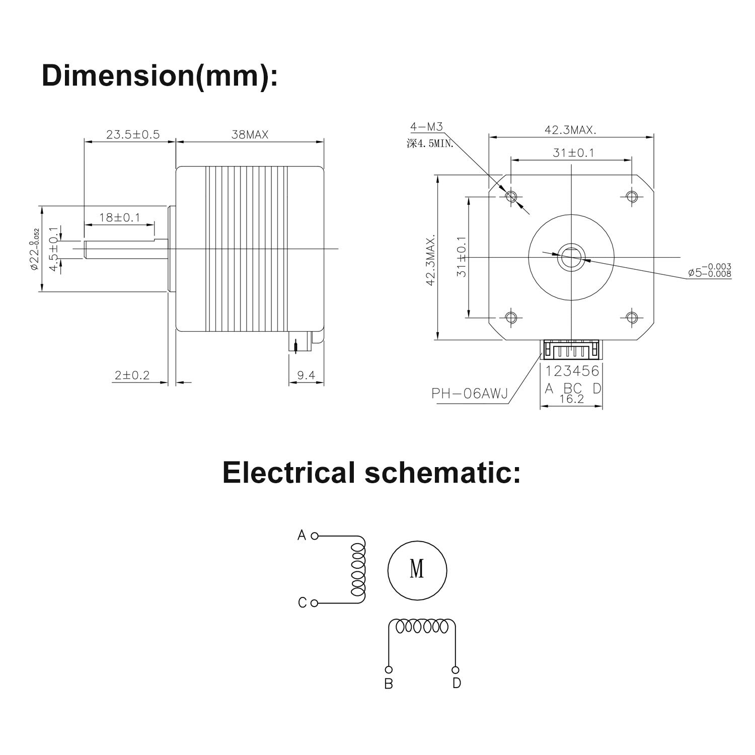

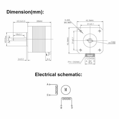

Thank you guys I have some things to try. In the mean time I found this diagram relating to the wiring of the motor. I’m gonna link the motor I bought here to see if any of you professionals can spot why it might not be working. It might not be suitable at all I just bought the cheapest I could see at the time to rule out the broken motor.
The schematic on the motor diagram confirms that the connections for the windings are interspersed as I supposed.
Looking back at your original photo, Black and Green should be one winding, and Red and Blue the other. If you can put the wires into order as Black-Green-Red-Blue on the connector to the stepper driver you should be in business. If the motor runs backwards from the desired direction, just flip the plug around and it should then run the right way.
I can confirm my windings are wired like that from the beginning. Interestingly in the exact same colour order’s. Which is a funny coincidence.
I did try swapping to green black blue red yesterday in case it was a polarity issue.
