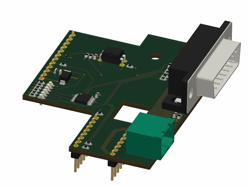

Following comments on ESD protection and 3,3 to 5V shifting, I’m working on a PCB adapter that takes signals from Jackpot controller and provides the 5V signals, 30V/5V power and ESD protections for the OTK-3 knife.
The PCB plugs into MOD1 socket and C axis sockets.
I’ve put DB15-SUB plug for easy connecting with OTK-3 who has a DB15-SUB female…
There are also leds for all signals.
I’ve got the following signals :
  • Enable - out
  • Direction - out
  • Step - out
  • E-Stop - out (powered or dry ???)
  • Home - IN (dry switch or signal???)
  • 0-3V knife speed
  • 5V+ control power
  • 30V+ step motor power
The only things I’m not sure about yet are the OTK-3 E-stop and home switch signals, can’t find anything about with the OTK-3 expect, and Stepcraft hadn’t reply to my info request yet. That’s a bugger, I don’t like when a business doesn’t acknowledge requests even if they can’t answer…
Interesting.
do you need / have level conversion?
If you search, Bart Dring once made an adapter that sat in a Polulu socket and did all the conversion.
That was discontinued when the six pack external driver controller came out- but the design is open source. Might be worth at least a once over.
It converts:
  • Enable, step and direction from 3.3 to 5V. (and maybe E-Stop signal if needed)
  • 3.3V PWM to 0-3.3V steady knife speed signal
  • Home input goes through an opto isolator to generate the 3.3V input.
The circuit would have TVSs, capacitors and ferrites beads for ESD. The DB15-SUB casing is couple to ground plane with capacitors and resistor for ESD…
This is an example of how Jackpot V1 will remain relevant even after Jackpot V2 ships.

You may want to look at the design of the 6 Pack Universal CNC Controller, too. A quick skim of the tangential knife manual leads me to believe that the 6 Pack board already supports what you’re looking to do. It supports a 0-10 volt output module and its stepper module outputs are already level shifted… Bart has a $2 breakout board for external drivers (without the level shifting of the retired board) for it, too.
The new 6x board comes with 8 inputs, and 0-10v output, rs485, 5v signal, external drivers ready and some MOSFET outputs
The things is only the knife control is a 5V external driver, I don’t need external drivers for the regular XYZ axis. I don’t know, I’m just making my head around this project, maybe you’re right and using all external drivers, but it looks simpler to me using the internal TMC2209 drivers…
If you dont need external drivers for xyz you buy the regular 6 pack. Populate xyyzz with tmc2209 and the extra driver buy the external driver adapter
Please note: you will need all the io modules: 2 input module, 1 0-10v module
Yeah, that’s why I suggested the version for the stepstick drivers (same as you’d use with a Jackpot) and the IO modules. The stepstick driver pins are already shifted to 5V on that board.
Yes beside the controller and the external driver adapter

Instead of using a stepstick with an external adapter, could I config firmware to use pins for enable, step and direction on an MOD socket for the OTK-3 knife ? That way I could design a special MOD including the DB15-SUB plug for it…
So I could use the stepstick sockets for XYZ axis, and a special MOD pcb for OTK-3 plug.
Yeah, with UART functionality.
The “special adapter” just loops the direction, step, and enable pins out to the motor pin header on the board, along with allowing you to select between gnd and vdd for common. You could certainly just connect your board to the stepstick headers.
I don’t think the module sockets are fast enough. For the Airedale IO Expander, Bart says that it wouldn’t work. I think it’s similar for the case you suggest.
https://www.tindie.com/products/33366583/the-airedale-io-expander-for-fluidnc/
If you’re going to go the route of creating a PCB board, I wasn’t meaning to deter you from heading down your original path… just suggesting another design for the level shifting for reference. Using the 6 Pack board and some I/O modules, and just wiring things into a DB15 connector does seem like the path of least resistance, though. It all depends on whether you’re looking to spend time on your interface board project, or if you just need to get something working so that you can start using it.
