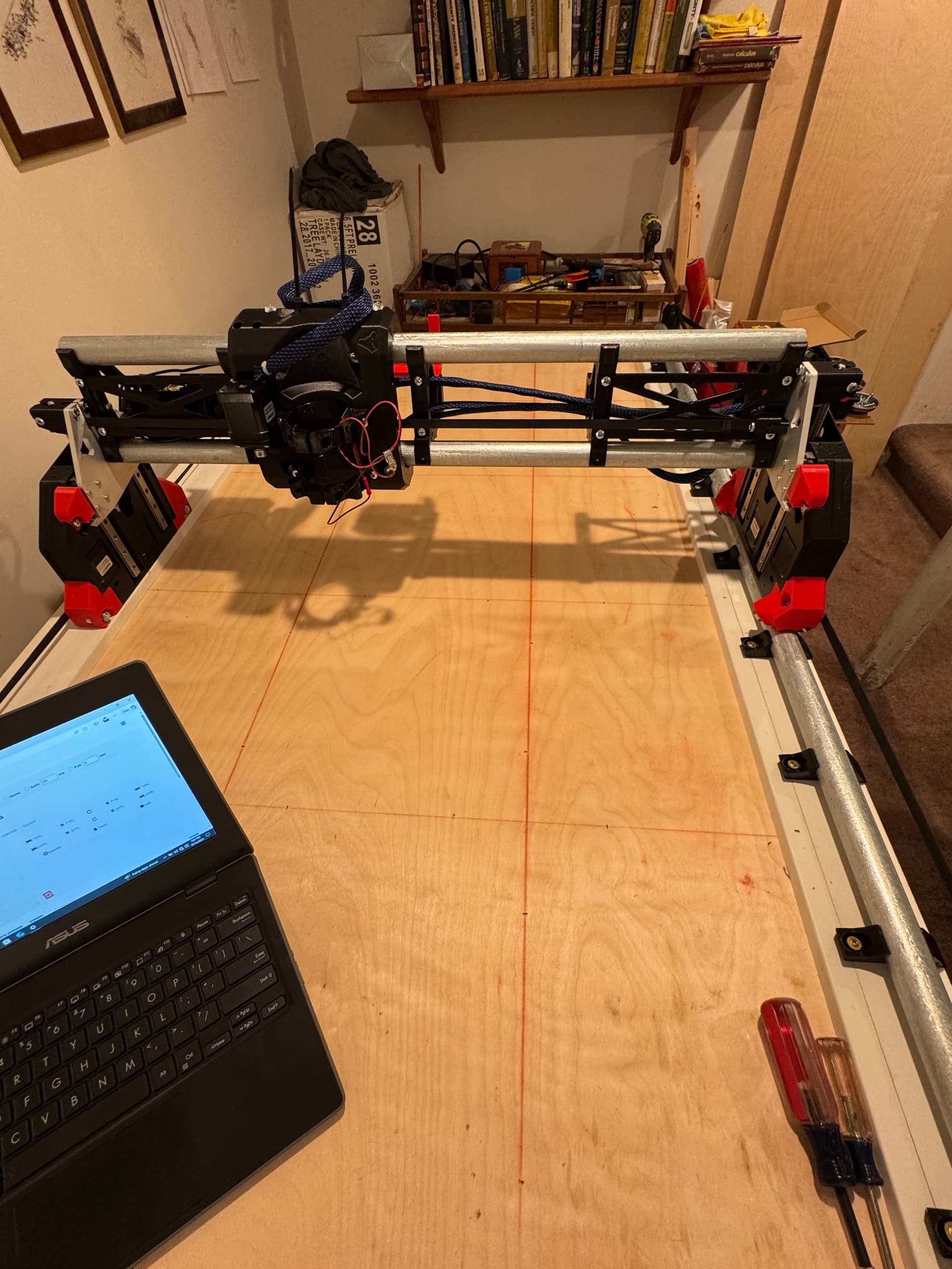

Exciting time. Really loving this build. I checked the squareness and am at about 3 mm so I will fine tune. But overall happy. I know 2’ x 4’ (600mm x 1200mm) isn’t very big but seems so much larger the my 400 x 400 Primo.

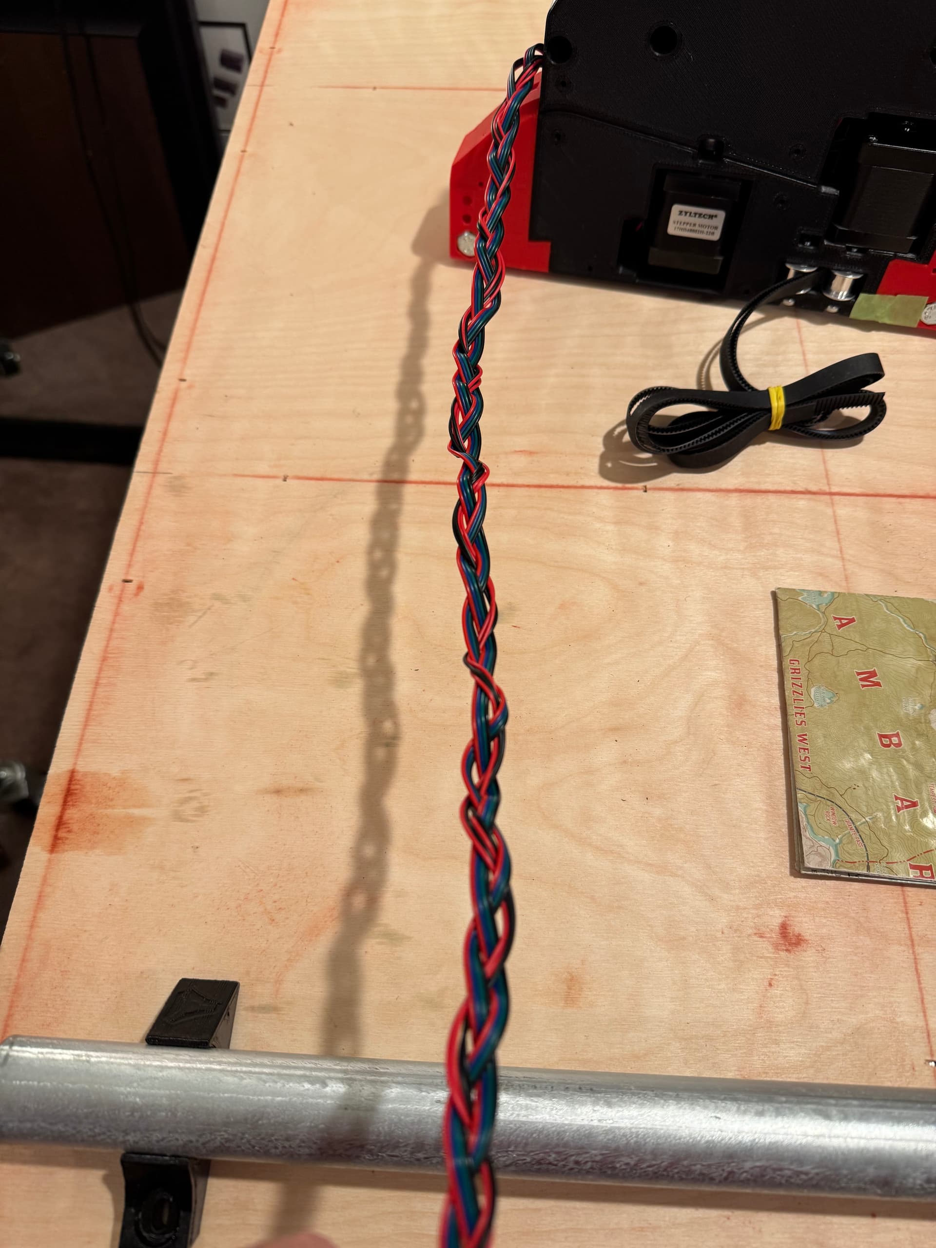

For fun and to keep them together I braided all the wires. Only takes a few minutes (have two daughters I was called to duty a few times :grinning_face_with_smiling_eyes: ) I ended up still putting the sleeves over them.
Question: I did not take a pictures but my X min side Z axis of the beam lowers the moment the power is stopped. Is this normal? It seems some use space blocks to lock the beam when not used. I have not lubricated them yet. I did put in the cross screws but I have it completely loose?
TIA
Yes, normal.
If you park the core at XMax and turn the power off, that side should drop as well.
Yes, A “park” gcode is highly recommended. I use mine to Home Z, Home X, lower Z 100mm, $MD power off steppers. I thought I had on in the milling basics page, I will make a note to double check.

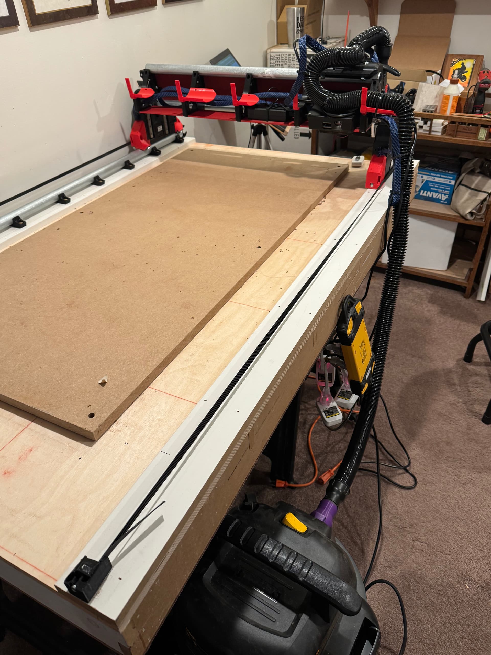

I do need to figure out how to properly ground the vacuum before I use it. but for now don’t need to use the vacuum.

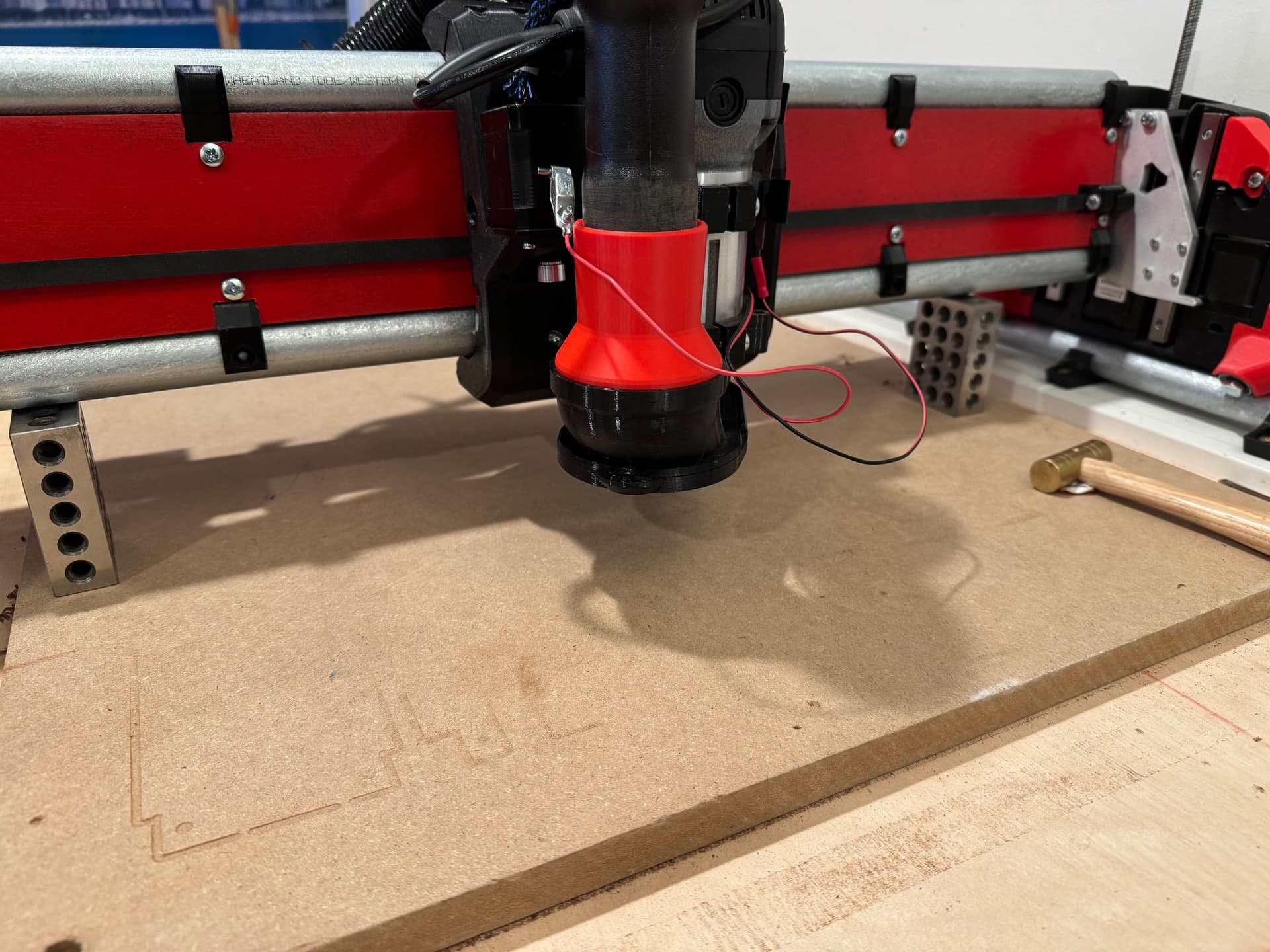

Also for truing the Z I thought I would use my handy 1-2-3 blocks to level out to the lower conduit. Any feedback appreciated on this approach. Also same question the Z end stops are adjustable. Do I tweak the physical endstops or once again do it in the software??
My 1-2-3 gage blocks under the beam. I can baby step Z down to just touch.
TIA!!
If you are under 2mm, software is probably easier.
Software, z is usually pretty good but I always finalize with the software offset. I added a little gcode example in the instructions.

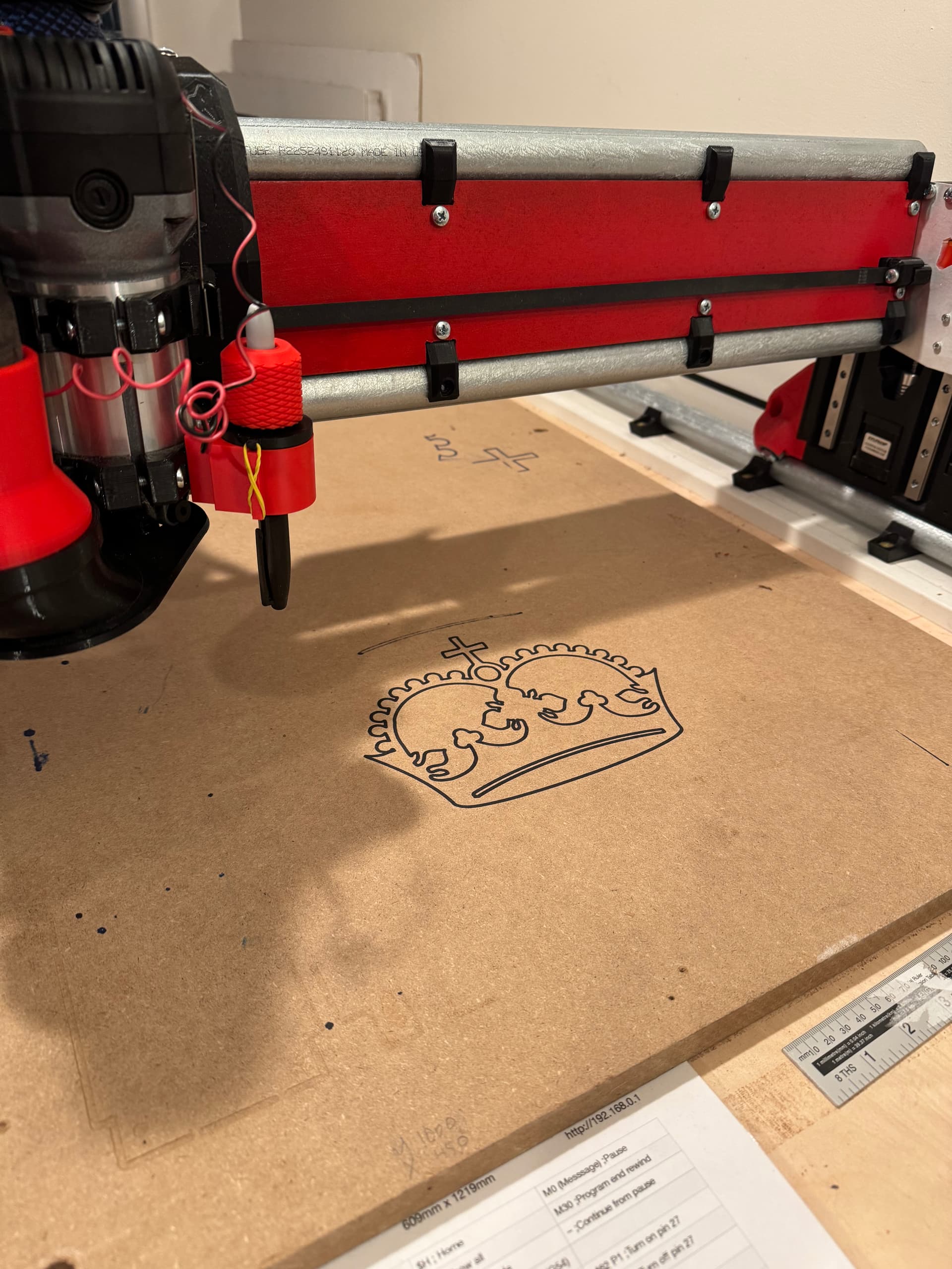

I have been massively enjoying my LR4. So much I want to name it but my wife thinks that’s creepy. I wanted to demonstrate for the family that visited yesterday and I thought using the marker and drawing the crown is always impressive and not so noisy.
I decided to design a universal penholder that I could use rubber bands for the flexible “give” and also mount to the handy provided hole on my Makita mount. Happy to say it turned out nice. Had fun showing off at Thanksgiving :joy:
I used a split collet to hold the Sharpy. And the rubber band of your choice.

How did the drawings come out? Any crowns?
Yep :+1:
