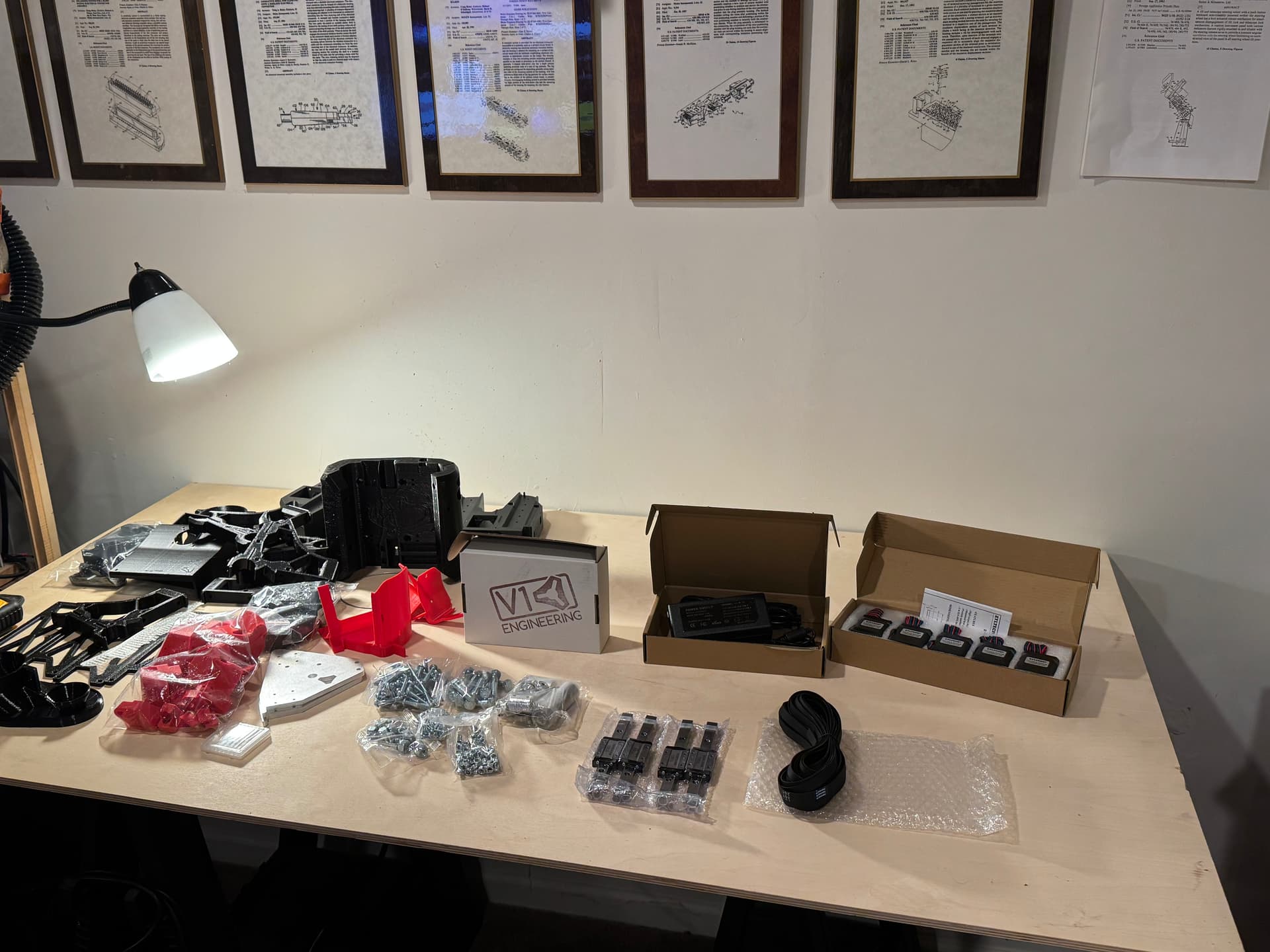

Excited to have received two boxes perfectly packaged for V1 for my LR4 adventure. I especially want to call out the team for the very clever hack to use some filament as a retention “cage” for the nuts in the core. Equally impressed by how all these parts can be printed without supports.

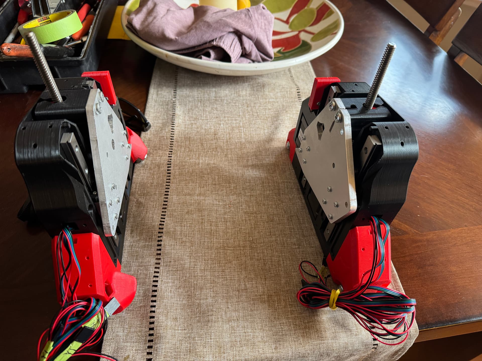

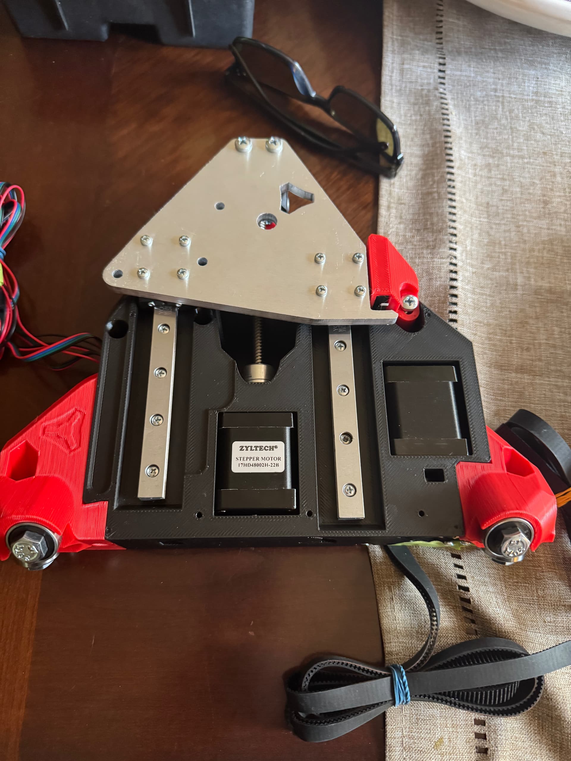

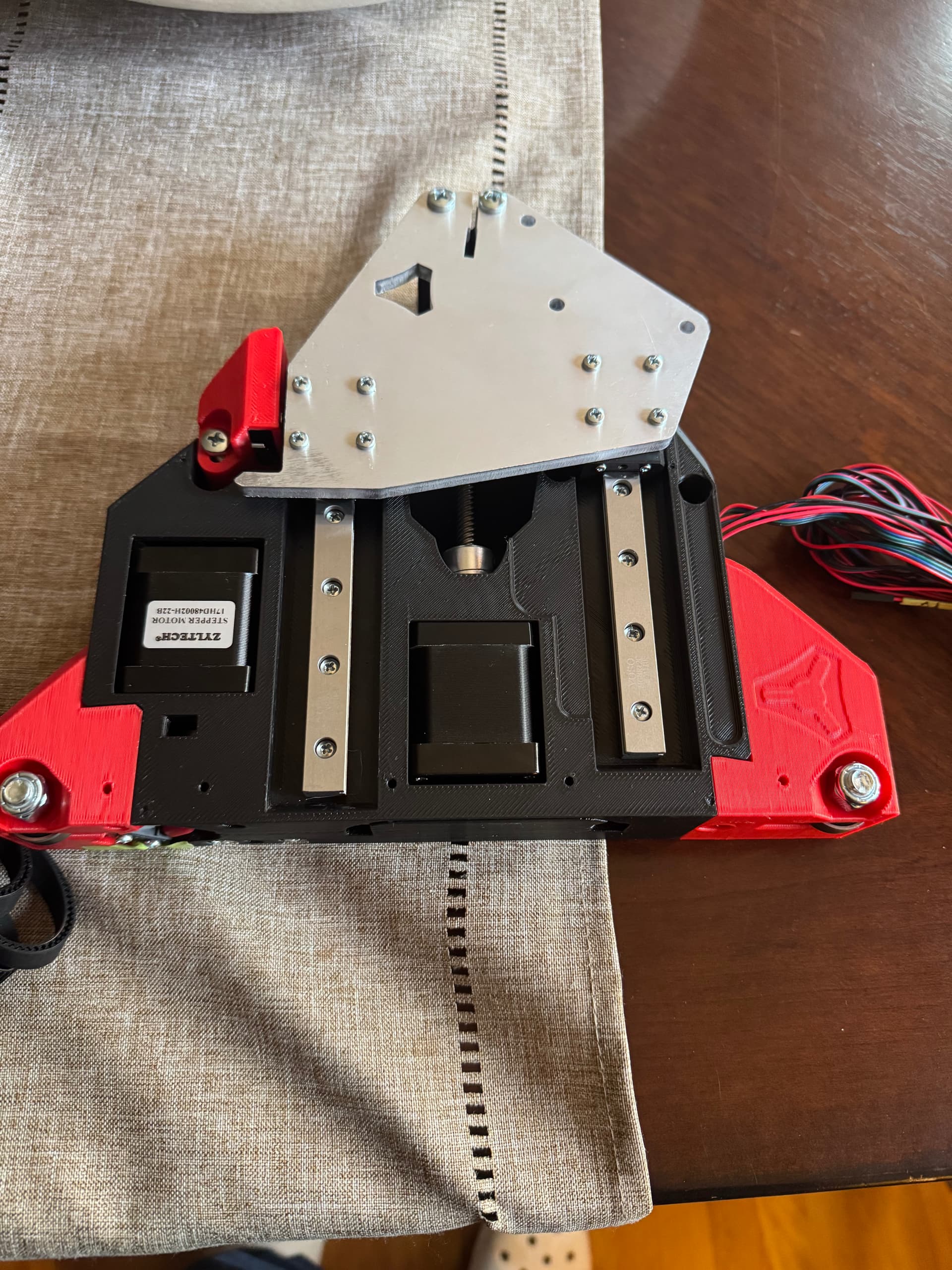

Made some good progress in the first phase. A couple observations and some questions?
  • Very impressive design and the YZ ends are so impressively solid. I bought all of the parts from Ryan but I want to D/L into Bambu Studio just to slice and see the geometry. I never knew you could have these passages going through a print. My professional world (retired now) was designing electronic connectors for Molex for 30 years and my head is still around injection molding. 3D printing opens up such possibilities.

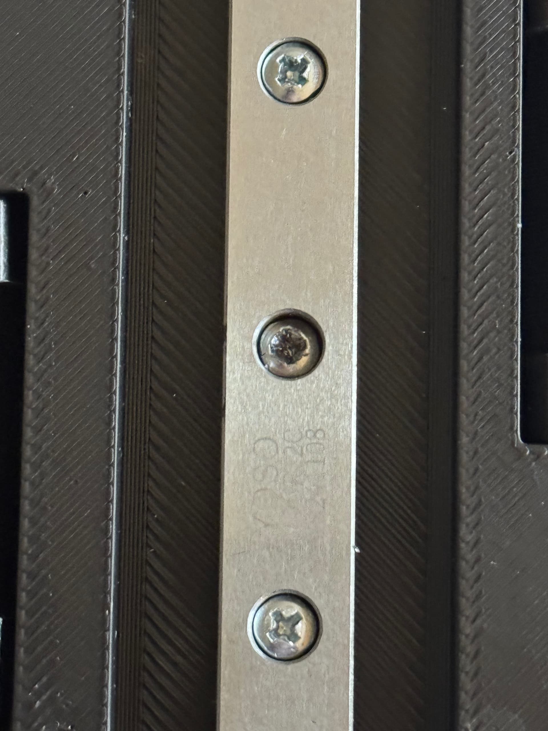

  • Attaching the linear bearings I had a tough time as the print was nice and tight. I did strip a couple screws no mater how careful I was. Should I drill the couple out and use a screw extractor and put in a fresh screw? It seems way strong enough now.
  • I thought maybe I should have chased the threads with a M3 tap. At least the first few turns??
  • I just used a little green tape to cover up the Y limit switches as they did look like they were looking to snag of something
  • I did struggle a little with crimping the micro-switch wires. Good idea to fold back but wire is so tiny I found better to double back to make sure it touches on the female spade connectors. Great tip to electrically verify.
  • I did NOT use lock tight on the grub screws but snugged down nice and tight. Should I go back and lock tight?
