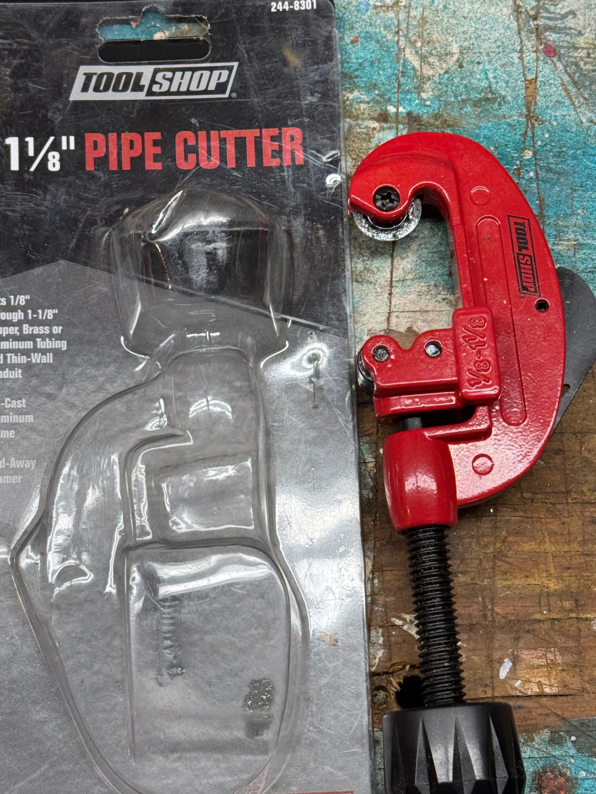

I tried using my pipe cutter and it worked great. Deburred with a Dremel. Nice.

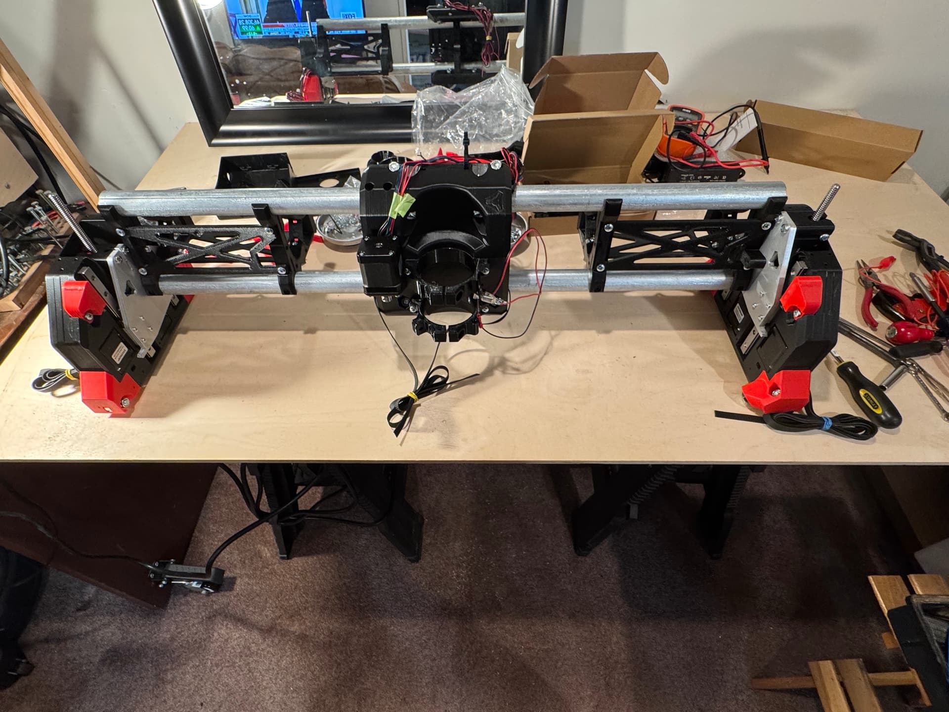

Started assembly the beam. Very cool.
My X strut is 30.625” Should use all 7 struts since I have them?
Using the cool strut generator it suggest 5 but I have all 7?
I’m thinking two extra should’t hurt?

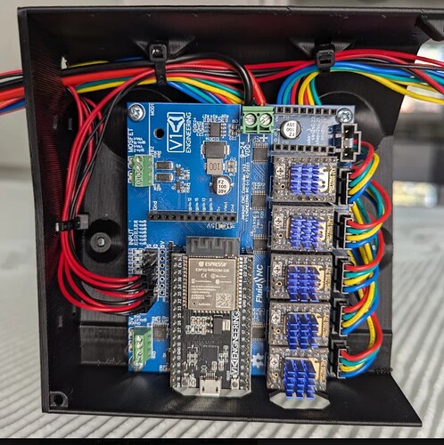

If you add too many, the control board will not fit between them.
And once you hot a certain point they don’t really add anything to the structure. The X rails are very rigid so there is extremely little flex between the braces on the rails as suggested. You might be able to add one extra but you will need to measure to see if your board box fits in the gap.

I bought this super cheap ($8) pipe cutter did nice work cutting the conduit. I then deburred with a Dremel.

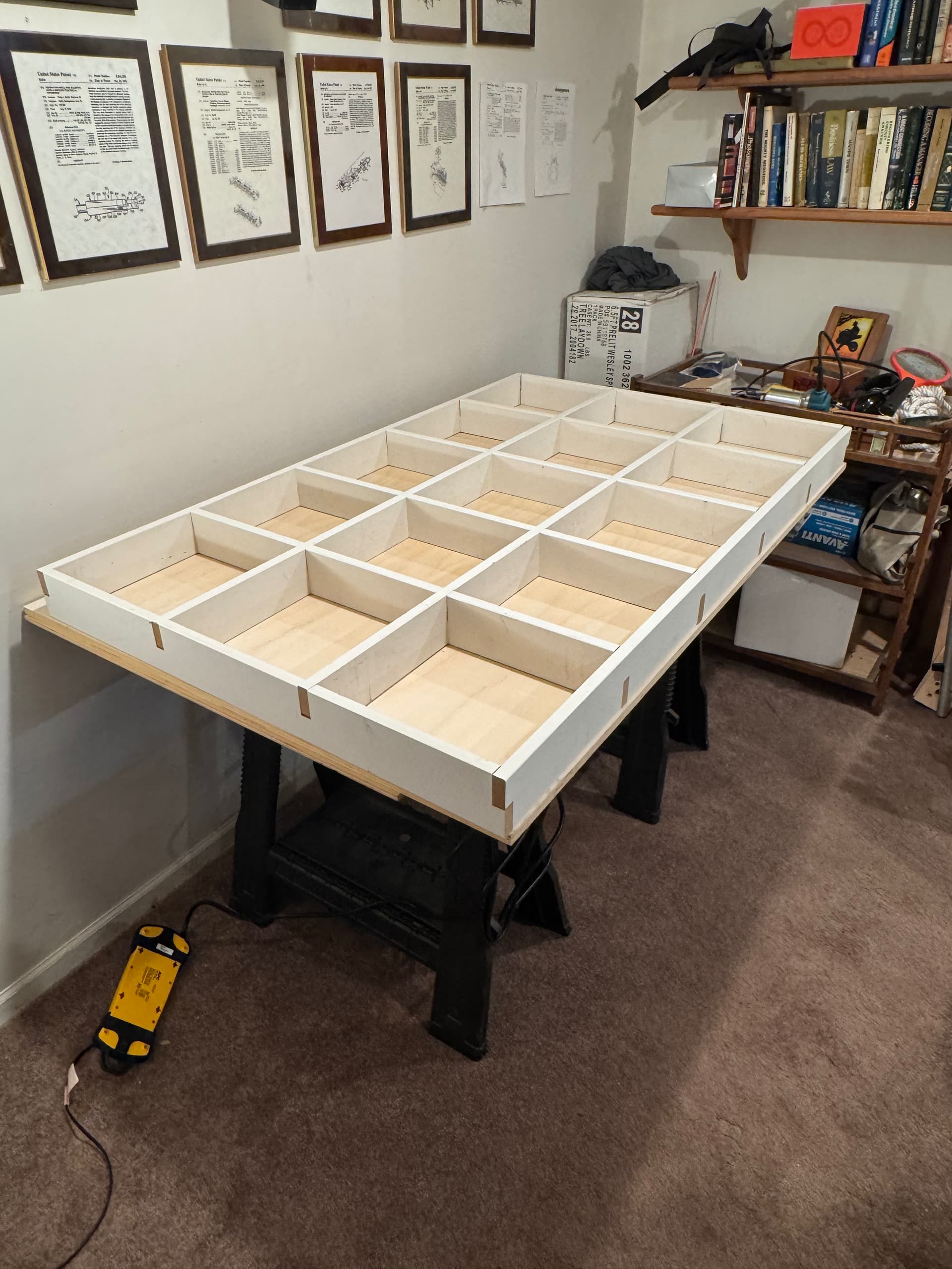

Ready to wire everything up to my Jackpot controller and route all of the wires. Realized my temporary table top was just a tad too narrow so decided to make a proper torsion box table.
Partly because I am getting nervous with the next steps and am more comfortable on the woodworking side :zany_face: Kind of joking, kind of not.

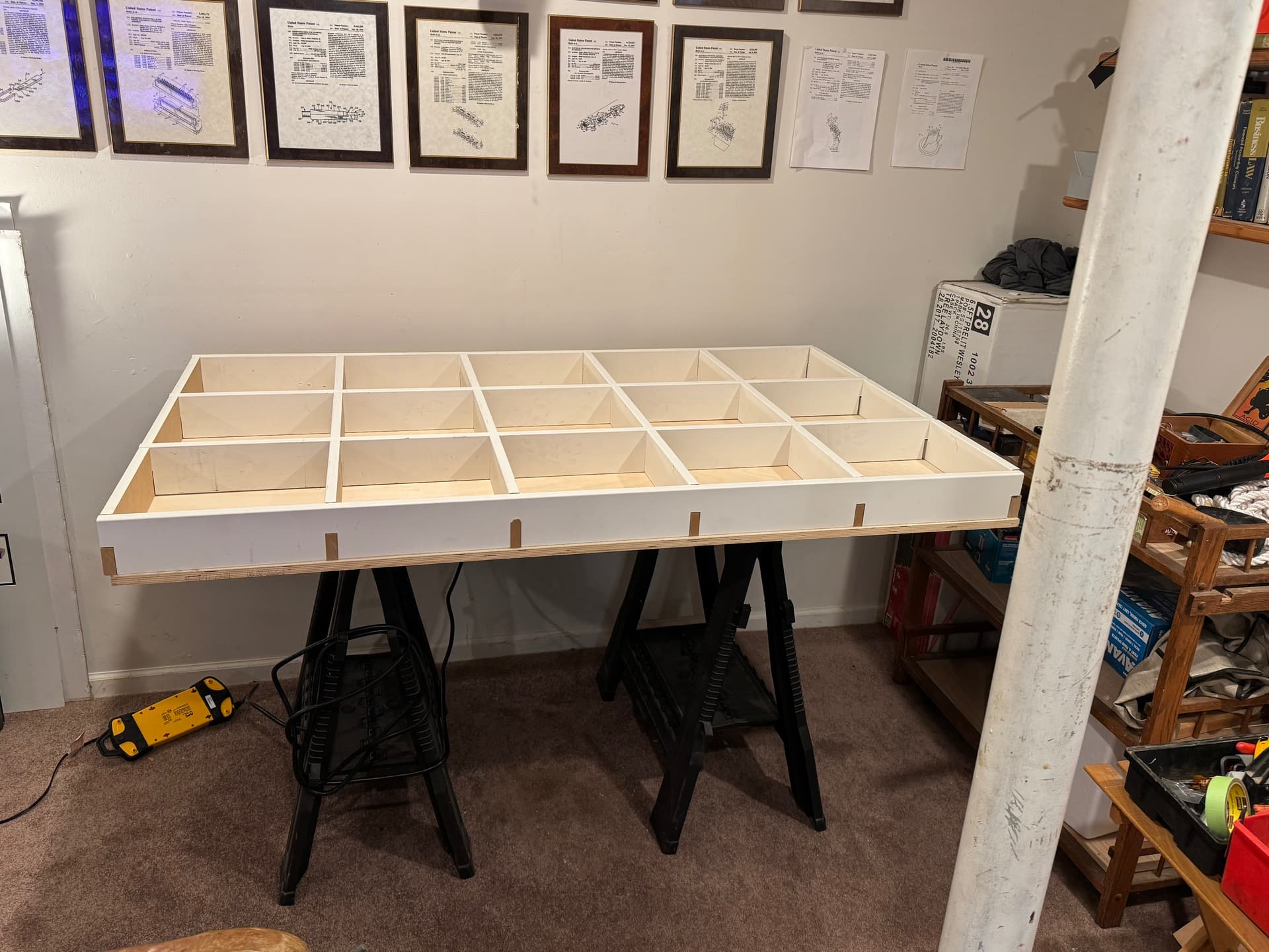

My build for LR4 will be 2’ x 4’ so my table is 60” x 37”. I just decided to use Fusion for the parametric modeling (again to delay actually finishing my build). I used the primed MDF 1x 4 trim. Good solution and pretty cheap. I am doing the top and bottom with baltic birch.

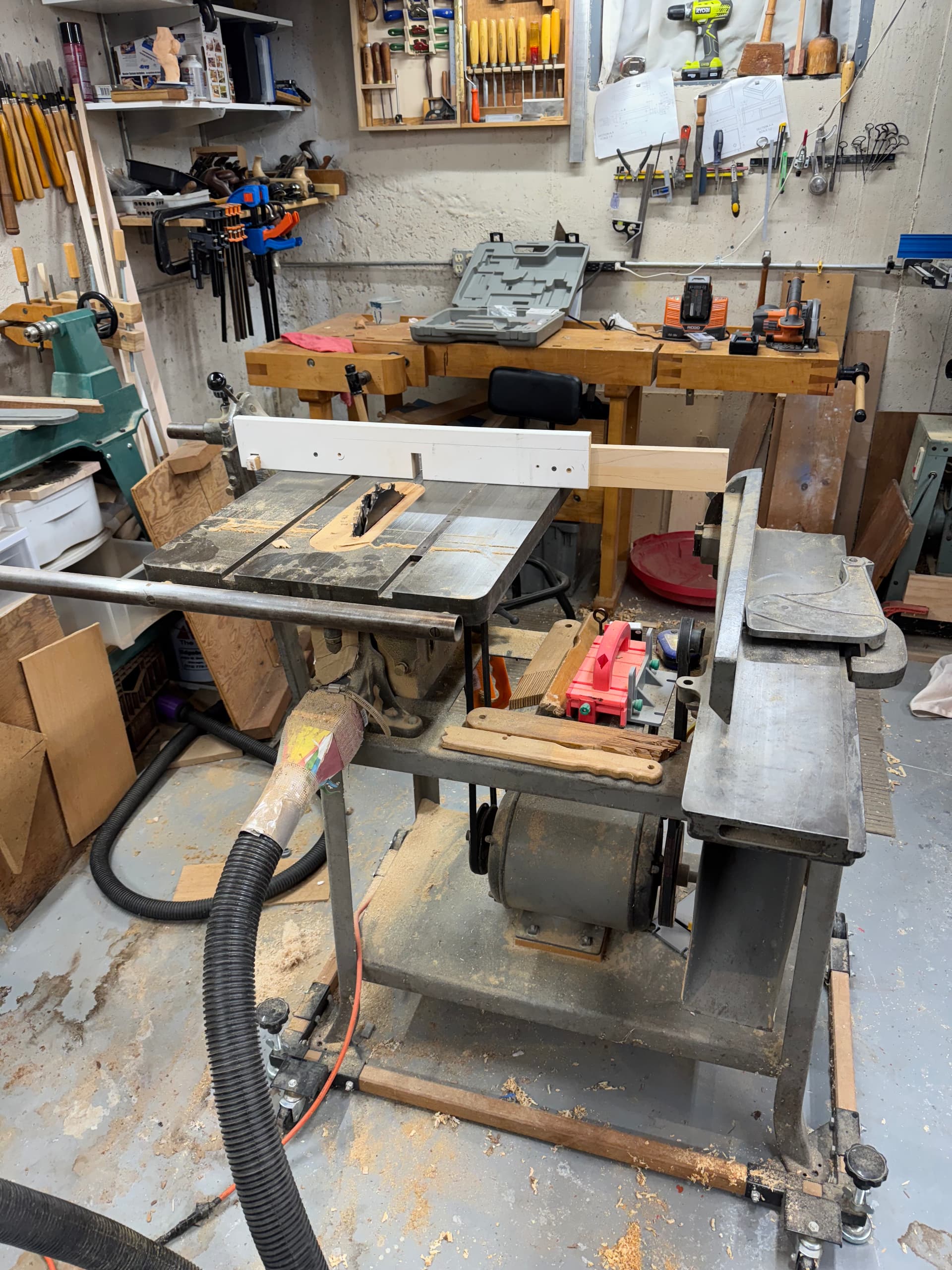

This is my beloved Delta 10” table saw 6” jointer combo I bought for a $100 at family department store I worked at (Oak Park Illinois) that went under. That was 40 years ago when I was 16. It is a 1941 year vintage Delta and notice the table tilts not the arbor! But served me so well. Original motor 84 years old!!

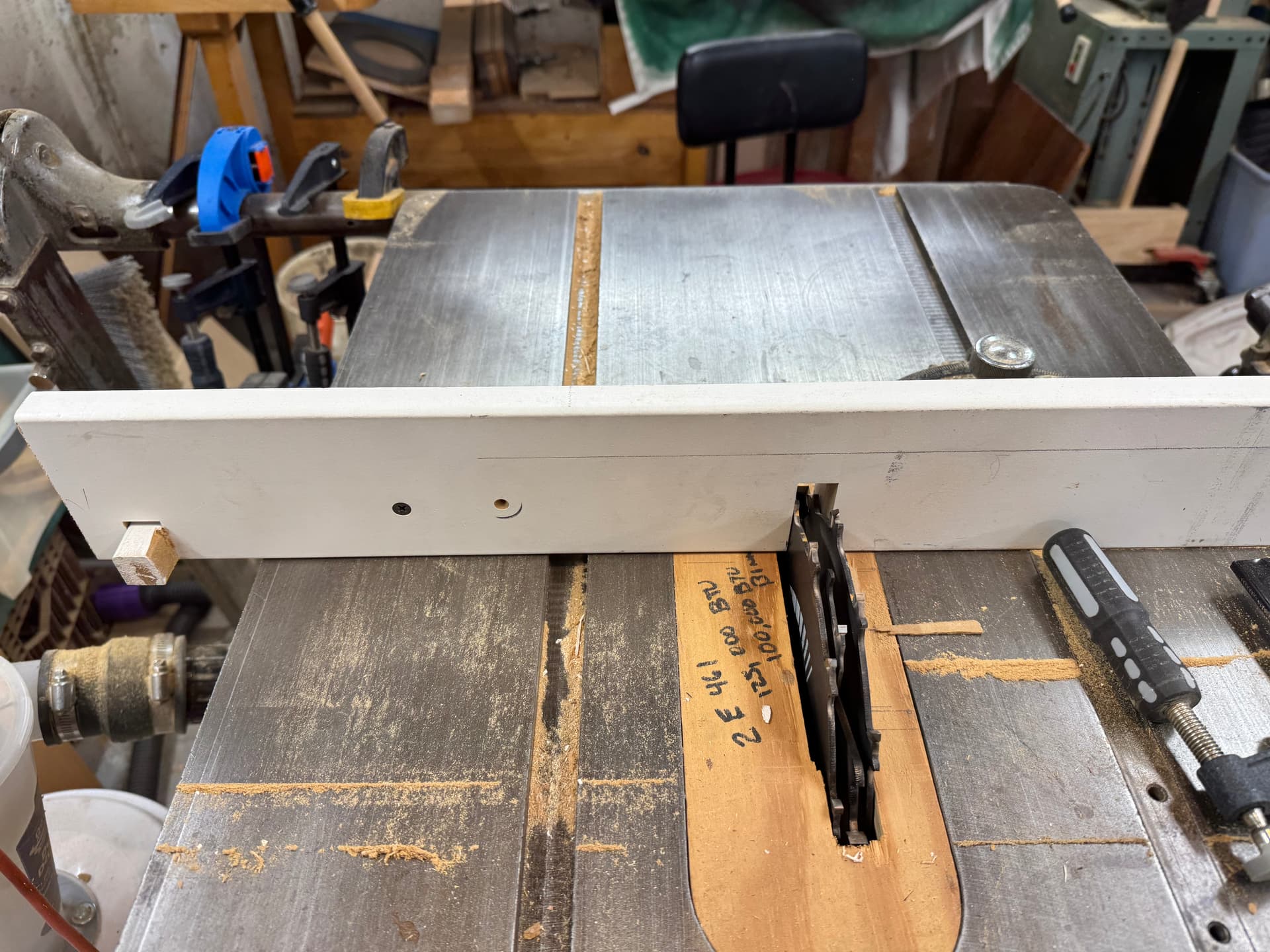

Was able to cut the dado notches once I sized the fit. Went with 12” grid. Made a nice overlap snug fit.
t

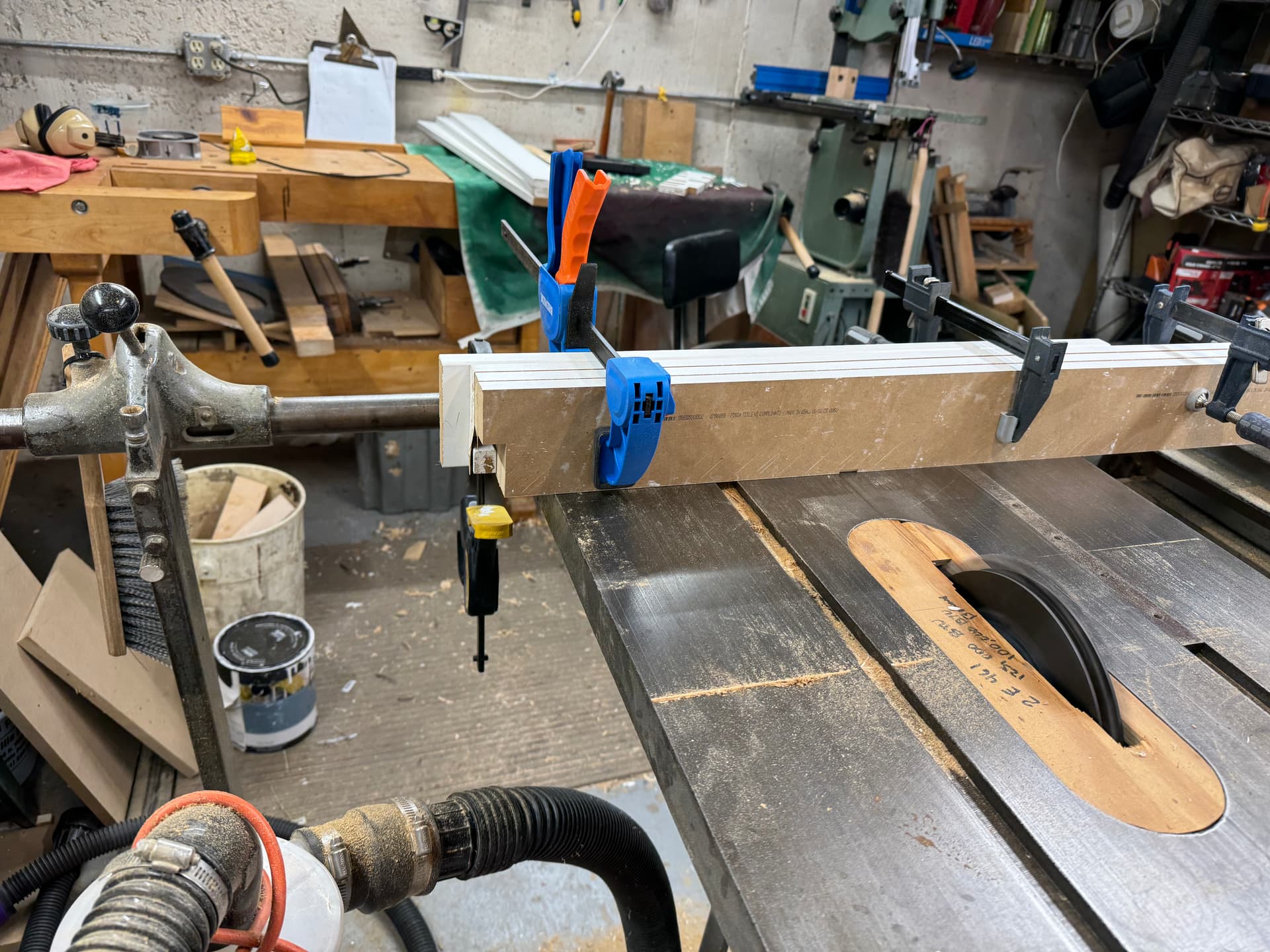

Turned out nice and even. I was going to glue the 15mm (5/8) Baltic birch top but too heavy and overkill. I will just shoot 16 ga. finishing nails in. The bottom I have some 3/16 particle board or what ever they call it.
I was going to mount some the same 1 x 4 MDF onto the top as runners. And then get back to the rest of the build.

Dado on an old saw that’s not made for it: :white_check_mark:
No riving knife (which, to be fair, does not work with the Dado stack): :white_check_mark:
No dust hood: :white_check_mark:
Osha’d like a word with you. :smiley:

It was made for a dado set. Even came with “shaping” bits. Scary spinning shaped profiles. Before routers. Cove bits, Roman Ogee, etc. Scary.
But this was before riving and a tilting table does not allow it. I did modify to add but only at 90 º
I do have a great cyclone vacuum system. Actually works.
Bigger issue no guard. But I grew up on the school I love to see the horrible blades. Some felt guards let to false security.

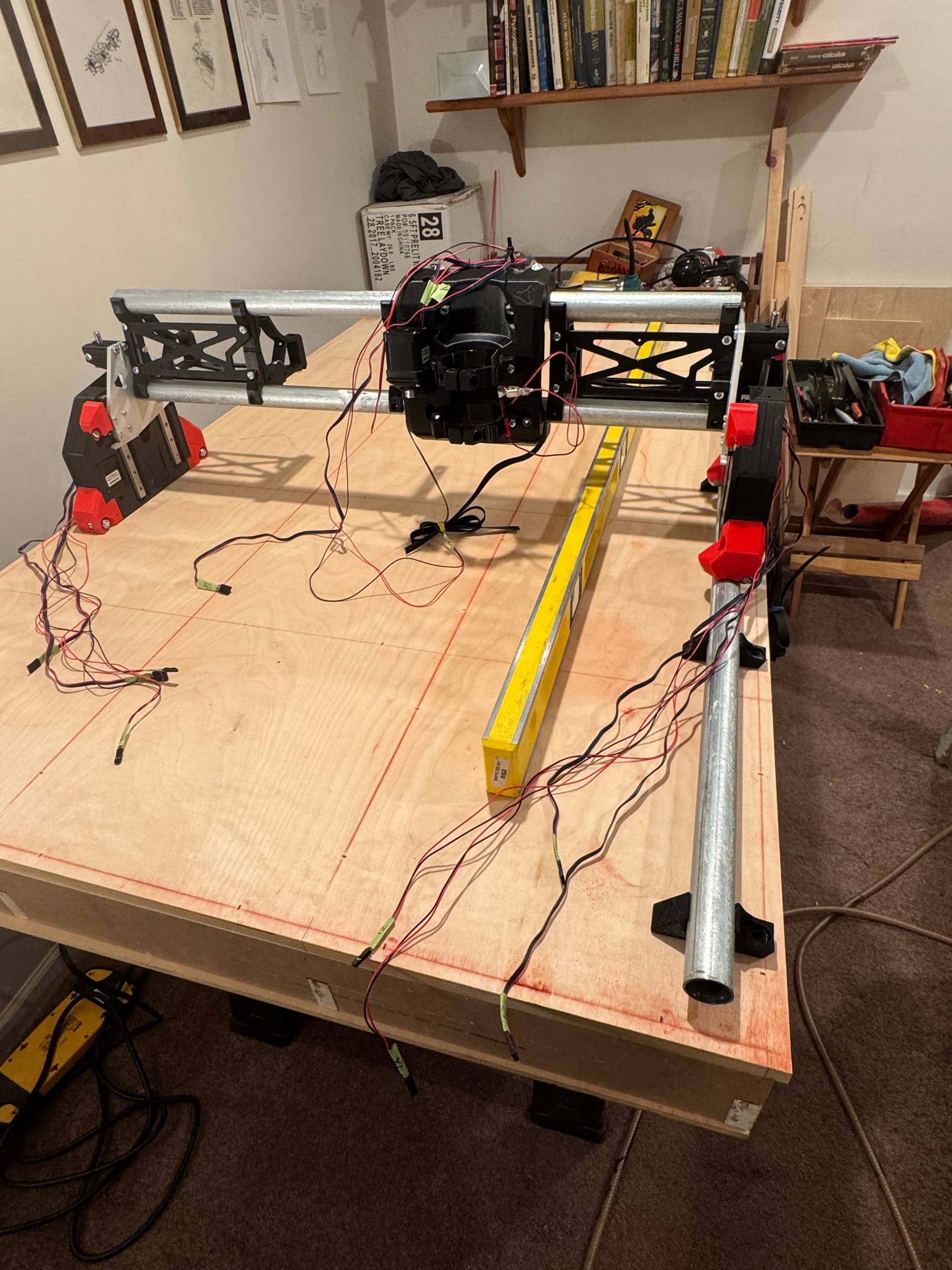

Top all complete it is time to start the wiring process. I am just amazed at this design!
First time I can imagine the full travel a surprised how smooth considering it EMT conduit.
I do want to use the locktite on all the grubs first.

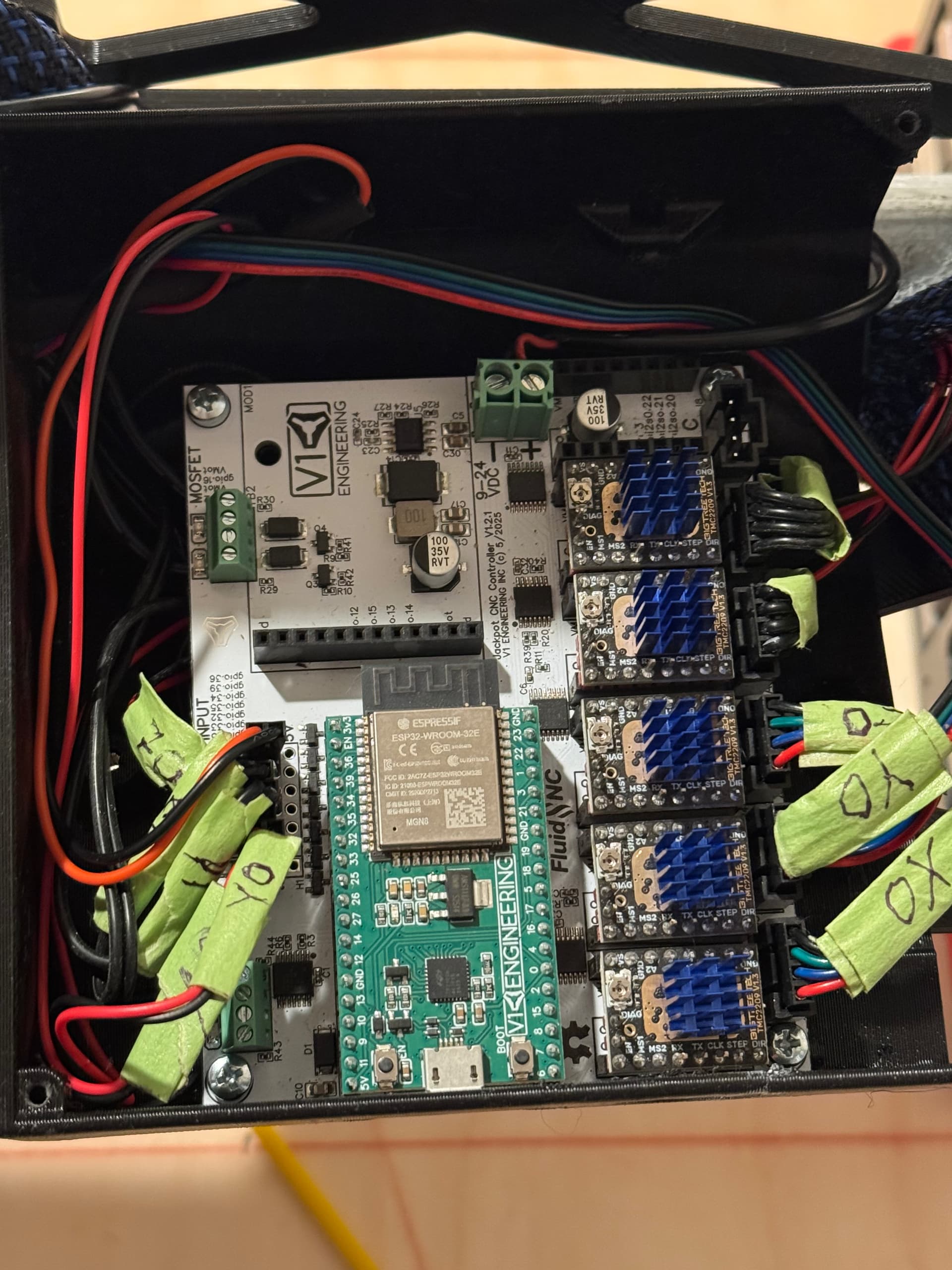

I finished my grub screw Locktite and did all of my primary wiring.

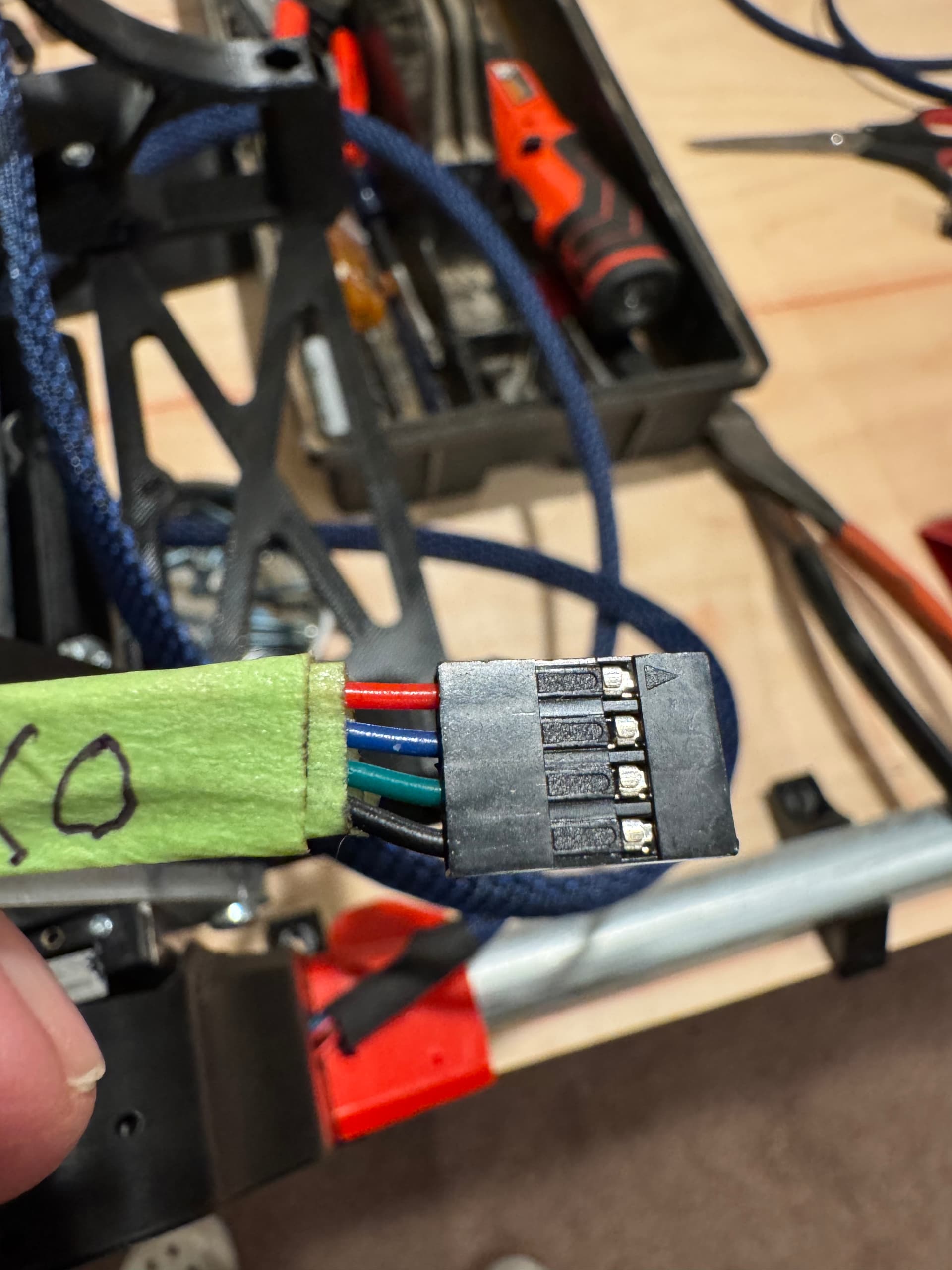

I am embarrassed to say as a retired connector engineer I failed to pay attention to the circuit one identifier on the Molex SL/DuPoint stepper motors. And of course put the braided cover over it all then I realized my mistake and took apart.
The little circuit one identifier arrow. It now matches up with Ryan’s nice extensions. Of course I did it backwards as I forgot about the polarizing circuit one identifier. :sleepy_face:

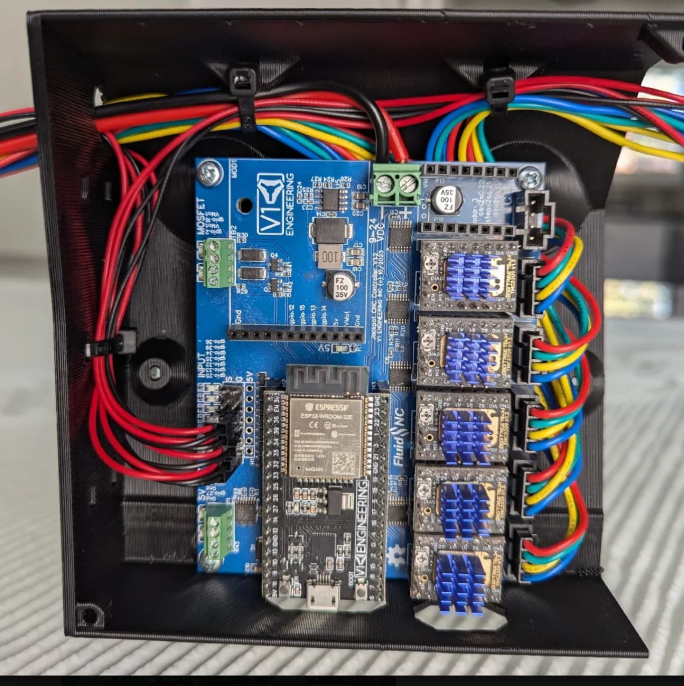

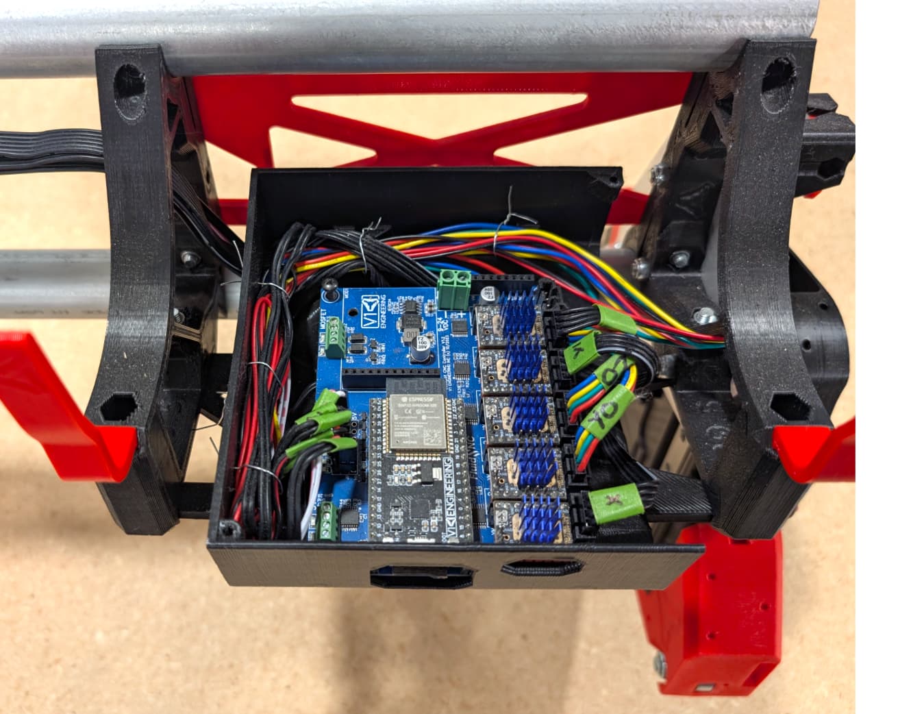

I am confused about how the stepper motor connectors plug into the Jackpot Board. I assumed I missed that part. I did not run my belts yet so maybe it comes later.
This shows the RED away from the I/O and first position BLUE
While this one shows the opposite? These are both screenshots from V1E.
So I am not sure? Also I assume since the microswitches as well as the touch plate are basically plain open/close switches polarity does not matter even though I put the RED in along the edge.
This is how I wired mine. BTW which version of the Jackpot board is this? Does it matter?
Notice the position of the RED and the the extensions follow the same polarity.
Thanks!!
Craig
The direction doesn’t matter, and the wires colors can vary per stepper. Once you try to move the machine if they move the wrong way all you have to do is power down completely, flip the plug over, power up and the stepper will move the other way. Easy
