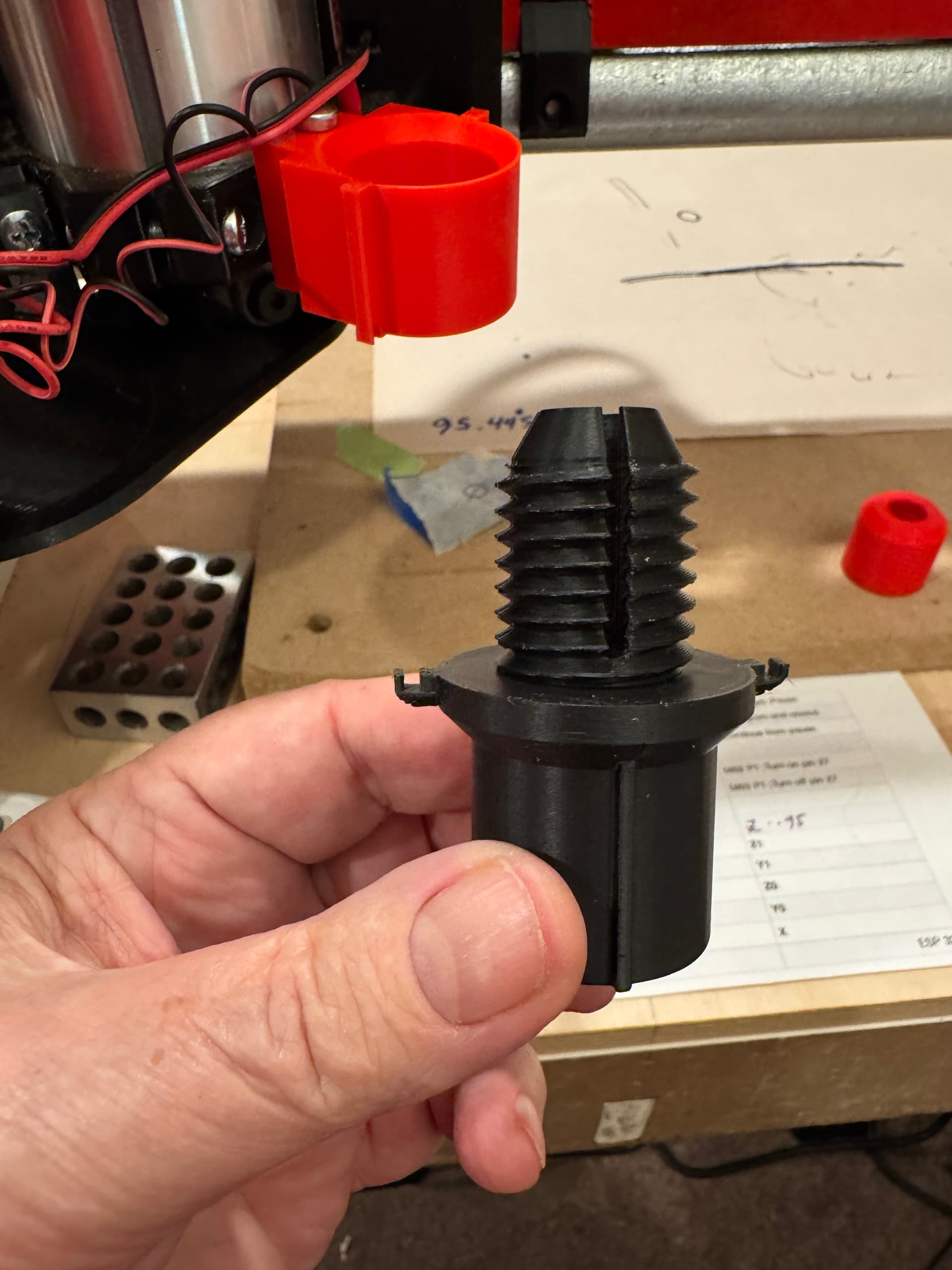

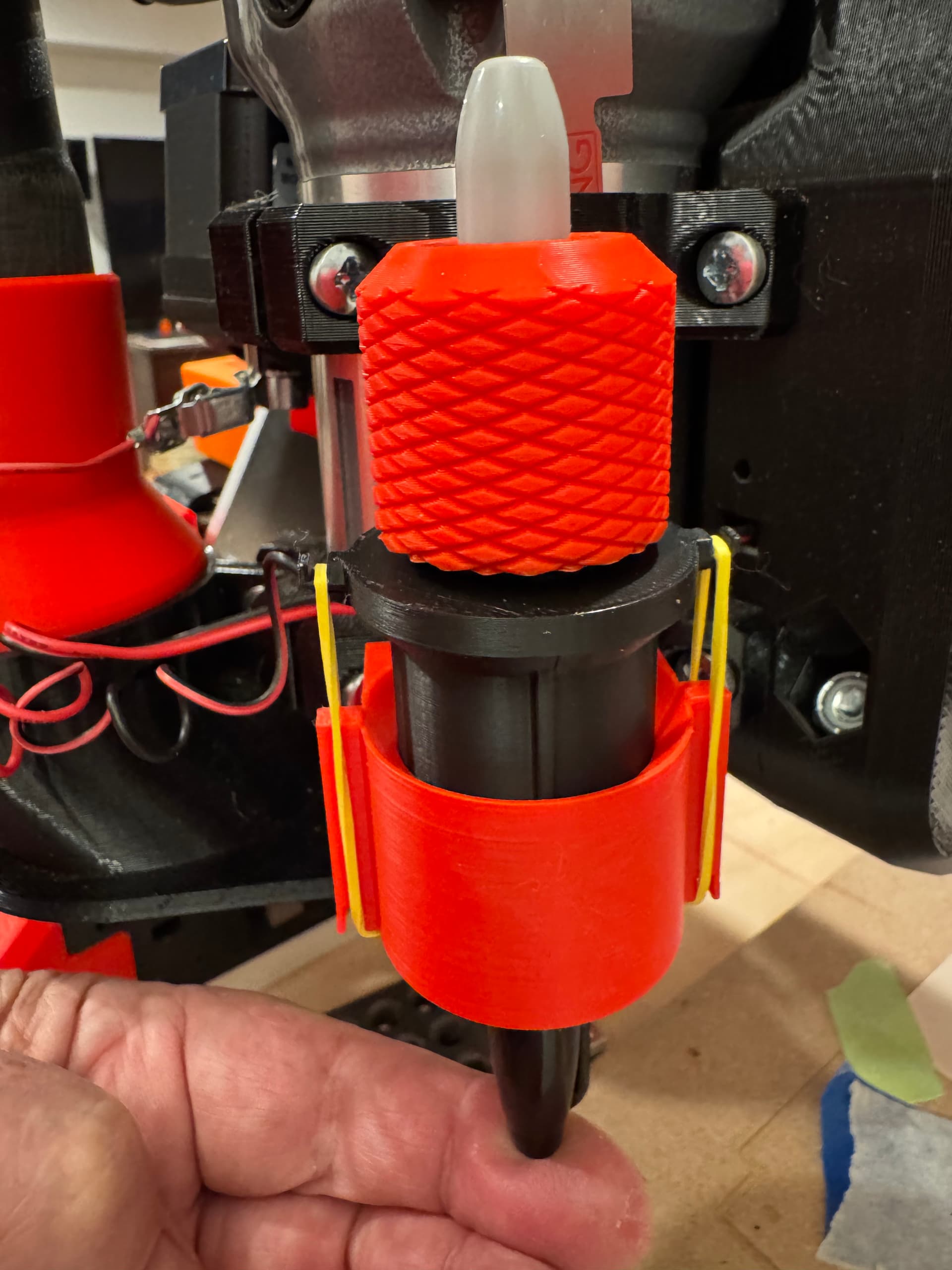

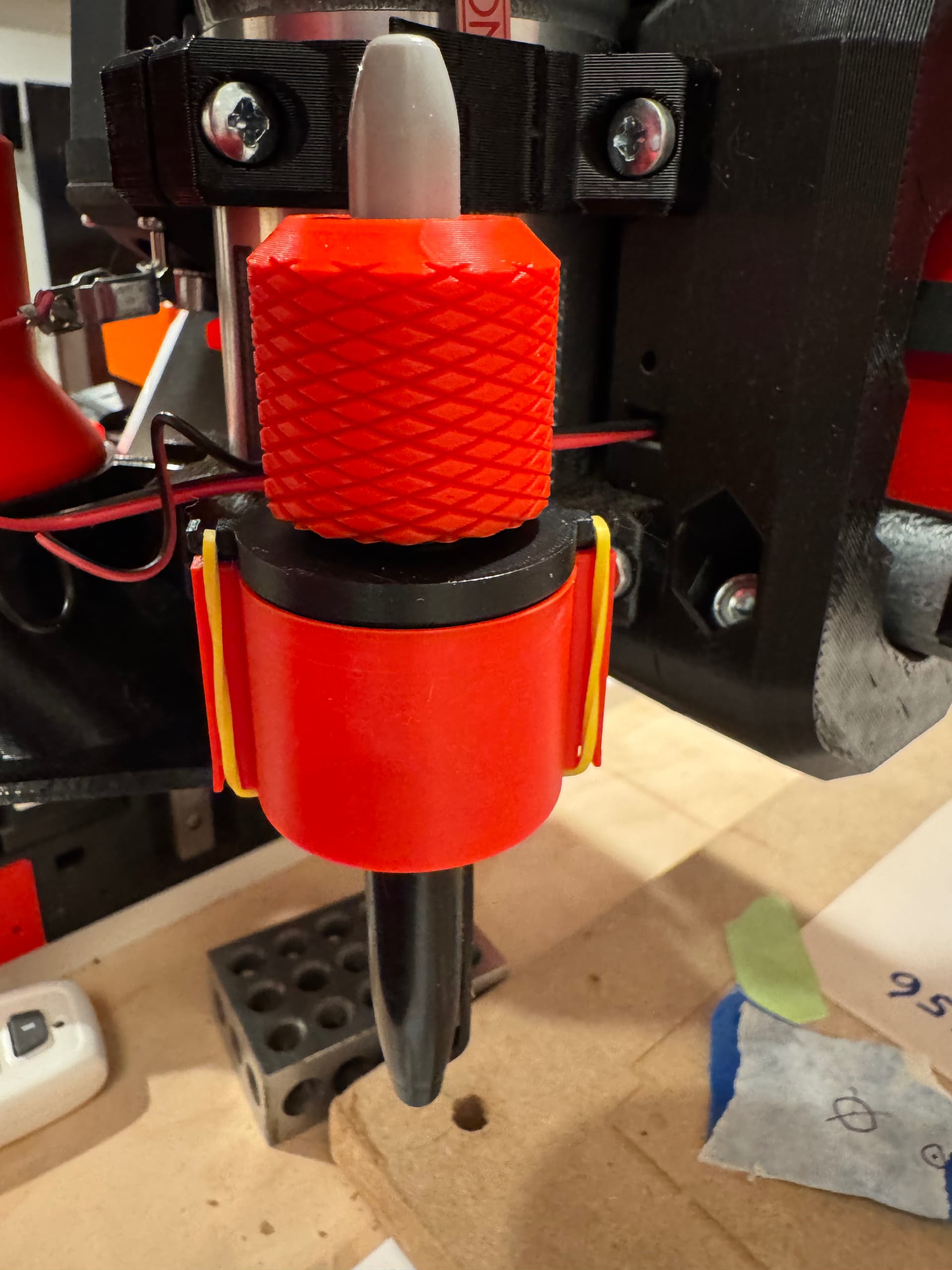

I decided to design a universal penholder that I could use rubber bands for the flexible “give” and also mount to the handy provided hole on my Makita mount. Happy to say it turned out nice. Had fun showing off at Thanksgiving :joy:

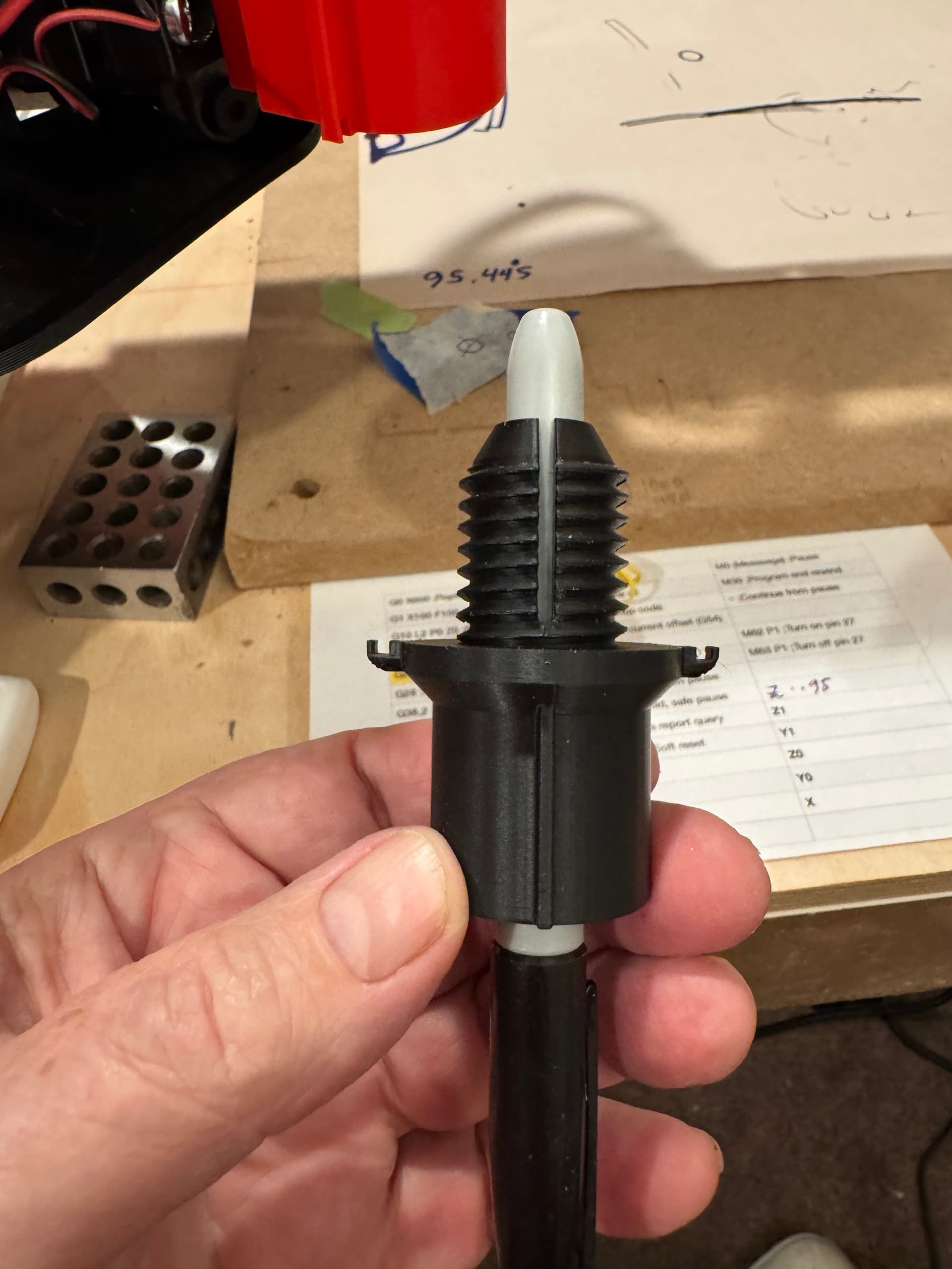

I used a split collet to hold the Sharpy. And the rubber band of your choice.
