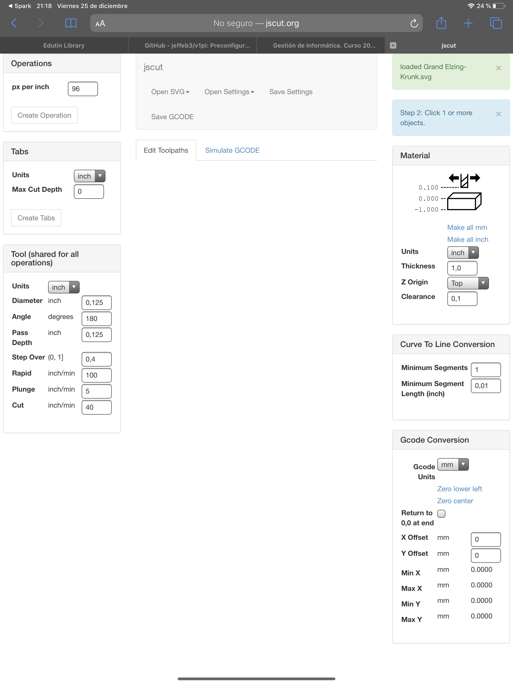

What about jscut.org? Never looked into it, but it might be of use?

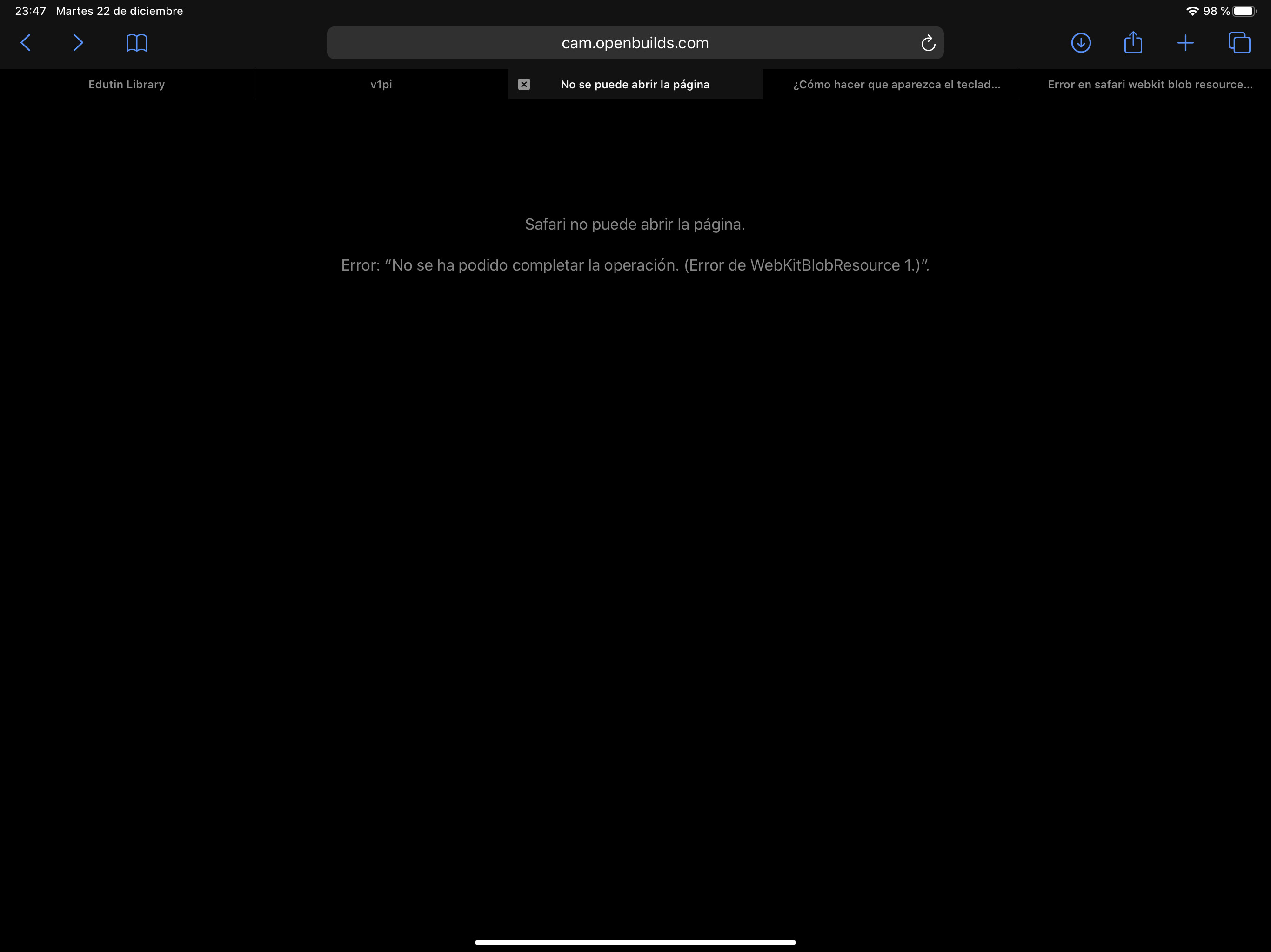

Finally I find the way. Create with shaper3d, saving to svg, editing online with openbuilds cam, generating gcode. Next I have to test with any sender or octoprint, or something
