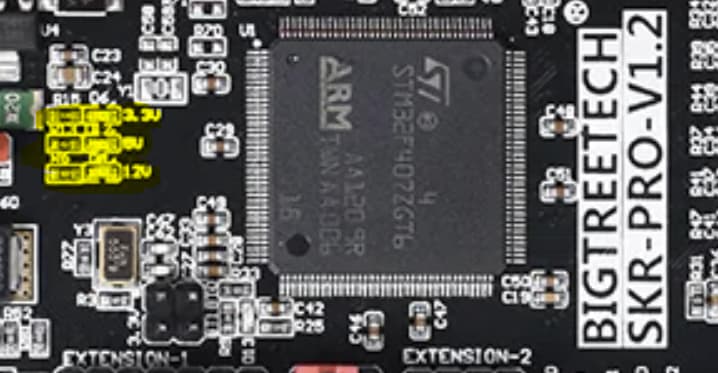

Mpcnc with skr board, built in the last month. LCD has been removed and I am directly plugged into my computer. Initial tests (with LCD) worked fine except for some end stop issues that were fixed. Got as far as printing the crown with no problems. Tried to get dirty by milling a 10 inch square with an 8 inch hole. When I went to run the Gcode in repetier everything stopped moving. Now I can’t even use the manual mode in repetier to move any of the axis’s.
Used Bob’s cnc/cam to generate the gcode. When I loaded it into Repetier I got a m20-unrecognized error. Since then …….nothing. I tried reloading Repetier in case it was corrupted but it didn’t help. At this point I am at a loss on my next step. Firmware corrupted?
A few instances of a SKR Pro board losing the firmware, and sometimes the bootloader as well, have come across the forum, but I would not start there in troubleshooting your problem.
Start by verifying that your board has power for all three voltage systems (12V/24V, 5V, and 3.3V). I’ve highlighted the LEDs you want to examine in yellow in this image:
If the LEDs show power to all three systems, the next step is to attempt to send a command to the board. Assuming you are connecting to the board, use the Manual Control tab and G-Code edit field in Repetier-Host to send commands to your board. Try an M115 (firmware info) and see what you get back.
If you can connect and send info, but the board is still not responding, post back the exact info (or a screenshot) of what is reported by Repetier-Host.
All three LED’s are lit. I have also sent a m119 to the board and got a response. Shown below is the result of a m115. Still no movement when I try to use the Repetier controls.

This is beyond my understanding but I do notice that there seems to be several copies of the information. From multiple restarts?
I’m not sure why you got multiple responses. The piece I wanted to see is this:
15:15:47.597 : FIRMWARE_NAME:Marlin 515D 2.1.1 (Sep 25 2022 17:41:33) SOURCE_CODE_URL:github.com/MarlinFirmware/Marlin PROTOCOL_VERSION:1.0 MACHINE_TYPE:V1CNC 515D EXTRUDER_COUNT:0 UUID:cede2a2f-41a2-4748-9b12-c55c62f367ff
Based on this line, your board not only responded, but it verified that you have the right firmware on the board, so this is not a firmware issue. The next thing to check is the fuses. There are three fuses on the board. I’m not sure which fuse is for the motor rail, but I’d guess the blue one. I’d check both the blue and the red one visually, and if you don’t find anything, by multimeter.
If a fuse is blown, then you should look for the problem that blew the fuse before replacing it and firing up the board. My primary suspect would be a short in the stepper motor wiring.
