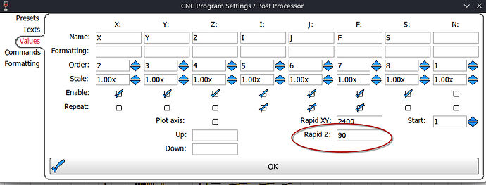

Is the Rapid Z setting where Estlcam switches from Fz to final distance? Is that what I should be editing instead of Fz?
The window where you program your controller has those settings.
I’m using the FluidNC controller that’s defaulted on the Jackpot board - I’m away from my machine at present but it’s the Z number that can be changed during jogs.
I tried changing that as well, and even at high Z speeds set either there or in Estlcam, there’s still a few seconds after a plunge where the pen sits in contact with the paper and causes plunging. Unfortunately nothing changed even at REALLY high speeds. It almost seems like there’s some kind of pause or halt when it waits for a cue to start. This sort of thing isn’t a problem if it’s a router waiting to move, or a laser not yet powered on, but it’s almost an instant disqualifier for paint pens.

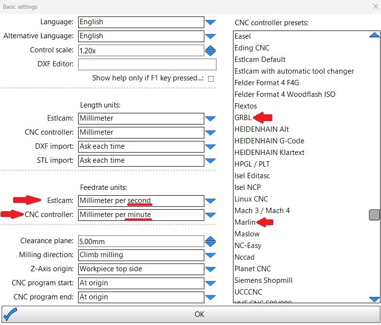

Yikes, that’s slow indeed. I’ve got Fz set at 10 mm/sec, should I boost it to some drastically higher speed or is that 10 mm/min speed coming from somewhere else?
I think you have an Estlcam config item set wrong. You’re not moving at 400mm/s. That’s 24000 mm/min. You’re moving at 400 mm/s.
From the docs, you need to set CNC controller feedrate units to mm/min.
Be careful with that 400 mm/s when you make the change @jeyeager posted. Its going to move REAL fast now :rofl:
Can confirm it moves REAL fast indeed. Changing to mm/min did the trick - I have no clue why I put it to mm/sec, but it comes rapidly off the paper. My only current issues deal elsewhere with the MPCNC - thank you all so very much for your help!
