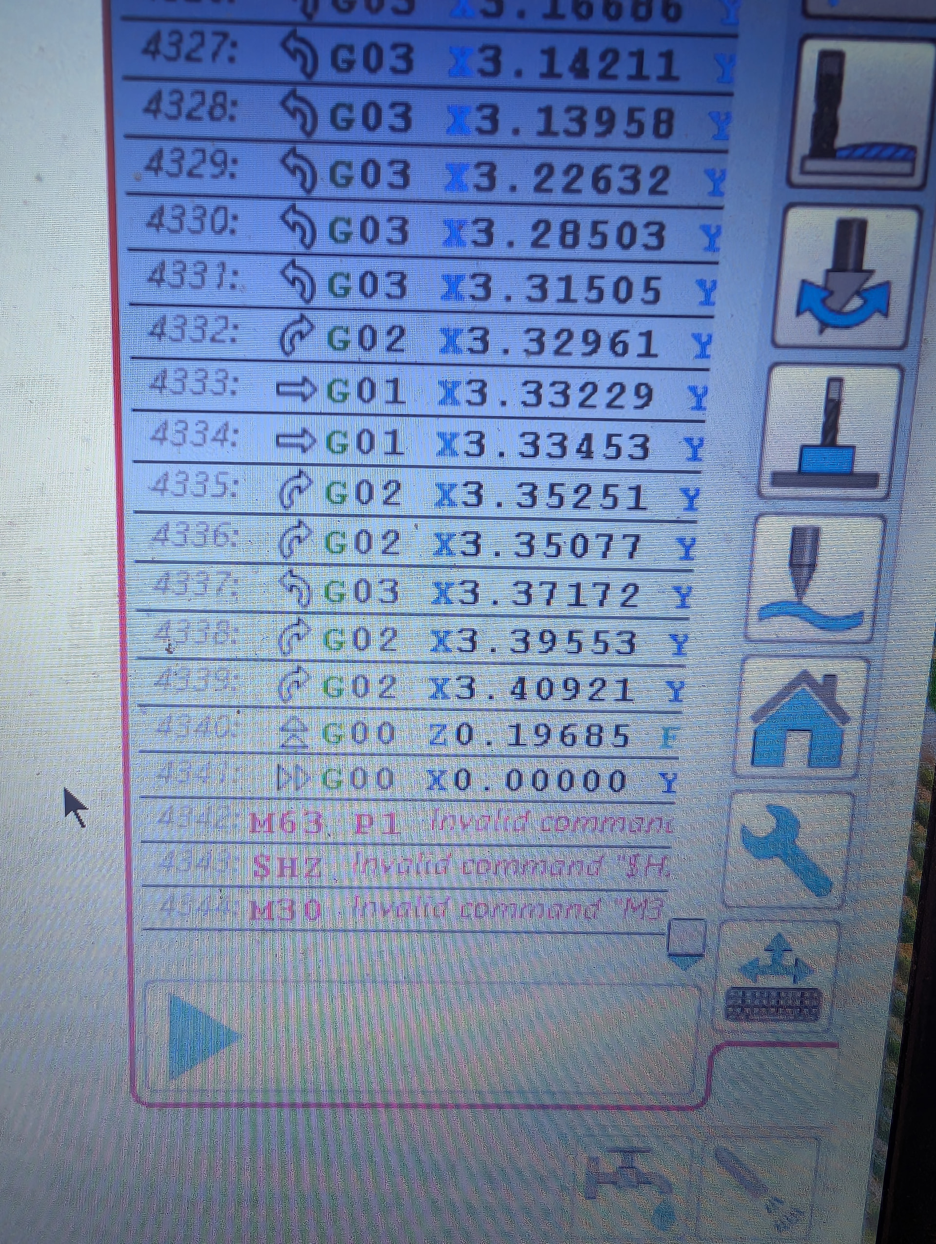

CribbageBoard.nc (77.6 KB) the end commands are incorrect M63 P1 (stop spindle pin27)
$HZ
M30 this is what i coppied from v1e milling basics these commands dont work can someone help me correct this

This is the ending gcode in your file.
$1
M30
That $1 shouldn’t be there. There should be a $HZ (home Z) instead.
At the end of the program it hones then starts over
This is the code at the end of the cut but instead of ending it starts over

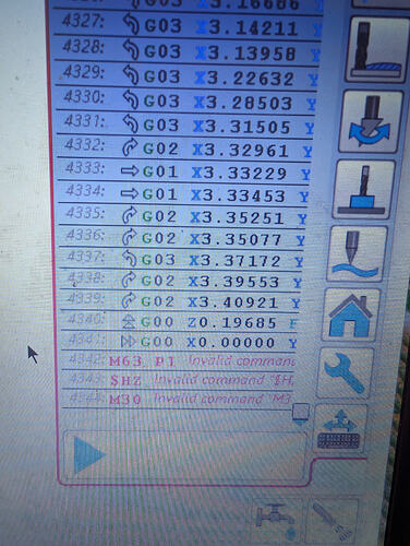

From that screenshot, it looks like you were looking at the gcode in Estlcam. We don’t use the controller part of Estlcam with a Jackpot and Estlcam doesn’t support running that gcode.
I kept copying over the program so the cut just kept repeating.i just used the estlcam controller to show the code it just popped into my head that’s what was happening the next cut worked fine
