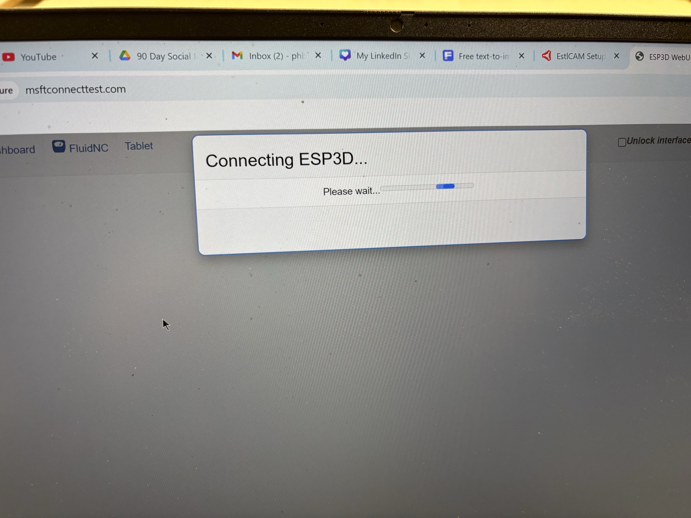

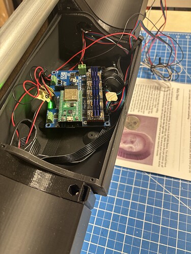

Attempted to upload this newer file and it never did. Failed to upload or just nothing. And now for good measure the ESP32 keeps dropping like it did when I had wires all over the place although that has since been dealt with.
So now laptop doesn’t want to connect to fluidnc . Had to disconnect power and then power back on before it would allow laptop to connect to fluidnc. Once connected I attempted o upload gcode file from hard drive and it failed yet again.

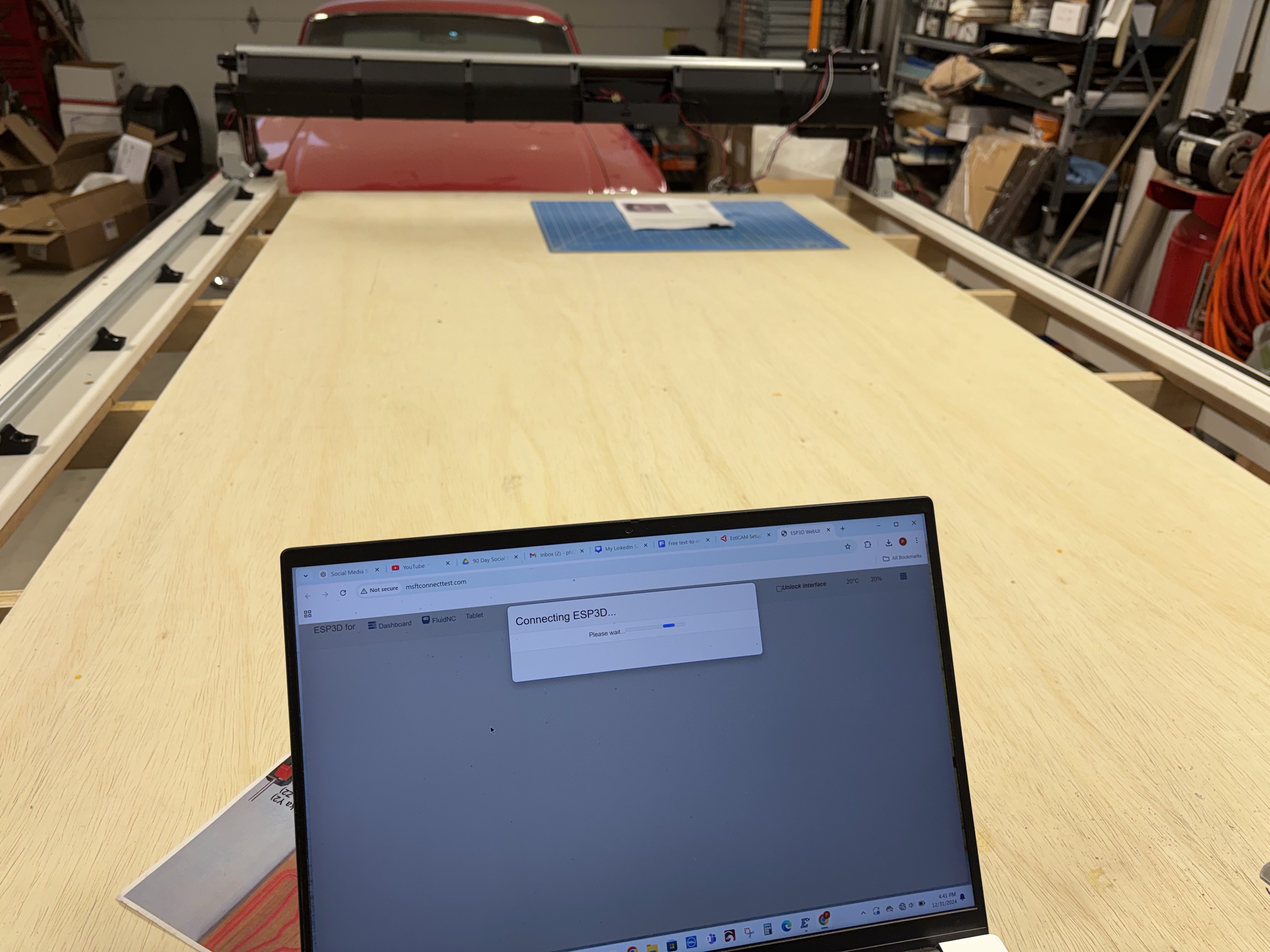

Here are some pics to help explain my mess
Wires away from antenna

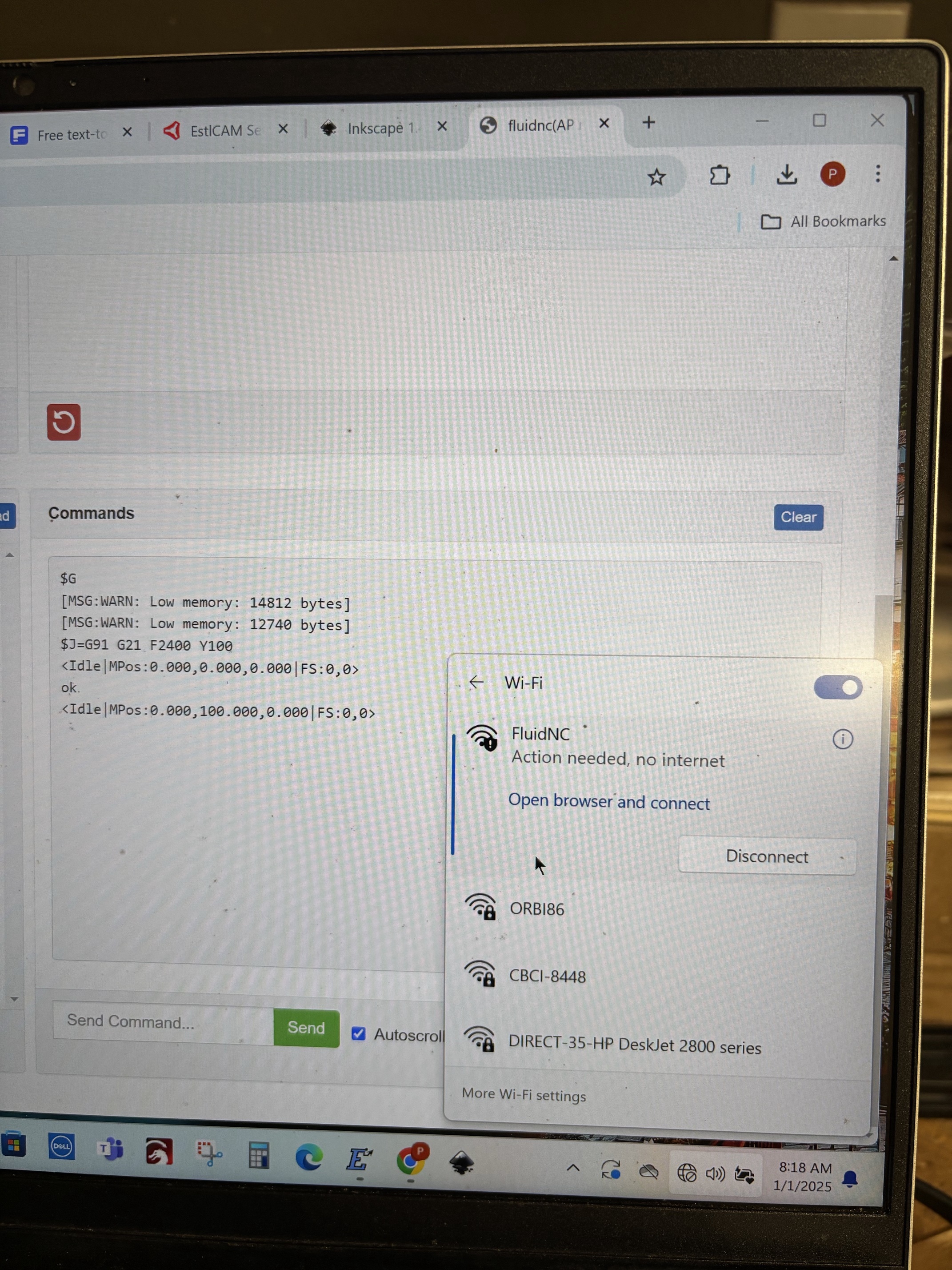

Laptop not far away from ESP32 but it tries and tries

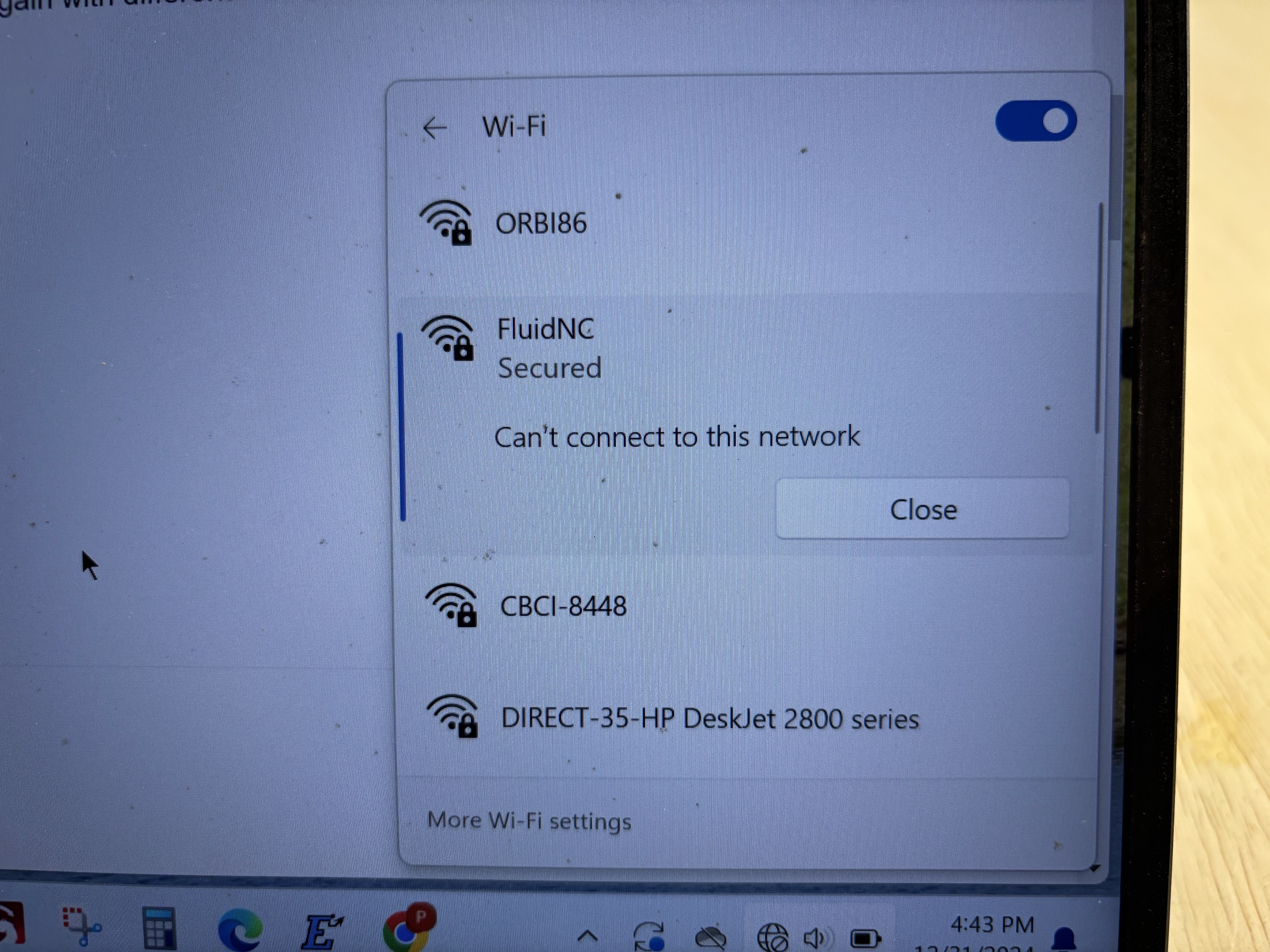

Now won’t connect. When it did connect, got an error when attempting to upload file to sdcard - failed to upload.
Any insight?

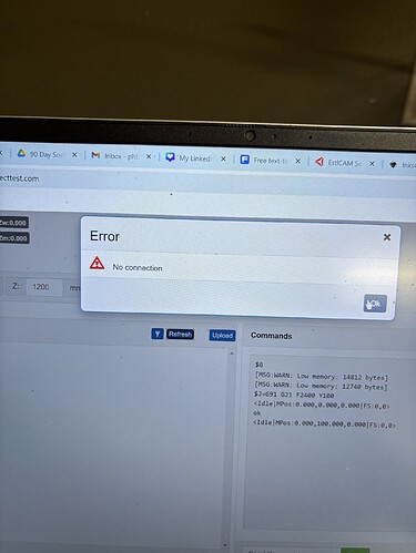

For your wifi issues - you have lots of other tabs open there that will be trying to reconnect so your laptop is possibly detecting your fluidnc as not being online and changing back to your home wifi. You can untick ‘connect automatically’ in the short term. You can also join your lowrider to your home WiFi as a client - this uses less processing and memory resources than being its own hotspot.

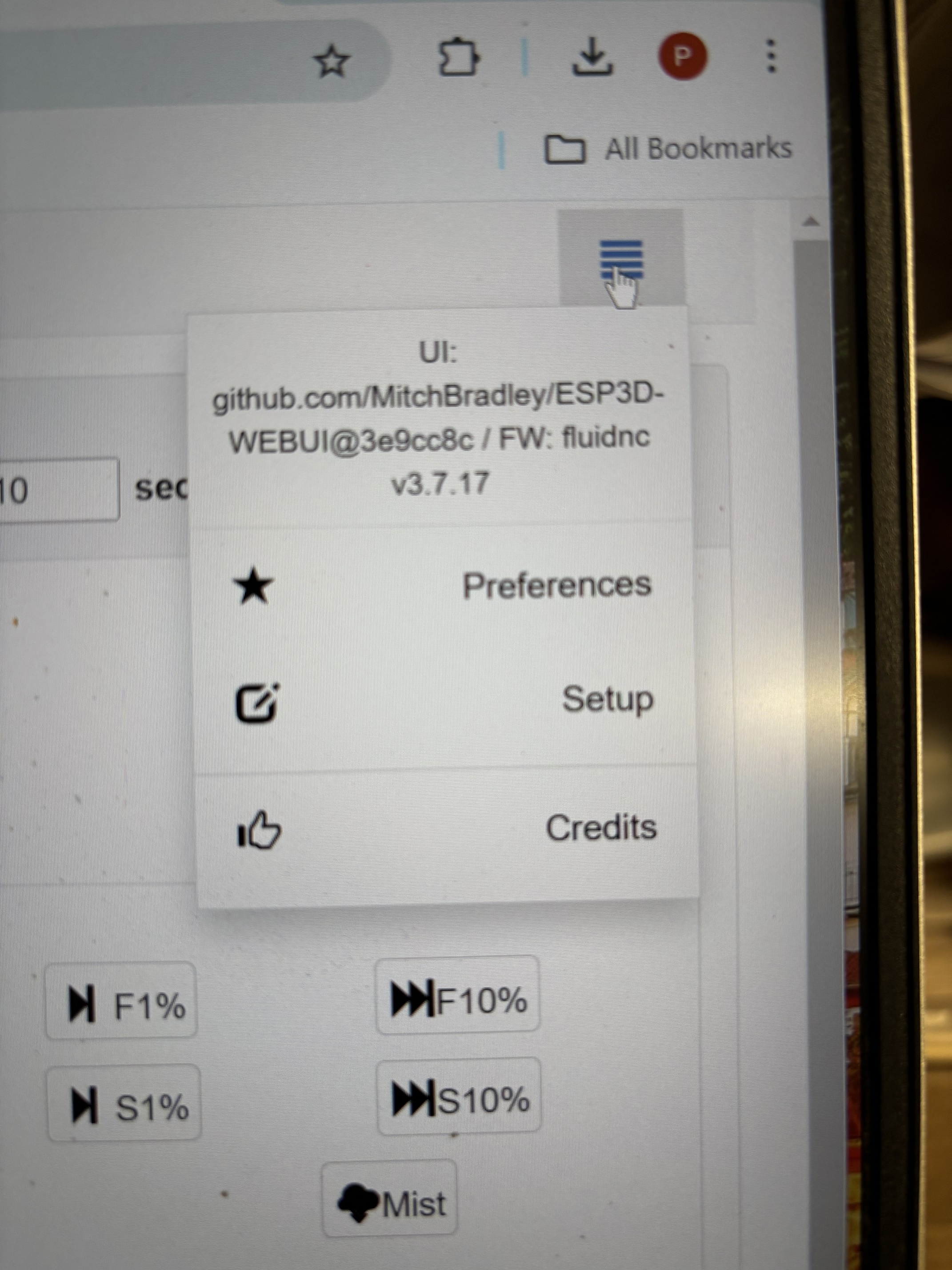

What version of fluidnc do you have? You can check using the hamburger menu in the top right. You’ll probably need to turn it off and on if connection is stuck.

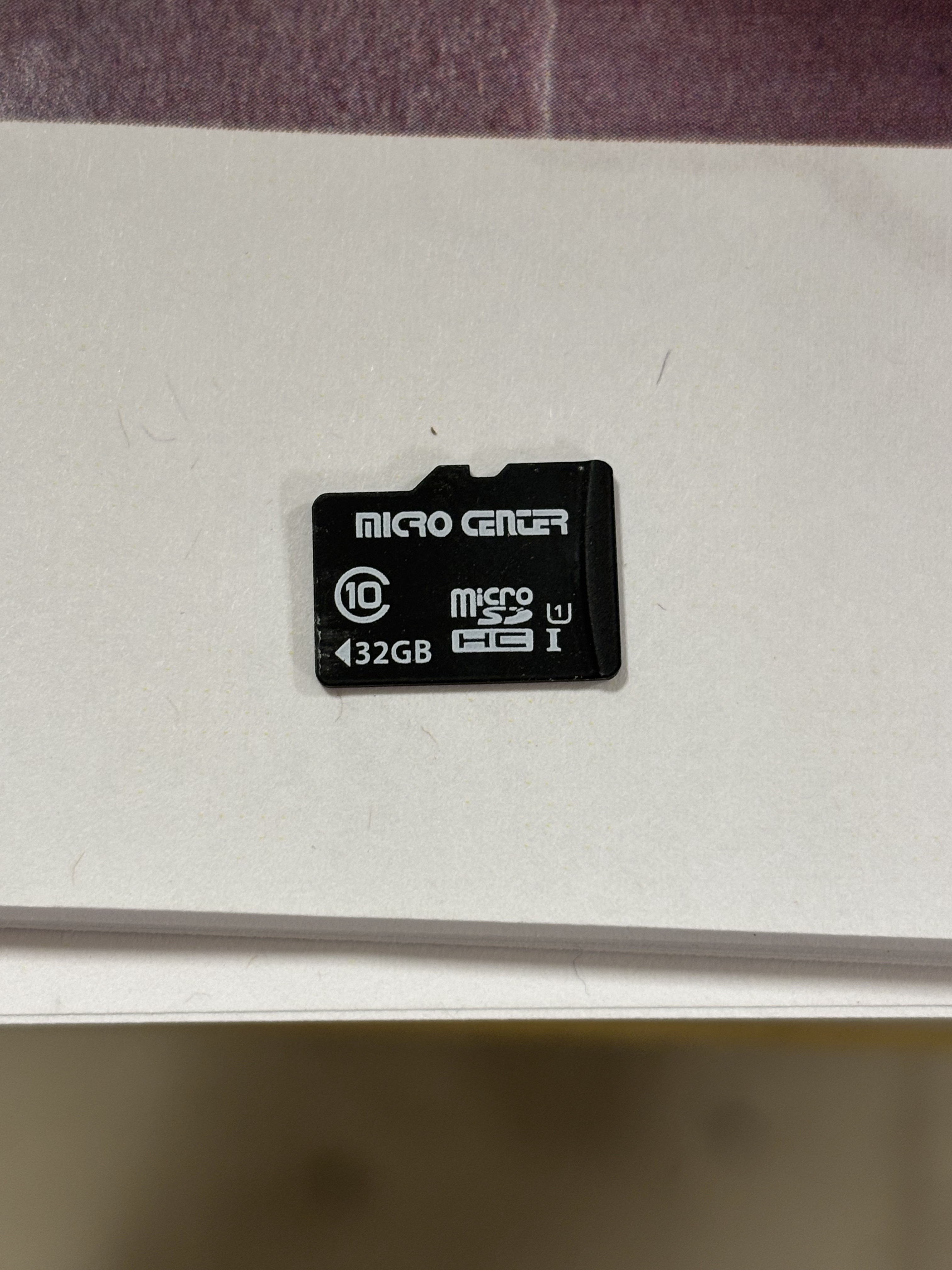

Can you take a picture of your SDCard? Not all classes of card are the same.
The last thing to try is connect to the board using its IP address instead of fluidnc.local

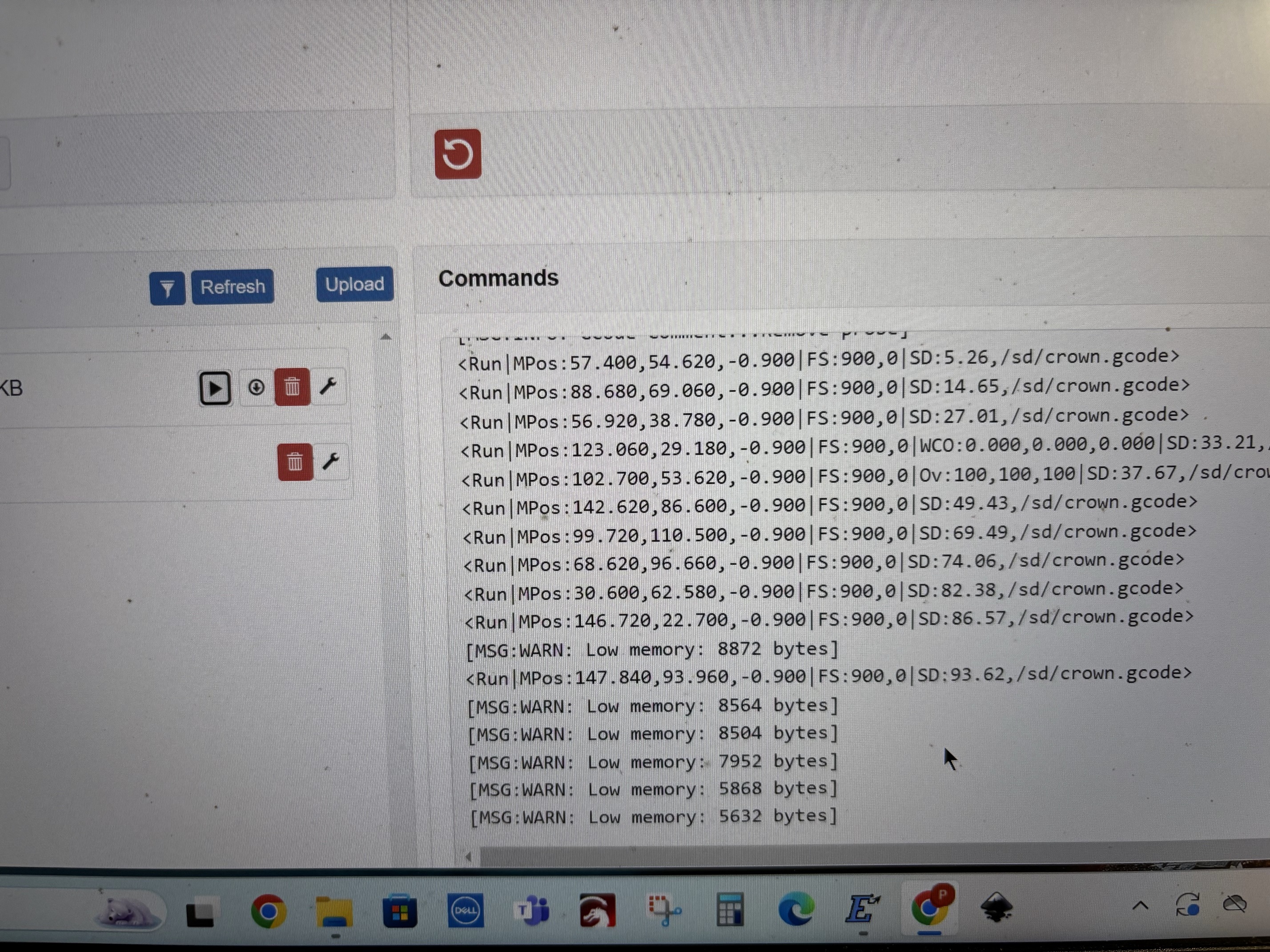

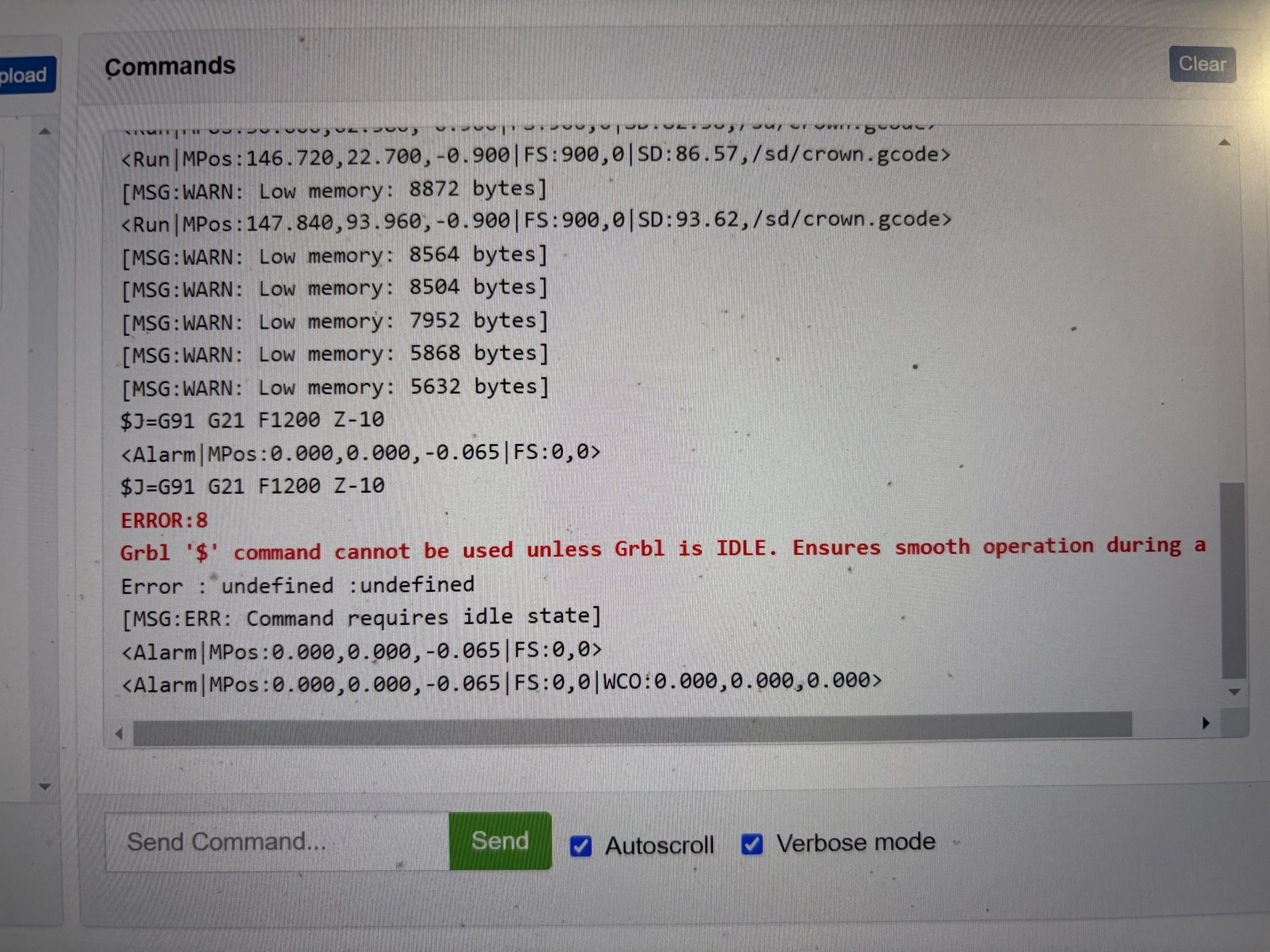

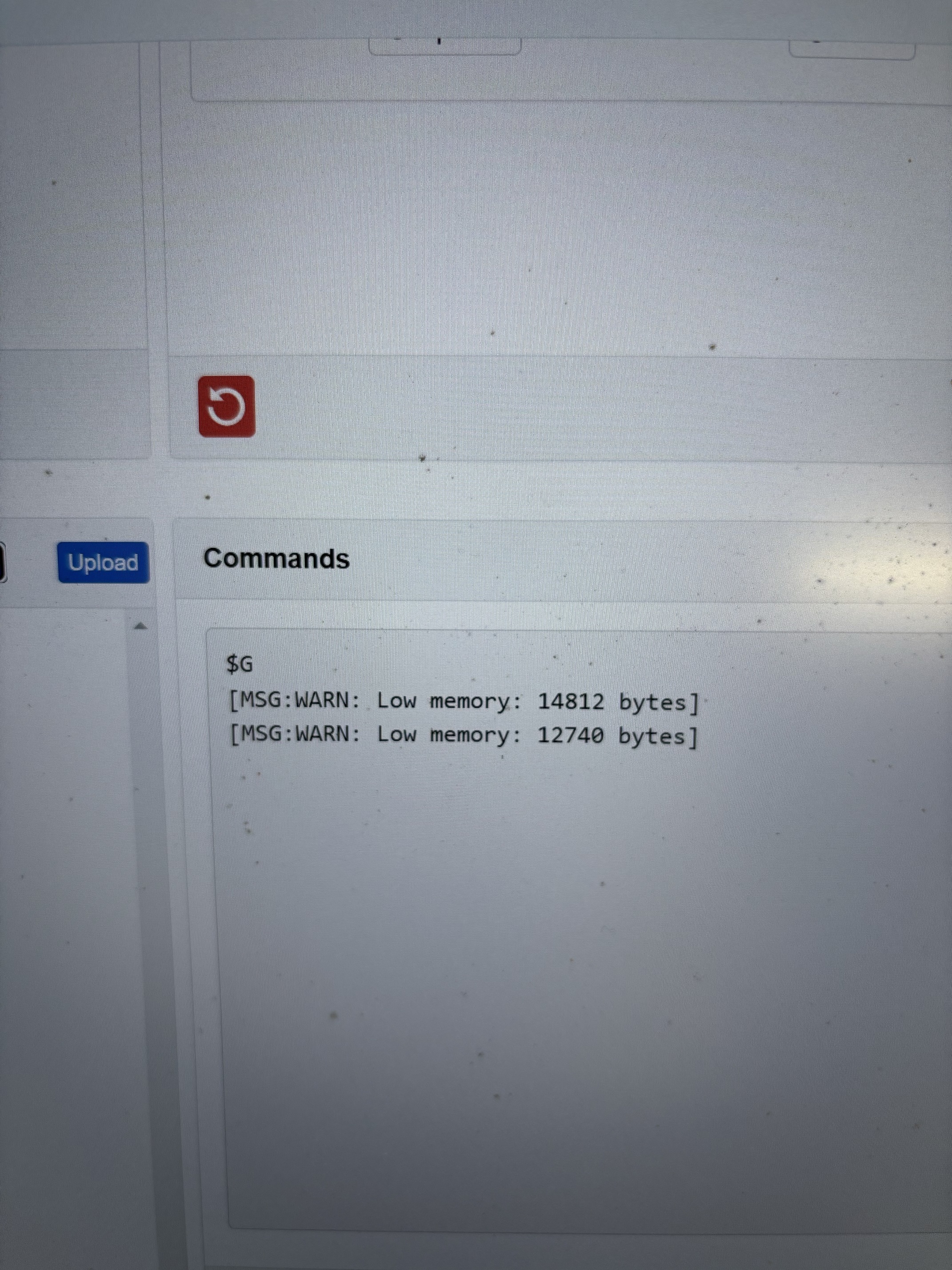

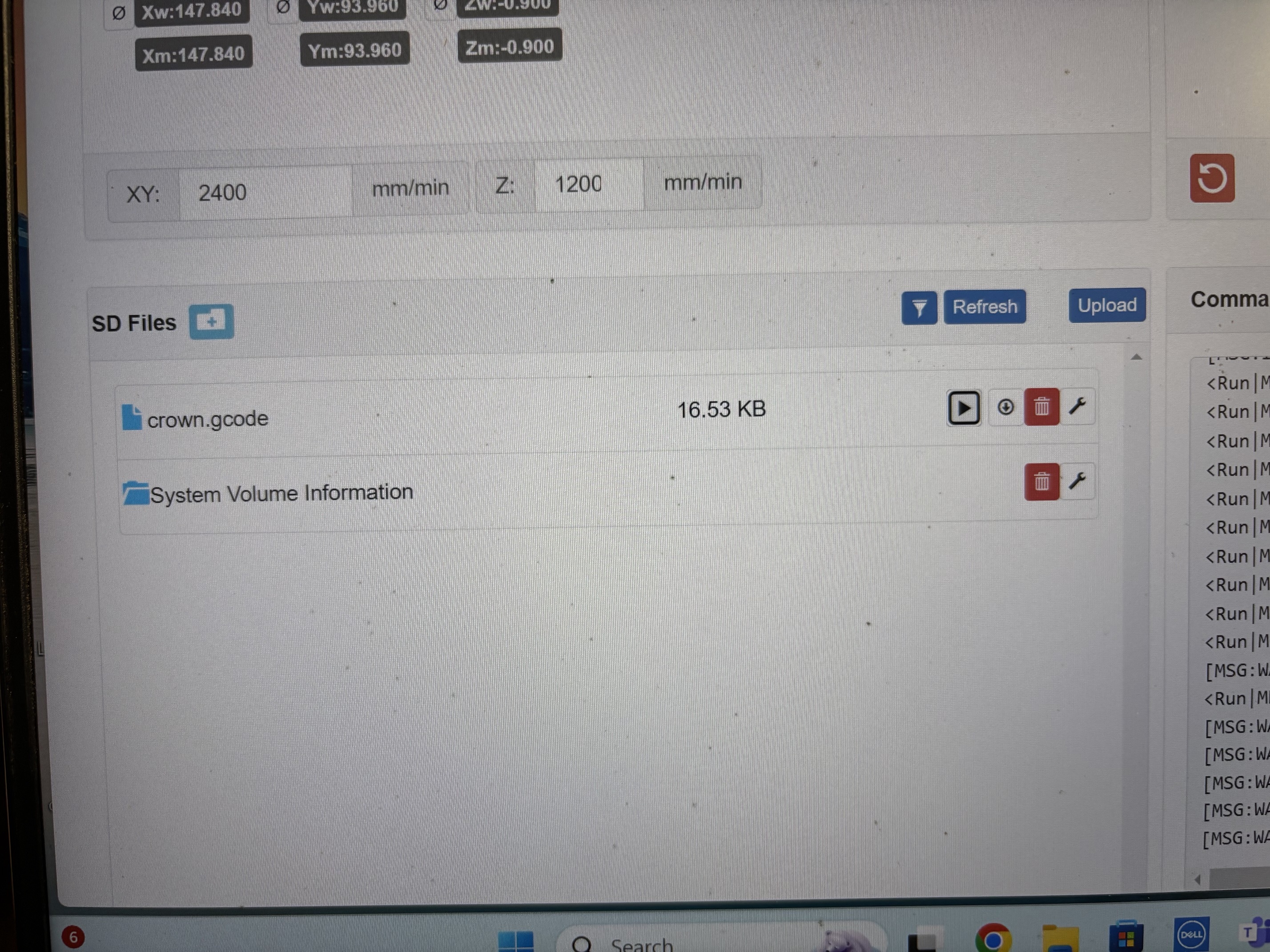

Thank you for the reply. I ‘untucked’ all the connect auto’s and powered up the machine and was able to connect. It read the card and uploaded the crown gcode. And it actually went through the motion of drawing the object (without z probe) and returned to zero point when it finished. All was good …. Then…

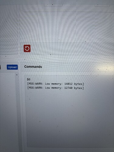

It disconnected…. Said low memory (might have been saying that during the job), error code not in idle mode… screen shots below. I have to be close since it went through motions :slight_smile:
Here is what I got when uploading gcode file
Then this popped up - hadn’t seen this before

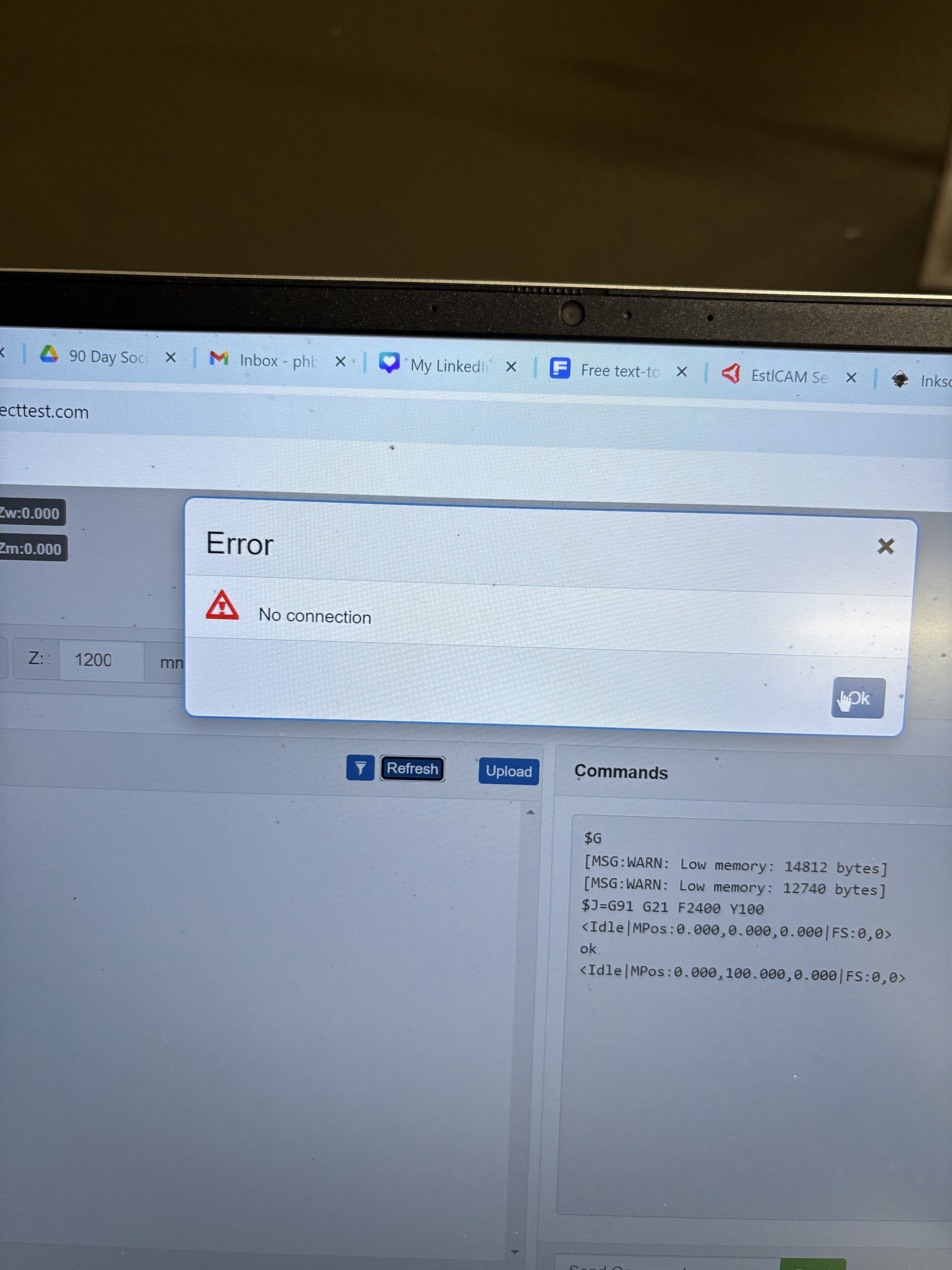

And when I checked, it showed we were still connected

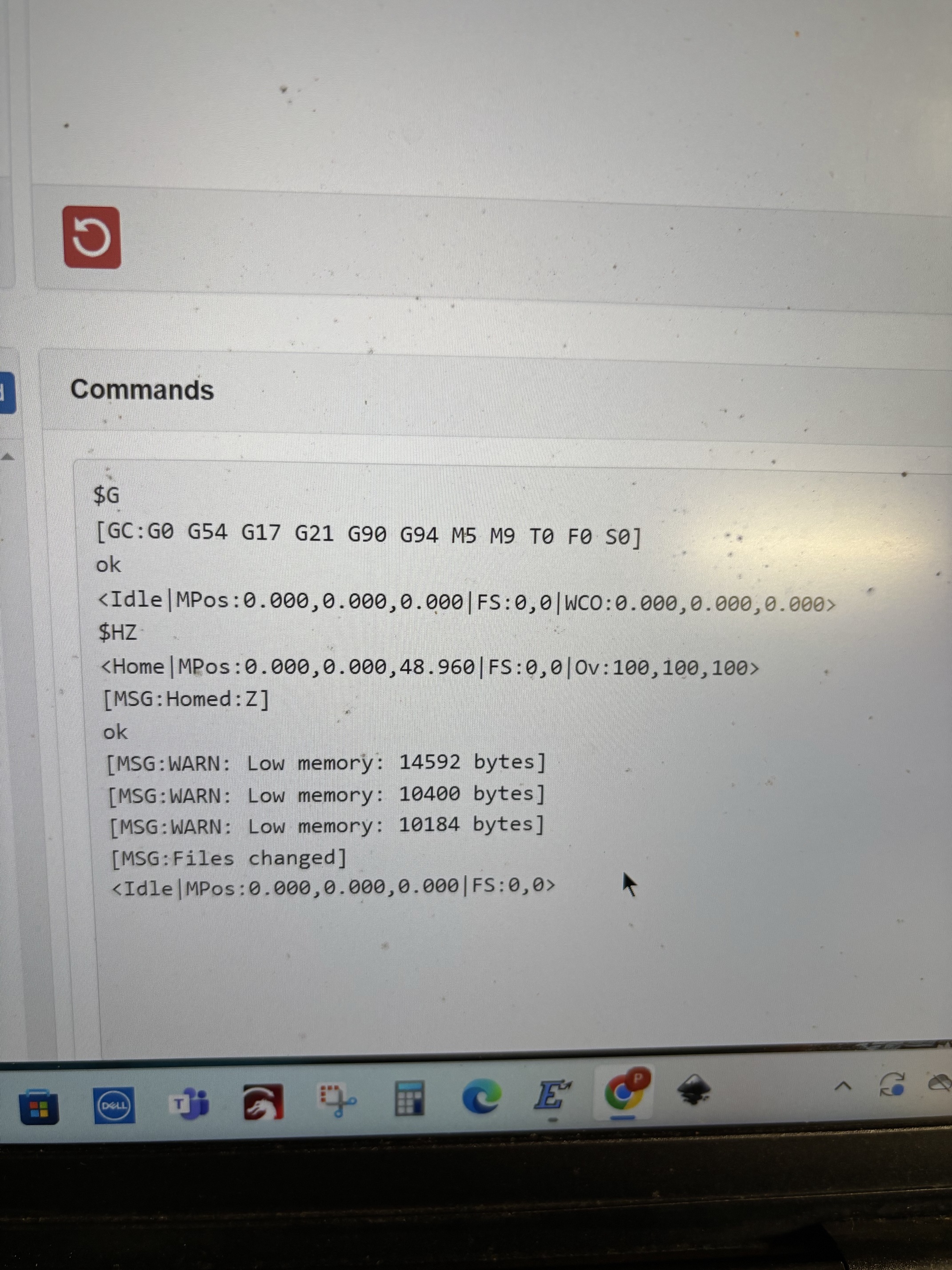

But it required me to open another browser page which I did and attempted to re-home Z.
Got more low memory notices
And attempted to run crown job again… more low memory notices
Nothing was going on, tried again, then refreshed card dir to see if i was still connected.
That’s when the IDLE error appeared. LOL

Here is the memory card I had on hand. Fat32 format

I think, if my memory serves me right, that 3.7.xx was messed up, especially regarding the WiFi connection. You can update it pretty easily, there is a great explanation posted on the forum a few days ago:
The current version is 3.9.3.
appreciate the input… I successfully connected the board to my network. Wow. What a difference.

  1. Disconnecting from Network. Seems to have been resolved by having the Jackpot join my home wifi network following the instructions laid out in the video above. I have yet to ‘disconnect’ after performing that task.
  2. Doubled checked my sd card, it is 32GB class 10 so it is not an issue. Once jackpot joined the wifi. network, accessing and uploading the gcode file was executed w/o issue.

There are no „V1 Updates“… there is only one FluidNC, the only choice you have is between webinterface v2 and v3. Both are working now, you have v2 if you want to keep working with what you know.
You should definitely ditch 3.7.xx, it had some other major bugs as far as I remember, but am too lazy to search the forum. :smiley:
