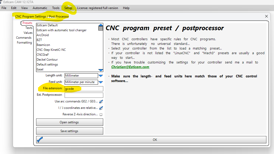

EstlCAM defaults CNC Program output to .nc file extension. You can change this behaviour in the Settings - CNC Program Settings/Post Processor window.
For existing files. you can use Windows Explorer to simply rename the file extension to .gcode (that works with .nc files, not sure about .tap files)
