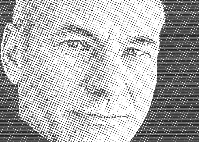

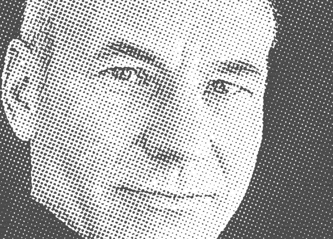

What I think you are seeing is a dithered output… not grayscale. All laser dithered output is dots… whose varying density will make the “shades” of gray you see from a distance. But the laser output is either on or off… either a dot or no dot. This is “halftone” output from Lightburn…
