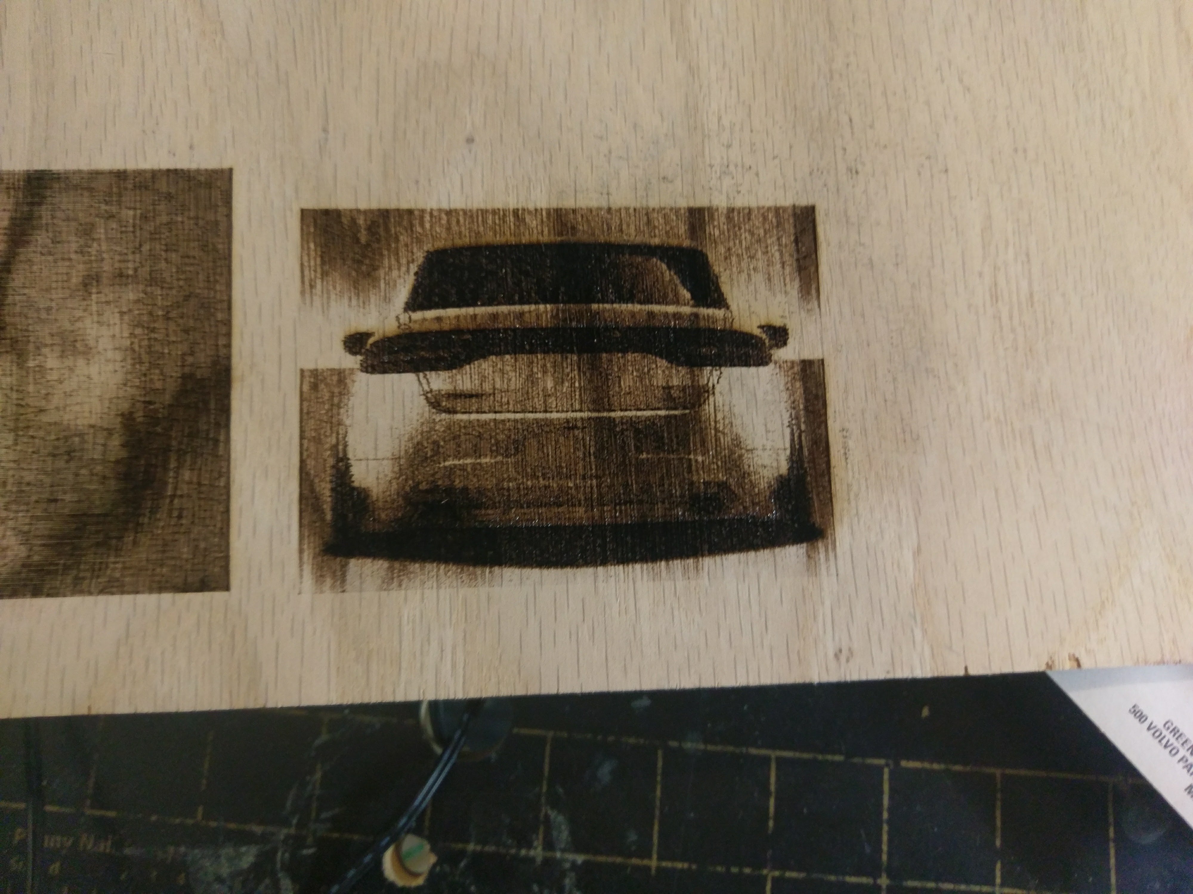

So I tried the Inkscape plugin and realized that you can only cut with it. I then tried Image2gcode but that only lets me raster engrave. I want to do both in one piece of software. Is estlcam capable of both cutting and engraving in a single project? I have estlcam, Inkscape, Artcam, Aspire, and Solidworks. I’m looking into if Artcam, Aspire, or Solidworks can accomplish this but if you have a one shot solution then let me know.
The lighting is horrible but this is what I did with Image2gcode. Back of a Dodge Dart
