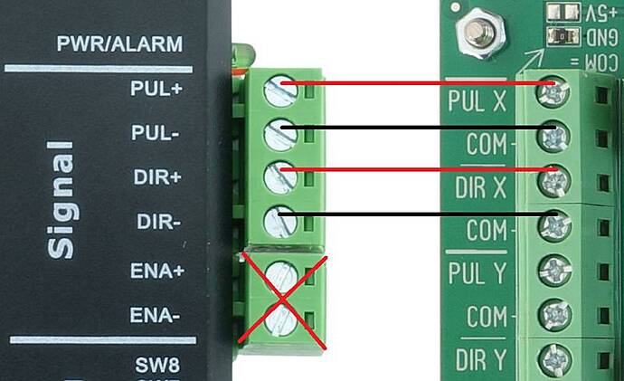

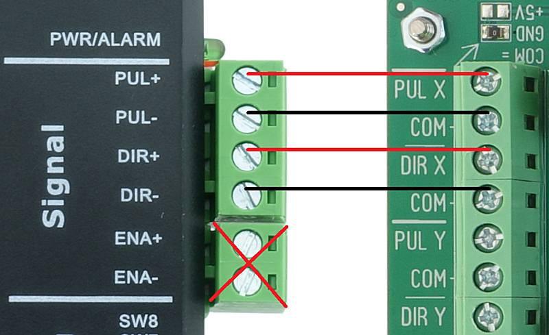

Now while the board is on it’s way I am preparing my connections and I think I figured it out but would like to ask if this is correct:
@Tokoloshe @christian-knuell
Tagged the 2 people that have the best chance to help you out. Many use Estlcam here for CAM but not many for control.
I think Philipp (@tokoloshe) is using the Open CNC Shield 2, while I’m using the Open CNC Shield 2 Mini. The connections should be pretty much identical when using the Estlcam terminal adapter.
It might be worth checking out the Open CNC Shield knowledge base — there are also guides for wiring different spindles, lasers, VFDs, and motor connections. There’s also a specific guide for the Estlcam Terminal Adapter XL.
The OpenCNCShield is funtionally the same as the Klemmenadapter XL (not the M you ordered). I have no experience with it therefore. The rough basics should be the same though.
Maybe this helps: Der Estlcam Klemmenadapter XL ⚙ CNC-Steuerung für Fräsmaschinen, there are pictures at the bottom. :slight_smile:

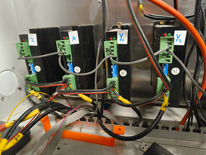

I got it prepared like this now: (yes it’s a bit ugly :slight_smile: )
I am new here so cannot edit my post or post links but the text is from the klemmenadapter_en.php from the EstlCAM website.
Also if people want to know why I didn’t get an openCNCShield, it’s because I don’t want to f around with my machine anymore I just want too use it. And the Klemmenadapter is what I need to use it.
The OpenCNCShield is the Klemmenadapter but with removable terminals for the cables. That’s the only reason I bought it. The included ESP with autosquaring does not matter for a 4-driver CNC, but you are going to need it for one with five (e.g. the LR4). You won’t be able to square the machine with your board.
I’d also always leave out the ENA. Just makes you get a headache. :slight_smile:

Any here got any tips on this issue: I have set my stepper drivers DQ542MA to 1600 pulses and I am using Openbuild TR-8 trapezium which should do 2mm per rotation.
But I need to set ESTLcam too 1600/1mm or 3200/2mm. (factor 2 error)
So ether the drivers are set too 3200 or ESTLcam is outputting the wrong steps. Or something else.
EDIT: It does 8mm per rotation….
