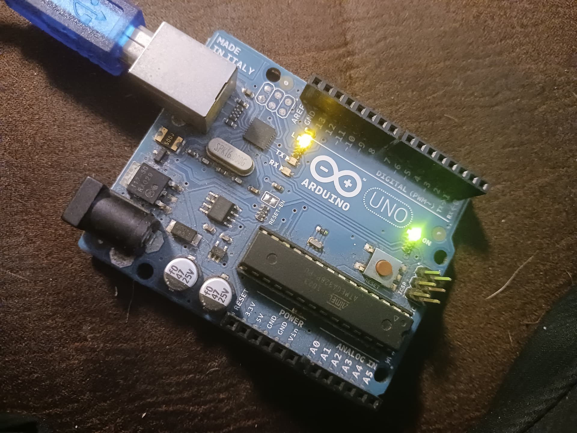

Is this with an arduino that has already been programmed outside of bottles? If only the programming is the problem, then that might be useful info for Christian.
It’s really hard to guess. Bottles is remapping all of those calls to other functionality. Most of it has been mapped correctly, but obviously not everything.
Would Estlcam handle it if that function threw an exception instead of just quietly failing? Is there any way for David to get a log or trace of Estlcam while it’s crashing?
It’s just an old original UNO that I pulled out of the junkbox. It’s been programmed numerous times but not through Bottles until these tests. It had “blink” already on it when I picked it to play with. Please ignore the dog hair…

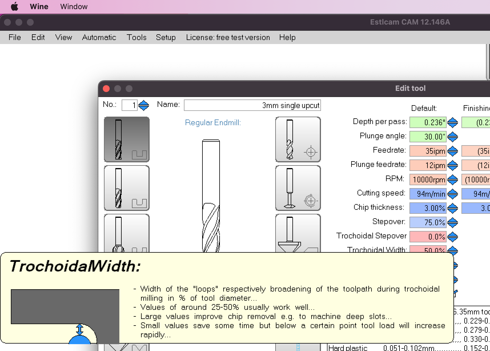

An update on using EstlCAM via WINE on MacOS:
  • I use it on two different Macs and the behavior of EstlCAM via WINE is identical: a 2015 MBP (MacOS 12.7.6) and a 2023 MBA (whatever the latest MacOS is)
I have two main issues:
  1. “Tool tip text”: Text from tool tips get messed up, they are too large and the spaces between letters and words get mashed together, or the body of the tool tip is cut off. Conversely, some tool tips are just fine, so it’s really odd/inconsistent behavior. Screenshot example further down.
  2. “Over-zooming”: Zooming in and out via the trackpad on the laptops is wildly inconsistent. For example a small two finger scroll could make the zoom level just “nudge” like you’d want it to, and then you do your two finger scroll just a little bit further, and the zoom takes the hell off (in or out, same over-zooming behavior). I have a couple work arounds for this (see below), but it does reach a point where if you zoom too much, the application will lock up and you have to force quit :(. This only happens with the touchpad, using a mouse and scroll wheel behaves normally.
Solutions/Work arounds:
RE: “Tool tip text”, I do not have any work arounds for this, but it’s more of an annoyance than a game-breaking bug. Screenshot example below, the diagram of the tool and the remaining text is cut off:

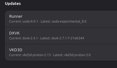

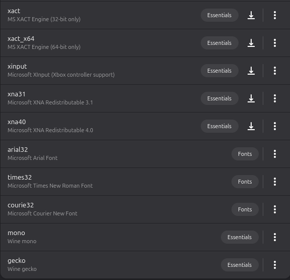

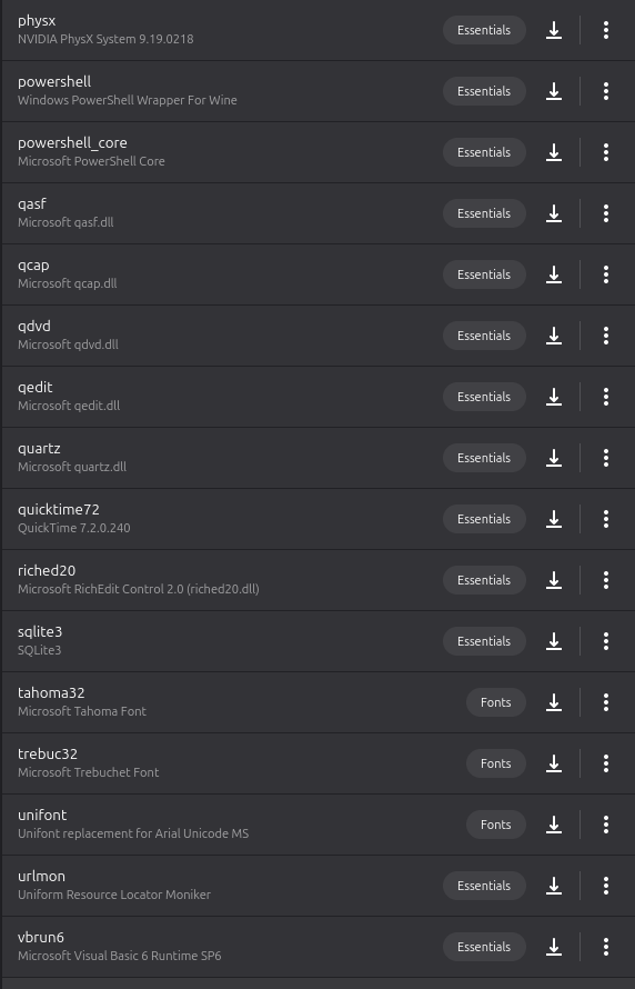

Hmm I have EstlCAM working in Linux Mint under Bottles. But not as controller just CAM. I tried to look through the threads but not sure exactly what the issues are. IIRC the biggest problem I had was the menus needing super quick clicks or they go away. Popups seem fine for me.
For the .NET stuff, you can make sure the right ones are included in the Bottles setup. I can try to remember…
Bottles from flathub. com.usebottles.bottles
groups: doc adm tty dialout cdrom sudo dip plugdev users lpadmin sambashare libvirt libvirt-dnsmasq kvm libvirt-qemu
If I remember correctly I needed the dialout. and ??
Filesharing
flatpak override --user --filesystem="/home/username/Documents/CNC" com.usebottles.bottles

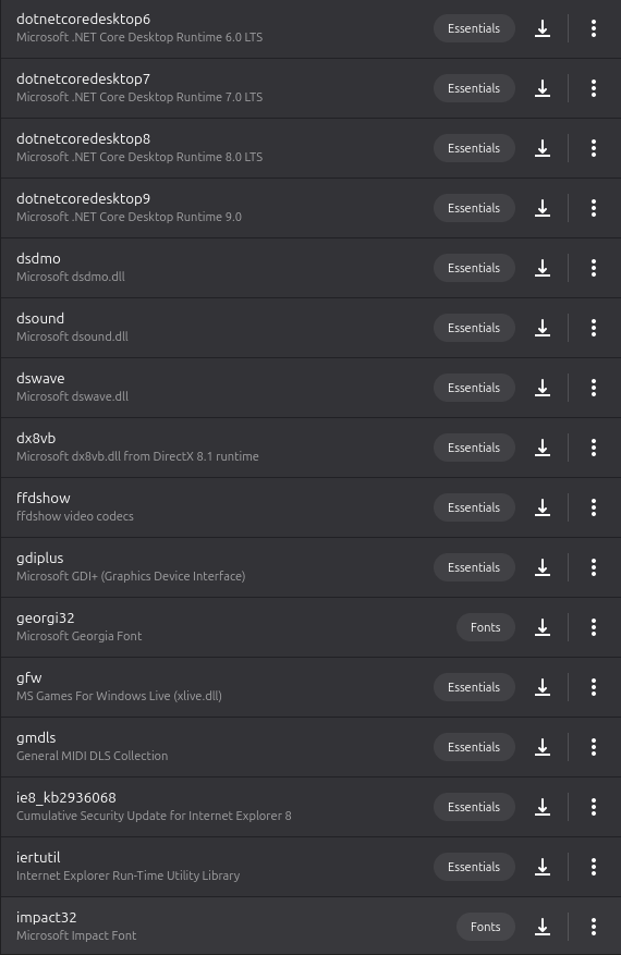

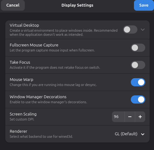

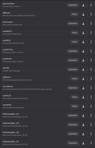

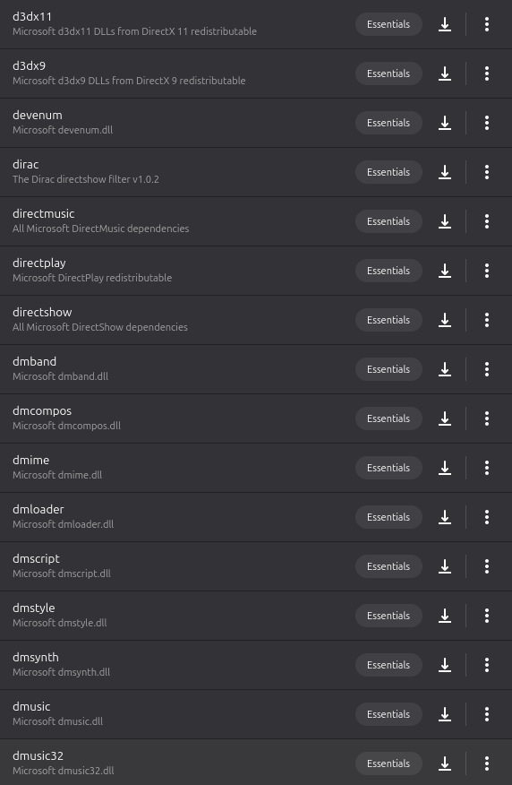

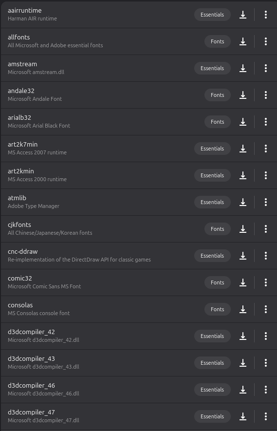

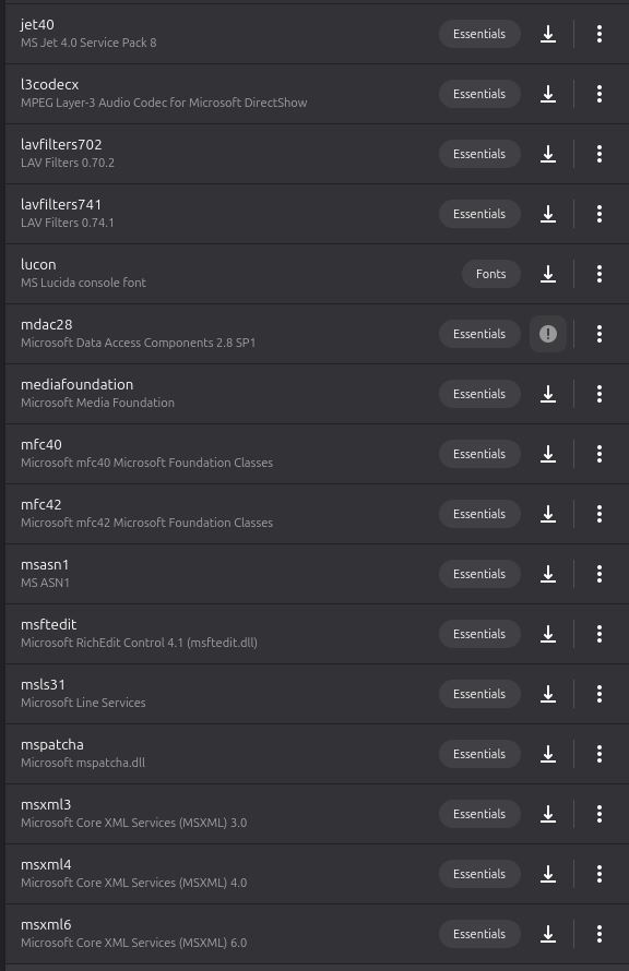

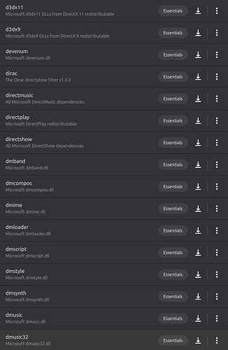

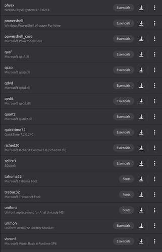

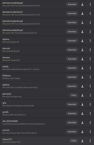

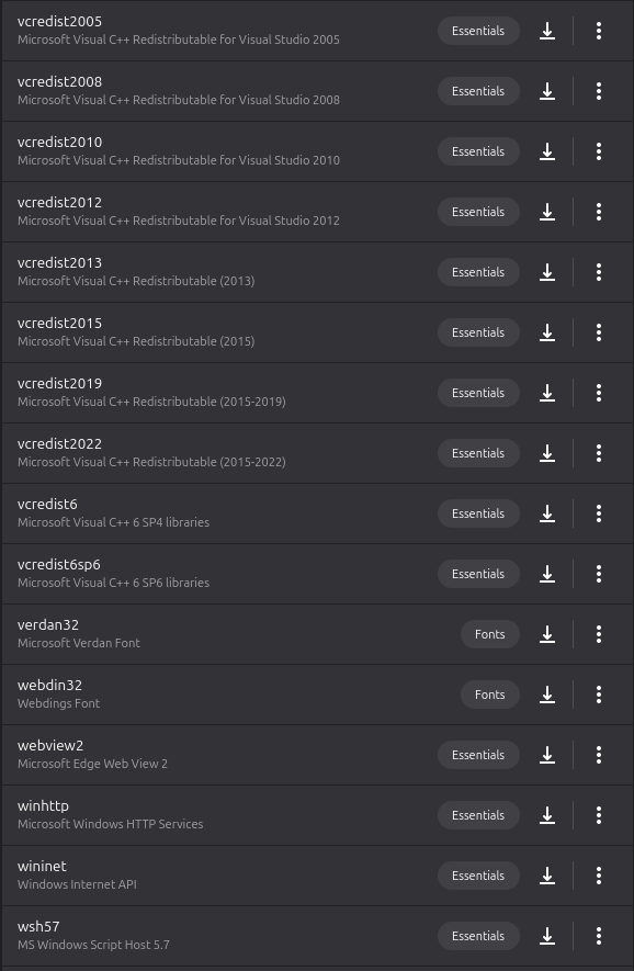

IIRC I had to install the PLatunum one that exists and look at the settings of what is included the first time but I dont remember doing that the last time.

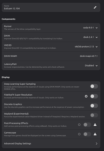

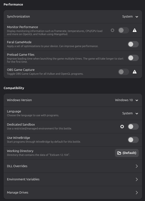

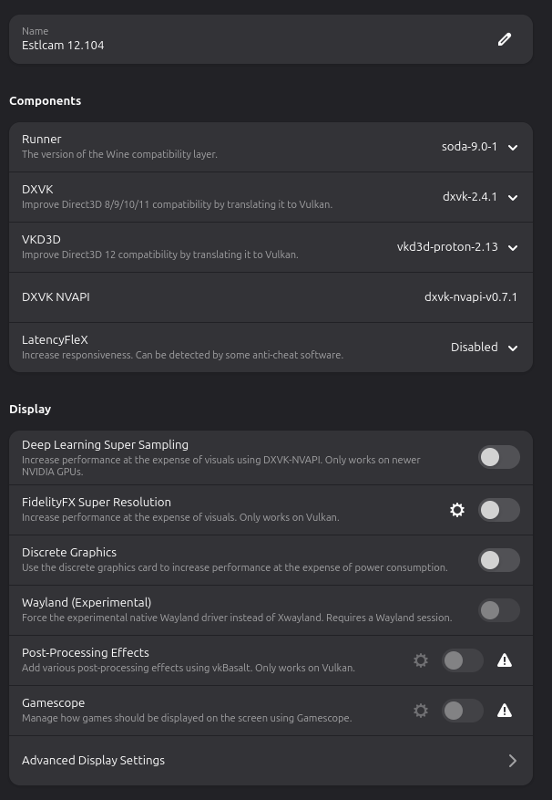

Attaching some screenshots of settings…
IIRC I chose “app” not Game". Yup saya “application”.
Mono font is required but that seems to be included now.
Dependencies are the most likely issues… ill make follow up posts since I can only add 5@time

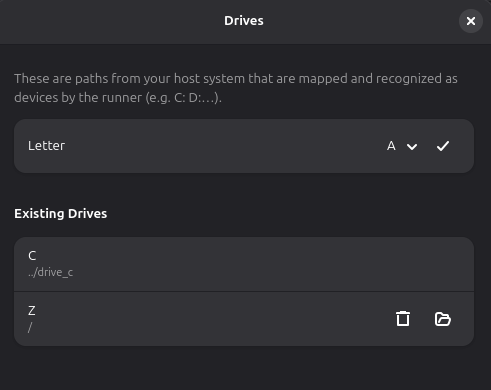

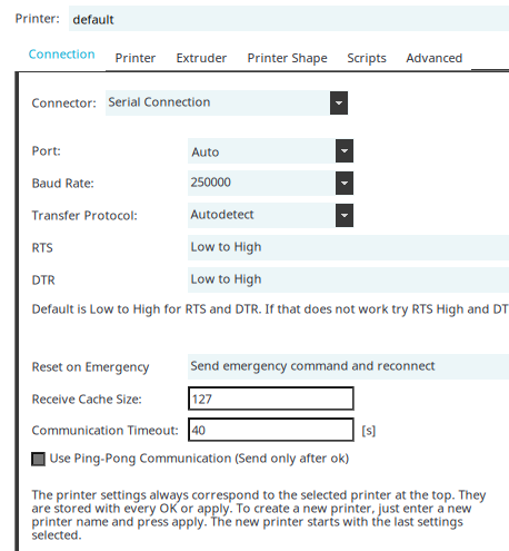

I do remember setting up COM ports being a pain. If I remember correctly it was setting the baud rate and com port took a while to figure out. No that was for Repetier. My notes suggest the dialout fix
DONT FORGET -a!!!
Sudo usermod -a -G dialout doc
Sudo usermod -a -G tty doc
Reboot
Probably not all that helpful. But originally auto and the baud rate needed tweaking.

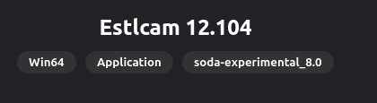

the bottles config yml exported
Arch: win64

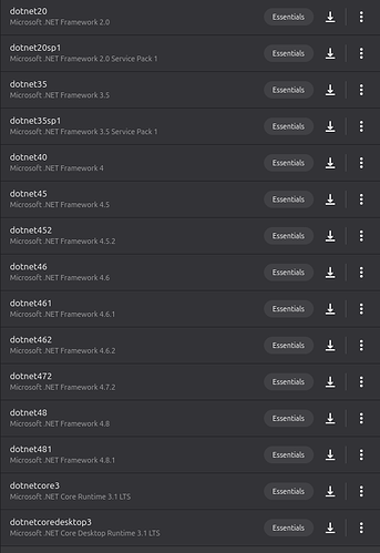

I do not even see a dependency to add for 4.8 but there is a 4.7 available under dependencies. Edit Oh it’s there I just missed it “dotnet48”
