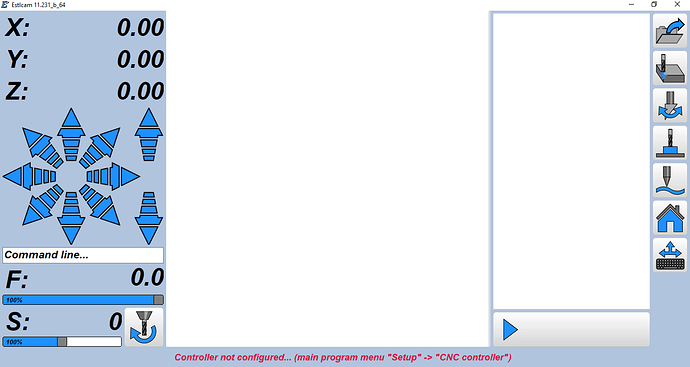

I downloaded estlcam yesterday and chose the language, the length to mm, and the rate to mm/sec. I pressed OK and then closed the program and restarted it. The problem is I dont have the access to any of the menus like setup. This is what I get on my screen:
Do I have to pay for the full version to get the menus?
We don’t use the Estlcam Control software. It requires special boards to run. We on;y use the Gcode generating part of the software.

I don’t remember and I’m not at the computer that ESTLCAm is installed on. If i remember correctly two icons were installed on my desktop for estlcam. One is for control and the other looks like the above photo. did your install provide both?
You don’t need to download anything more, you need to find the two EstlCam icons that were installed on your desktop and click on the one titled EstlCam V11, the other one (titled CNC Controller V11) is just the screen you need if you are going to use EstlCam as the CAM controller, which many on here do not use because they have non conformal controller boards (or prefer different CAM software)

Estlcam installs two shortcuts, one for the main program, one for the controller. Just click the right one. :slight_smile:
Thank you all I got it and got my crown completed. I feel like royalty now.
