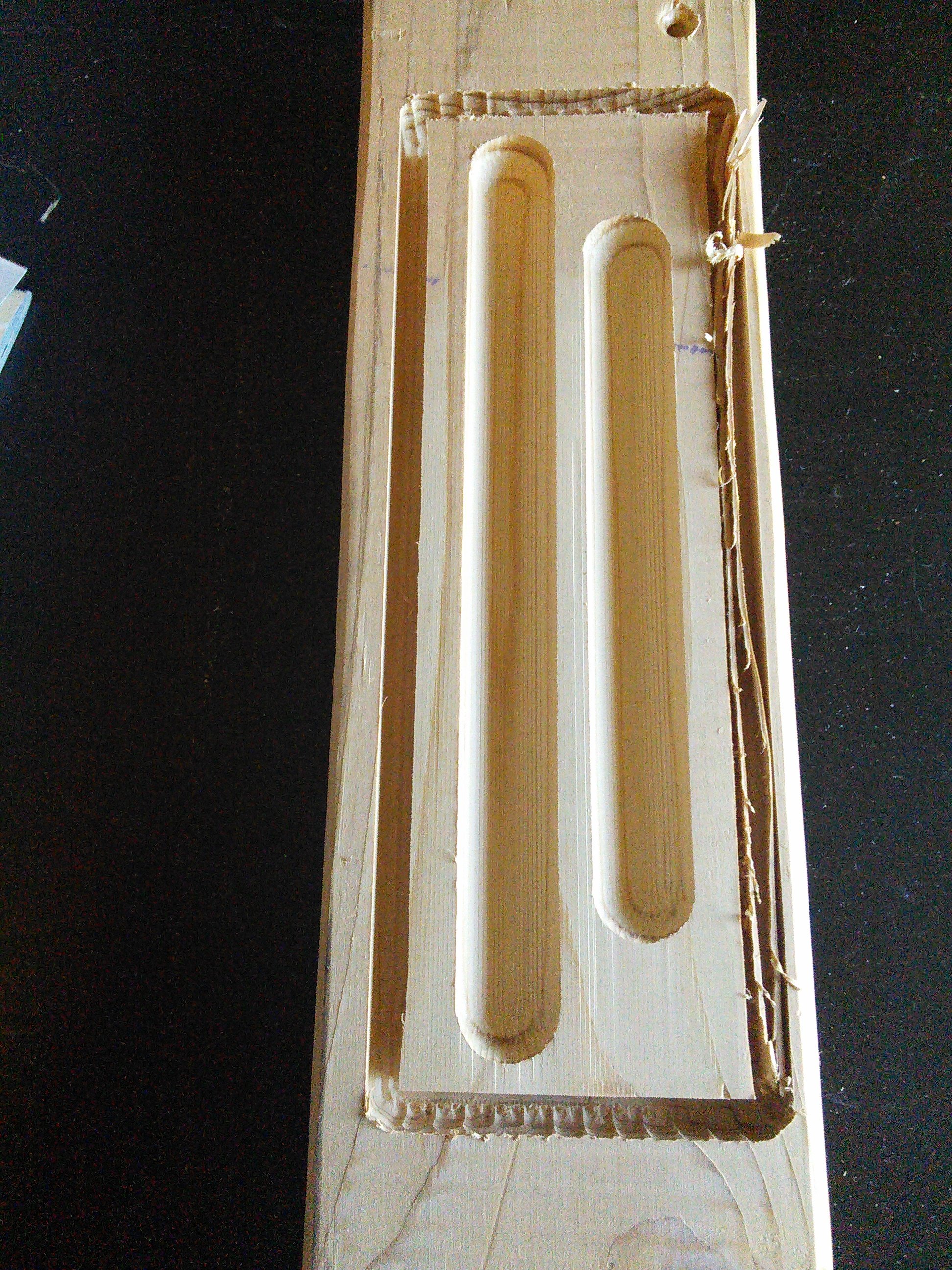

Really weird issue with Estlcam… Just before the finishing cut it tries to make a full depth full width cut along the side of the piece it’s cutting… This of course is way too much and causes the bit to veer and gouge the piece…
The part I’m cutting is essentially a box with some rounded troughs cut in (a box for turned pens). I made the part in Fusion360 and exported an STL which I then pull into Estlcam to generate G code. Cutting at 1.5mm depth and 12 mm/sec with a 1/8" 2 flute rounded up cut bit.
It’s not skipping steps because the rest of the box is cut fine and the finishing pass works fine.
I cut it with the length along the Y axis and then tried it along the X axis. It does the same wonky cut at the same place either way so I know it’s something Estlcam is doing and not hardware.

Here’s one I just took off the CNC. It was oriented with the length along the X axis. This time it dug in 3 times. It’s almost as if it’s calculating the opposite direction to move for the finishing pass. Instead of just trimming a little bit along the edge it’s putting the whole width of the cutter through. Maybe a bug? I’m using the block cutting method and leaving everything default/automatic. The Z stepping is set to 1.5mm depth and 2mm speed. The rounded troughs cut perfectly. The initial rough cut cuts perfectly… Just the finishing pass is weird and only along the length.
That is odd for sure. Are you using the newest release? Either bump up to the newest of go back like 5 and double check. Just to verify. If you have found a bug and can confirm it I am sure Christian will fix it asap.

Just ran it through CAMotics and played the Gcode… yep, definitely something weird going on. It gets through all the roughing just fine, then goes back to the first corner and bores down into oblivion and then reappears at the opposite end and rises up through the table…then goes back down, back to the first corner, then back up to the top… Then completes the finishing passes perfectly

Turning on the transparent model option in Camotics I think I see what it’s doing… It is moving inwards roughly the full width of the cutter but also boring down to the bottom and making passes upwards… So instead of starting at the top of the material and working it’s way down, it’s trying to start at full depth and then come back up.
I found where Estlcam will allow a dxf mask to be used to only machine what you want… I’m going to figure that out so I can just cut the troughs instead of the whole box. Also, I tried free machining rather than block machining and it cut the margin completely different…Seemed to work correctly from what I can tell… Camotics shows some weirdness in the same spot, but it looks to cut in the right direction

Heres the STL files… check out the difference between block and free machining… In the block file, around 40% into the timeline right after it does the roughing it gets weird…bit plunges… In the free machining file it seems ok but theres like an overhang or something… But it least it doesn’t bury the cutter into the piece.
penbox4.zip (17 KB)
You should be using free machining, block is for 2 sided objects.
Just tried 10.039 and 10.041… Same deal. When using block machining its like it ignores its working margin (which is twice the width of the bit) until right before it makes the finishing passes and then it tries to cut the rest of the margin starting from the bottom… In free machining it doesn’t do this… It cuts the margin as it descends through the piece.

Got a chance to cut the free machining file… Other than burning a little (RPM up too high I think… I usually run it slower) it cut just fine and in the correct order.
