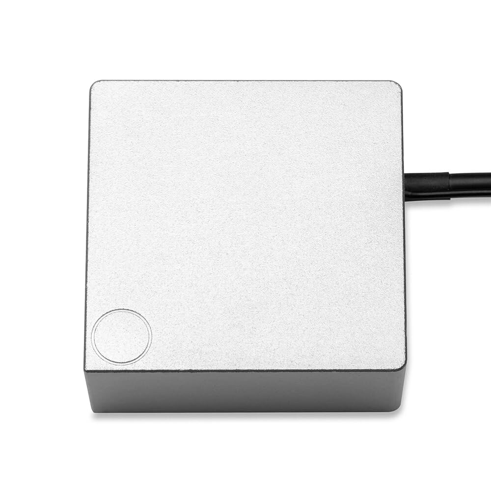

I’ve seen it mentioned a few times around but I’ve not seen any code posted or documentation on it. How do I set up EstlCAM to use one of these corner probes so that I can probe all 3 axis and find the precise corner of a workpiece? NOTE: not looking to correct for skew as I have a grid CNC’ed into my spoil board (though I’ve EstlCAM can do this)

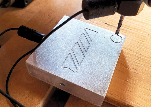

Probing any axis is available in fluidnc. The issue I am thinking about is the macro that would let you probe all three without taking forever. You can home all three axis, but you can not probe Z without being positioned over Z roughly. Probing Z has to be first. With a known Z of your probe, you can home each axis move down and slowly probe away from home but what if your probe is at y2000, that would take a long time, I think separate macros would make this much faster.
The best way would be to have softlimits on, roughly position XY (within 40mm or so of an edge), probe Z. With a known edge finder block size (or the touch plate), you have your macro move over 50mmand down and probe each axis. Softlimits are needed so you don’t try to move past machine Zero if you are close to an edge. Otherwise this can not be automated.
The way I would see this used in my workflow is quickly jog it over to my workpiece and get within 20mm or so of the corner which is easy enough. (I think the circle on the touch plate is actually a tolerance guide so that as long as your tool is within the circle, you know that your macro will move over enough to clear it and probe the sides) which is what I think your describing in your second paragraph
