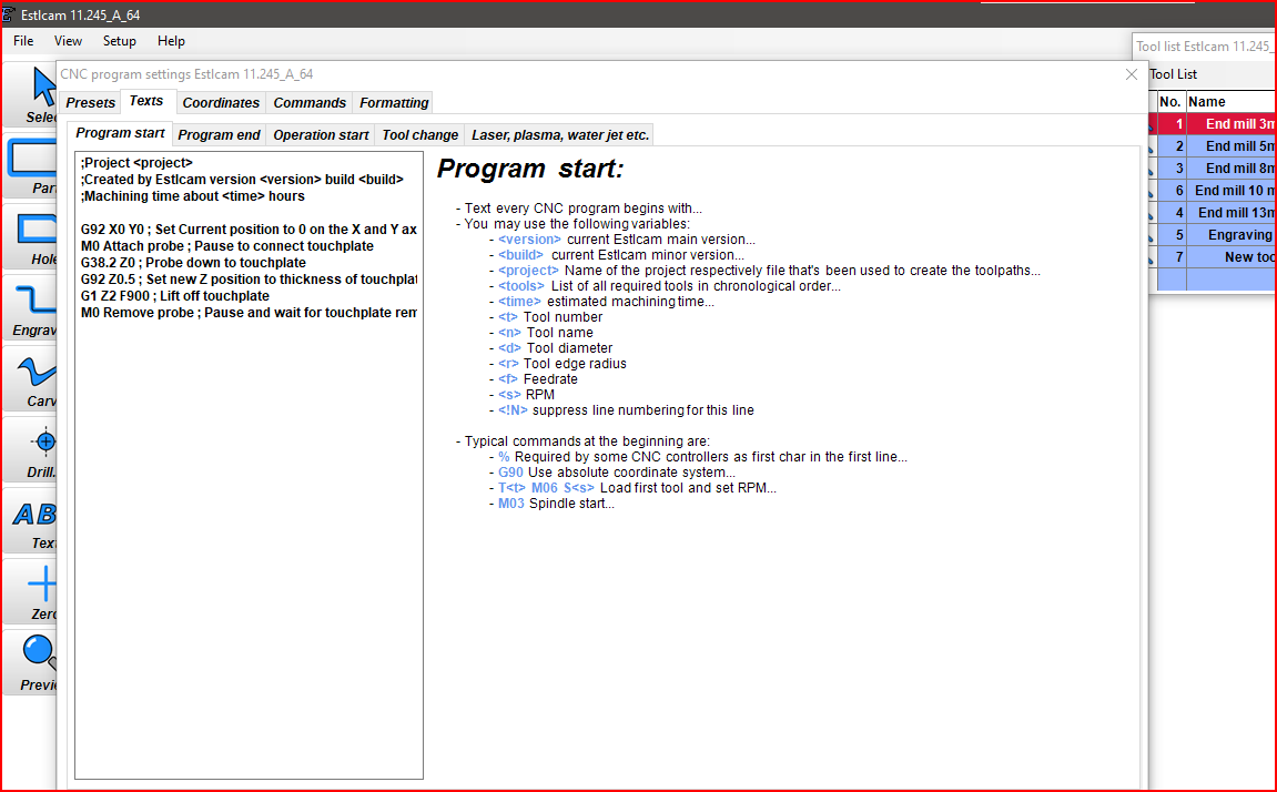

so i copied and pasted the coding from milling page every thing works fine in v 11 but when i put them into v 12 it wont allow it

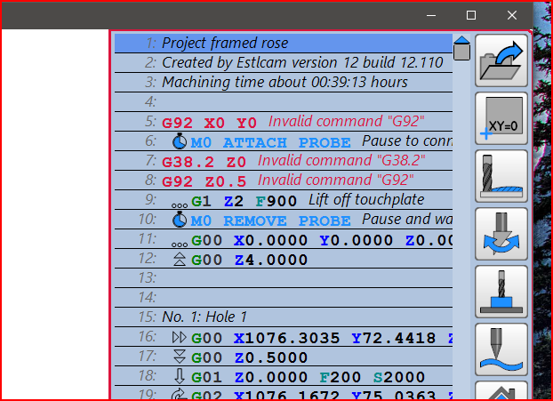

It looks like you are using the “CNC Controller” area of EstlCAM. This won’t work for you. EstlCAM can’t control an SKR Pro directly.
To run a file, you need to save the file out to an SD card, and run it from the SD card on your machine.
DO NOT use the “Start Machining” function. That opens EstlCAM CNC. EstlCAM CAM is the only thing you will use with an SKR Pro running Marlin

when i use file from v 11 it probes fine
when i usefile from v 12 it wot probe just keeps going down
have exact same settings in either version
everything works fine with v11 , but am having allsorts issues when trying v 12
im only using controller to look at what the codes are saying not using it connected to machine
In that case, your first post is very confusing. You mentioned nothing about a probing problem, but prominently displayed errors being shown in the CNC controller in EstlCAM instead.

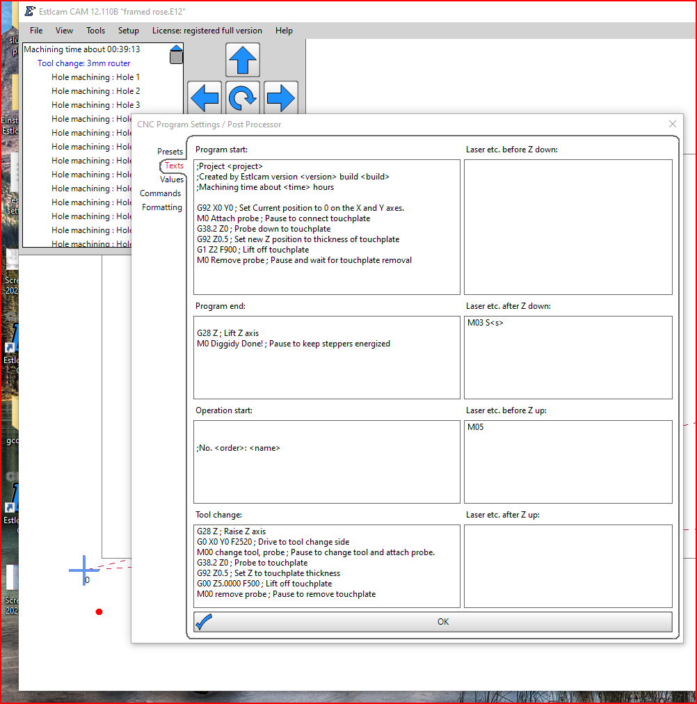

If you want us to take a look, you can start by taking the file produced by v11 and the file produced by v12, zip them up and attach them here.
If v11 is working for you, but you are having issues with v12, I would suspect that you haven’t set up v12 to be identical to v11.
I would especially take a look at the starting gcode section, to see if you are setting Z= 0 (G92) in one and not the other, or if you are using relative mode (G91) in one and absolute mode (G90) in the other.

the pics clearly show that the probe command in v11 works but not valid in v12
probe or bit not the prob its the g92 g38.2 codes giving the issue
Have you tested the code on the actual machine or just in the Controler portion of Estlcam? Your code looks correct and should work on the machine.
Because you showed the controller interface.
When told the controller interface is irrelevant, you said the problem isn’t the controller interface, but you were just looking at it, however didn’t mention an actual probing problem until after.
Now you are referencing the controller interface again.
Again, that controller interface is irrelevant for the SKR Pro running Marlin
It’s still unclear to me whether you are saying you have an actual running probe problem, or are just referencing the controller interface.

If you want some help figuring it out, you’ll need to be more clear about what you are actually seeing happen, and maybe show the difference in what the output in the terminal is on the WebUI for both situations if you are seeing an actual problem running the machine.
Also, you can post the 2 files like I asked, that might help.

V11 vs V12 has no way to affect the probe.
In our operation, it is purely producing a gcode file.
If set up correctly, the start GCode should be identical.
The way to verify this would be to open up both files and ensure the start codes are identical.
If so, then EstlCAM has nothing to do with it.
If not, then EstlCAM 12 is likely not configured correctly.
If the issue is probing from EstlCAM g-code, maybe remove that from the starting code, and just do a manual probe instead. ???
