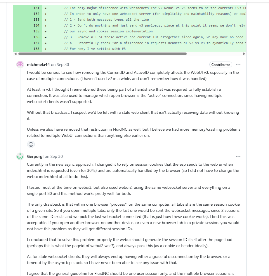

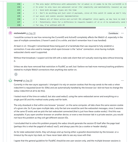

And it’s much worse than that. there was a separate PR for changing out the Web Server with an async server, and the guy doing did some maybe questionable stuff that is also rolled in. Also I think some other USB support, etc. etc…
The next one is going to be a big change, and I don’t know if they broke any WebUI-3 stuff in the process or not
Yea, I’ve been following some of it and it sure looks like a mess. I found it interesting that Mitch had to update WebUI v2 to get something to work.
Well, at least with a Jackpot V1, I can put it on a separate ESP32 for testing when the time comes. After the 3.8 debacle, I’m not in a particular hurry.
Yeah, the guy doing it decided that because he didn’t know why something was there, he would just remove it…
and they just carried on…
so… we’ll see what happens
