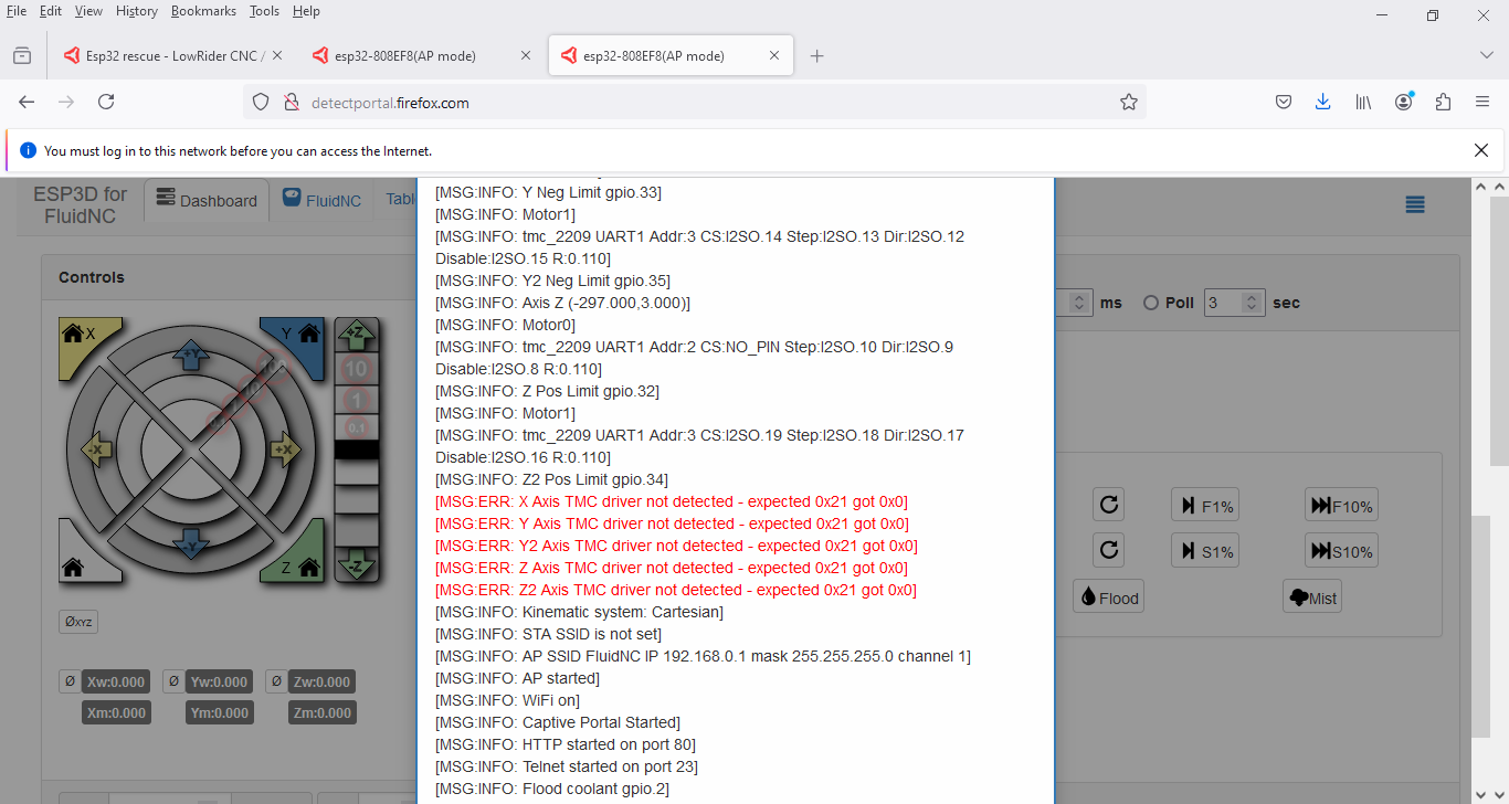

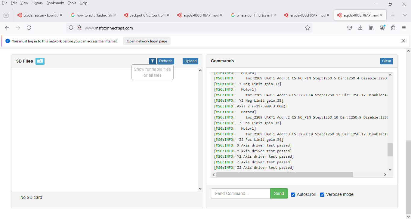

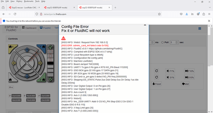

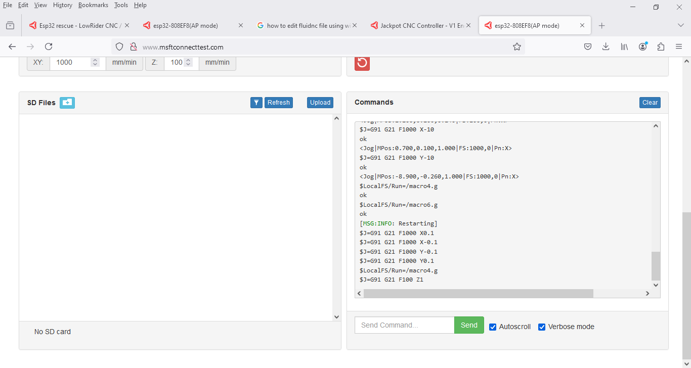

Well I tried and put the esp back on the board today. But not a one of the motors will move. I haven’t modified the config folder or anything.The software says it moved. But none of the motors will move. What am I doing wrong now? Even if I have a motor plugged into the wrong port one of them should move. Right?

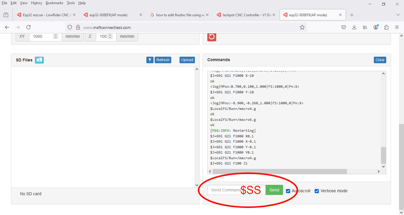

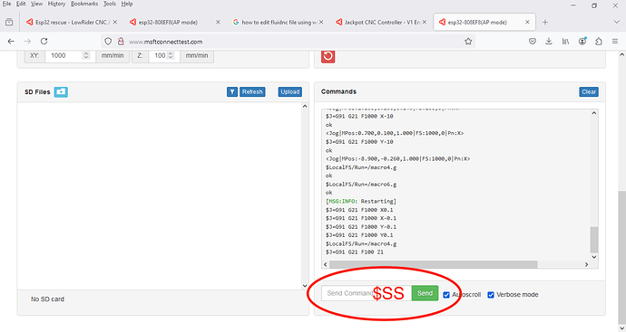

Can you put up what you get from $SS That will show if everything is initializing correctly.
I’m not really sure where to find that.
Go into the terminal and send $SS. Then cut/paste the results from the window above that here.

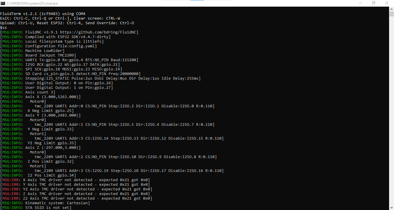

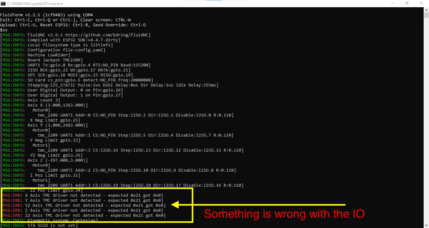

When I unplug the power and use the usb cable running fluidterm. This is what I get with $ss.
You can’t get diags while jackpot board power is off. Since the Jackpot is not powered, all of the electronics on the jackpot are not there, so FluidNC can’t see them or move.
Edit- you can connect FluidTerm while the jackpot is on, but it’s way easier to just use the WebUI terminal as marked up above.

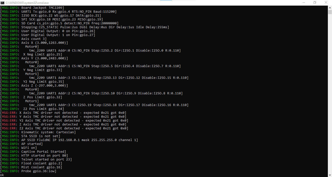

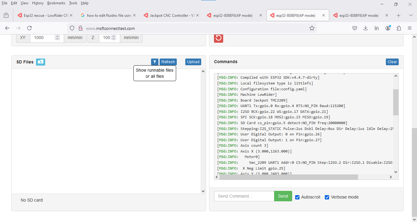

Is this what you’re looking for?
Yes, but cut and paste the text.
A screenshot of just part of it is insufficient. We need the whole output from $SS.

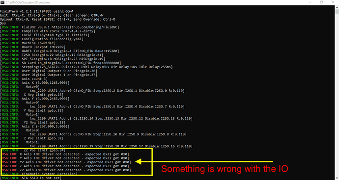

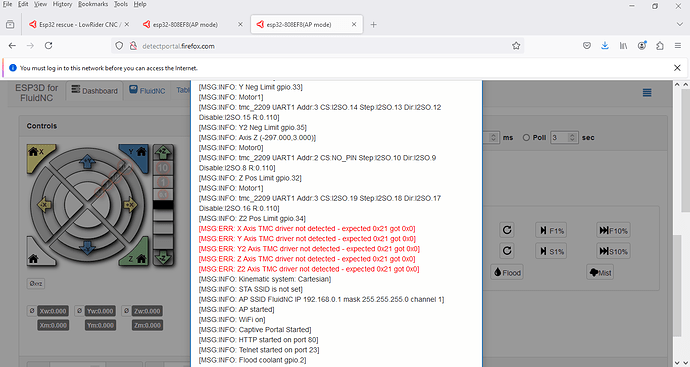

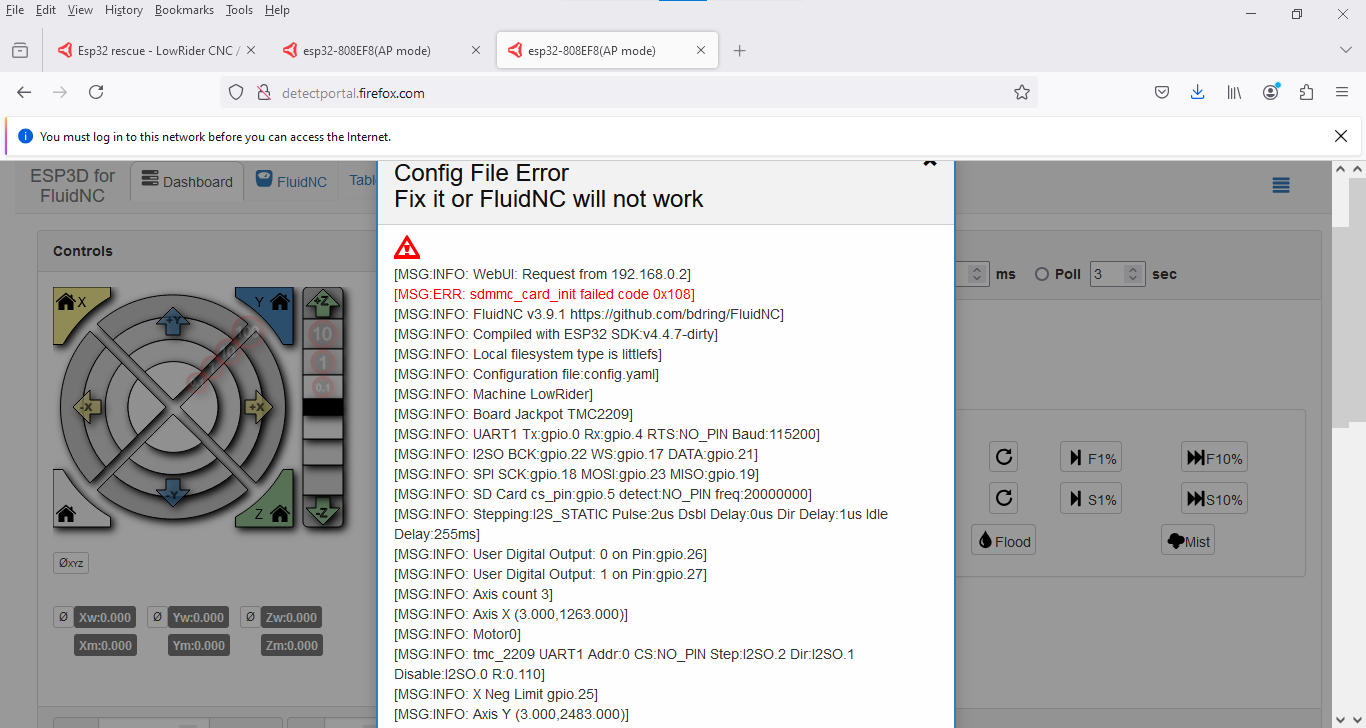

This is the top half.
I don’t see any error codes.

This should move.
Make sure to power on without a USB cable plugged in or the boot order can get messed up.
That’s what i did with the text i sent. I don’t know why things aren’t moving when i power it up.
Lets see a picture of your wired up board.
What exactly are you doing to try and move the steppers?
