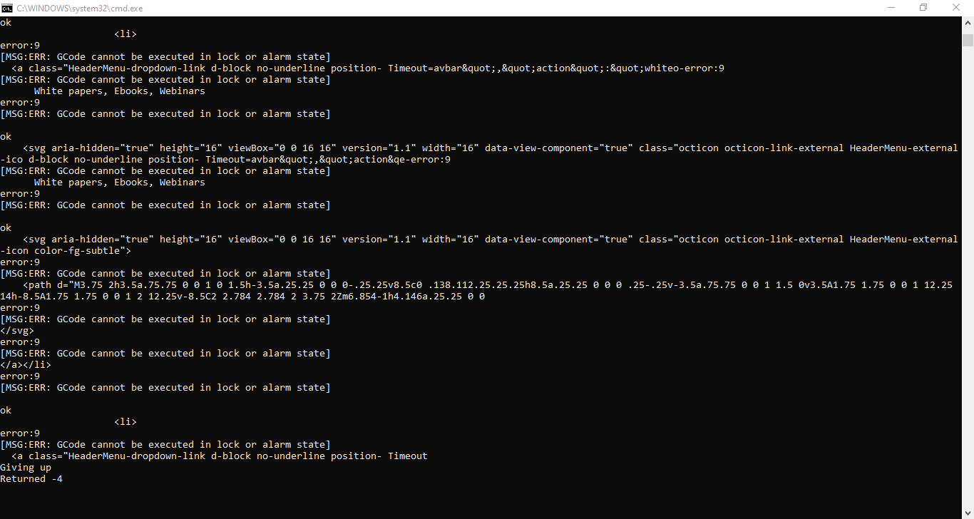

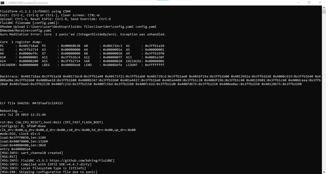

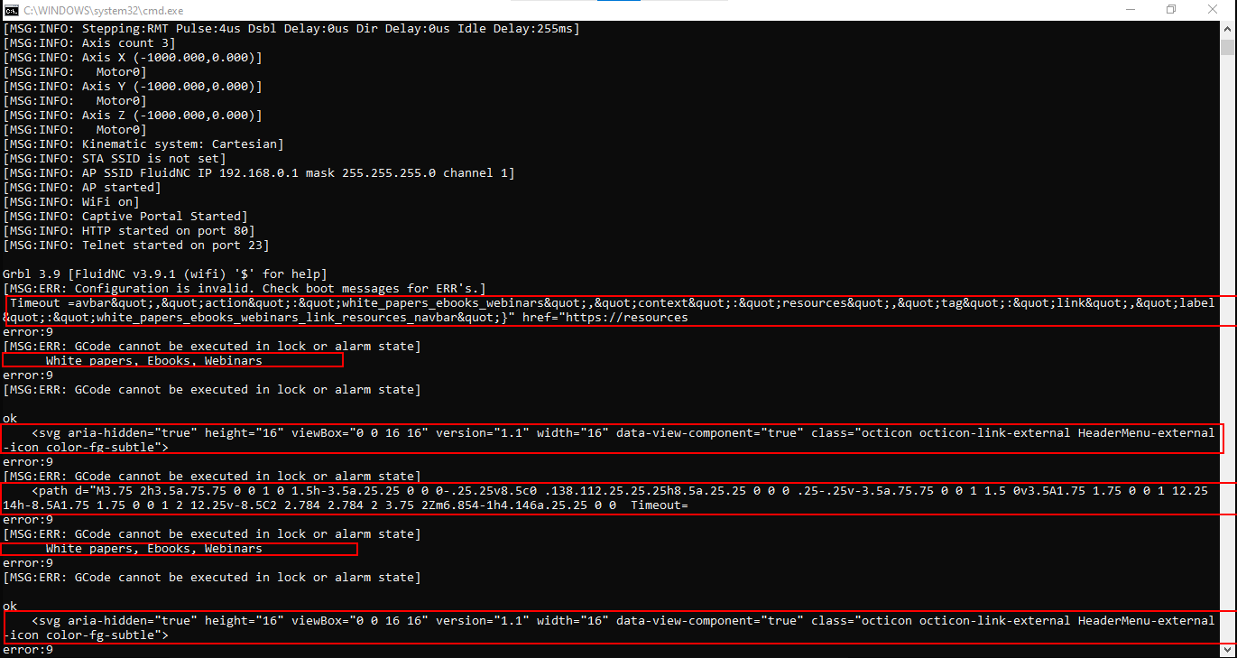

This is what I get when I run fluidterm. And when I run the web installer it just sits there and spins for hours. I don’t know how to do a terminal test copy. The files are unzipped. I did that after downloading them.
Can we see the first errors please.
Are you hitting the boot button when the dots and dashes come up? You should be. Some is just a press some take a hold until it gets to the next step, this will need to be done twice.

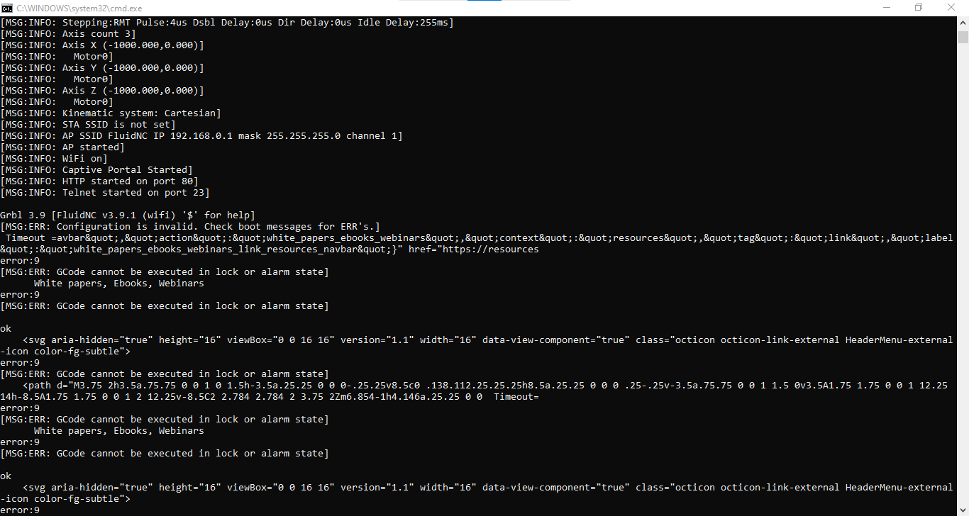

I didn’t know I needed to hit the boot button. I have this off the jackpot board. That shouldn’t make a difference should it? Here’s two different views of the codes.
This looks like you have some files in there with some very bad data…
Looks like your config file is full of HTML.
Not sure why it’s then trying to think it’s executing Gcode, but something looks very wrong
or maybe your config file is getting it to try to run something on startup? and that thing is pointing to HTML?
Do you have anything on there other than just the standard config files from Ryan’s github?
Okay so it looks like all three flashing steps are working fine, you have an esp that does not need a boot button press.

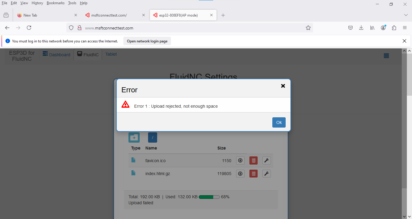

I will go back to the github page and redownload the files and try again. I’m using what I downloaded last time. When I log into fluidnc and try and load the file this is what I get.
Which file did you try to load?
config.yaml
you have 60KB free.
How big is the config.yaml?
190kb
it should be like 8KB.
Use the one Ryan just sent you in the zip file

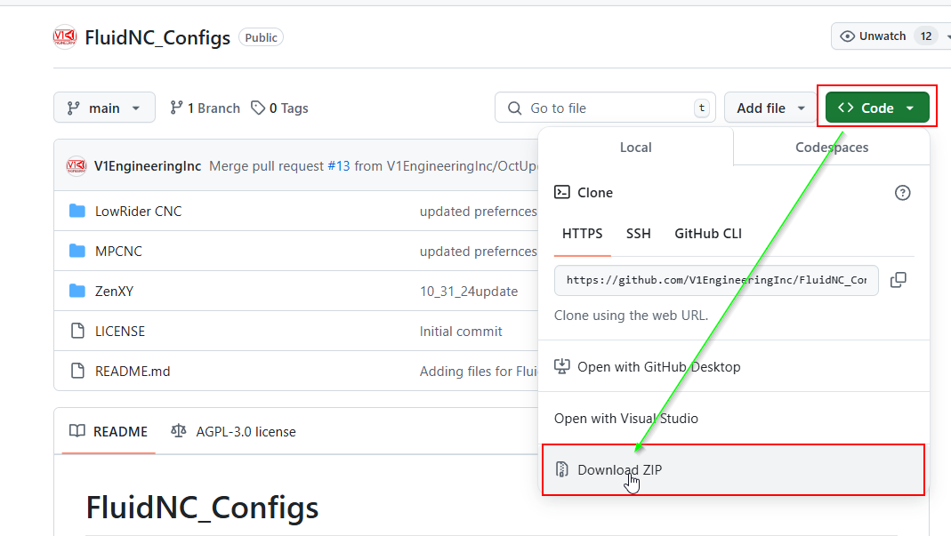

I just unzipped the files that Ryan sent me. Give me a little time and I will see If I can get any of these to work. I don’t know what happened with the other ones I downloaded from github. I’ll let you know what happens.
Just guessing, but it looks like you must have actually saved the github web page itself rather than downloading the actual config file
This is the easiest way to get the full set from github correctly

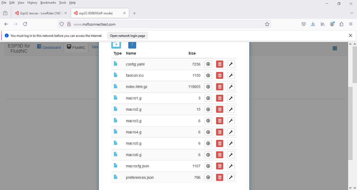

So is this how everything is supposed to look like? I installed all the files Ryan sent me
Am I done? Can I put is back on the board again and run it?
