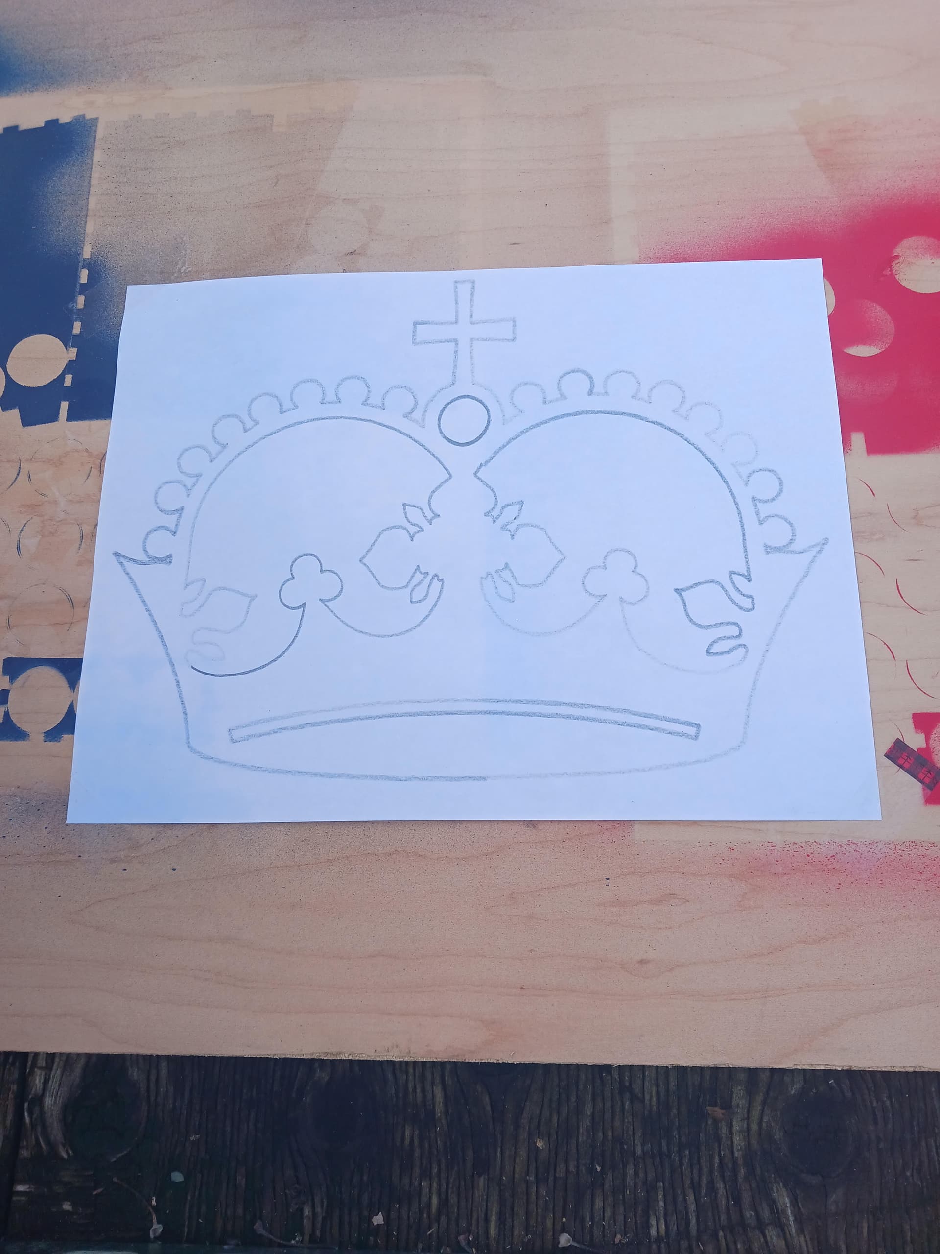

We have a winner. I need a little more work to it but I got it to work. I think I have a limit switch on the X and Y mixed up. The switch activates but it doesn’t stop the motor. I’ll fix that once I put the gantry strut on. I tried the crown test. And when that went well I jumped into cutting the struts right away. My plan is to cut out the torsion box table for it Wednesday.

Love to see a new crown!
