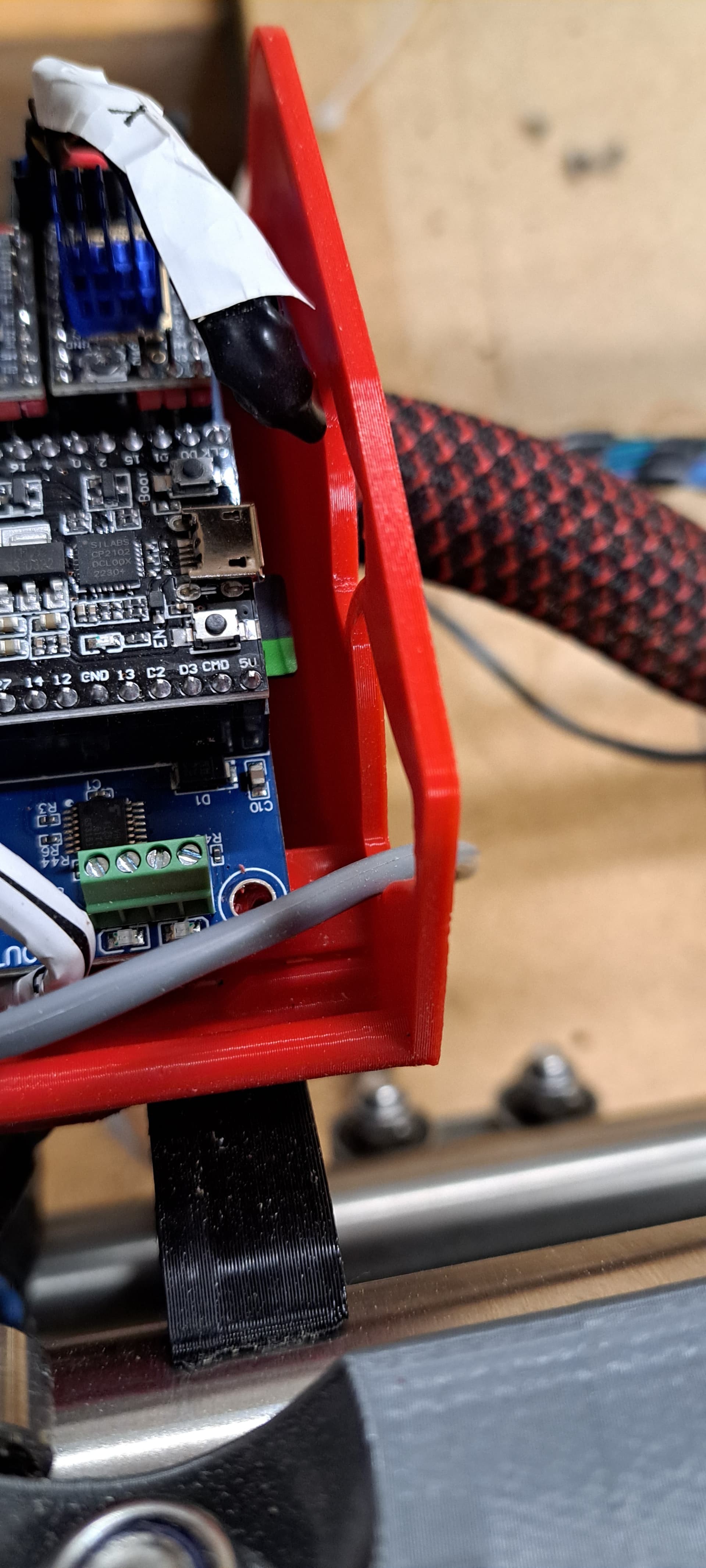

@vicious1 Are you using a different case for your jackpot? There is no way I can pop the SD card in and out without having to remove the board from the case. Maybe I need to spin the board around.
Bingo
Doh! Haha :wink:
