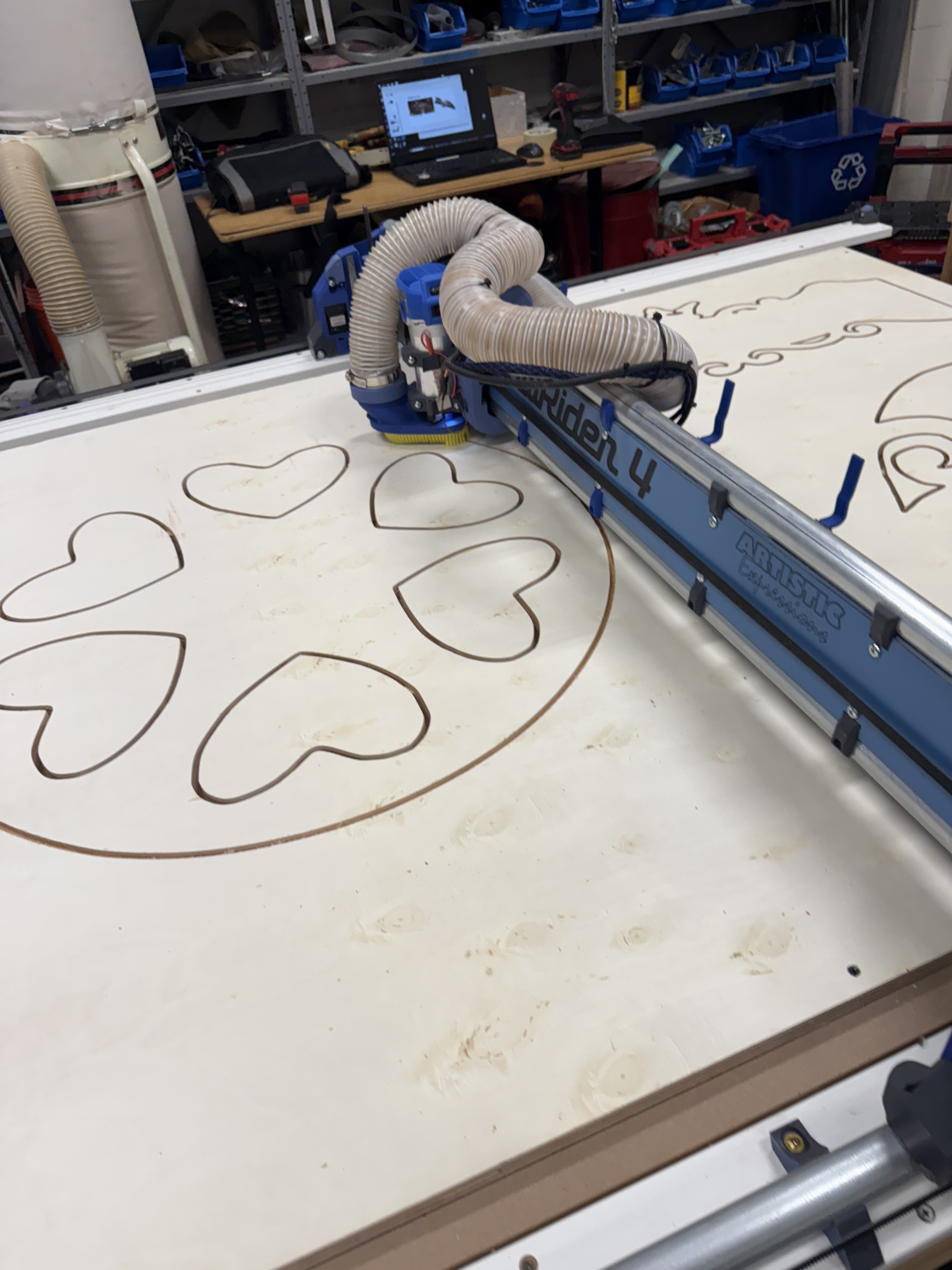

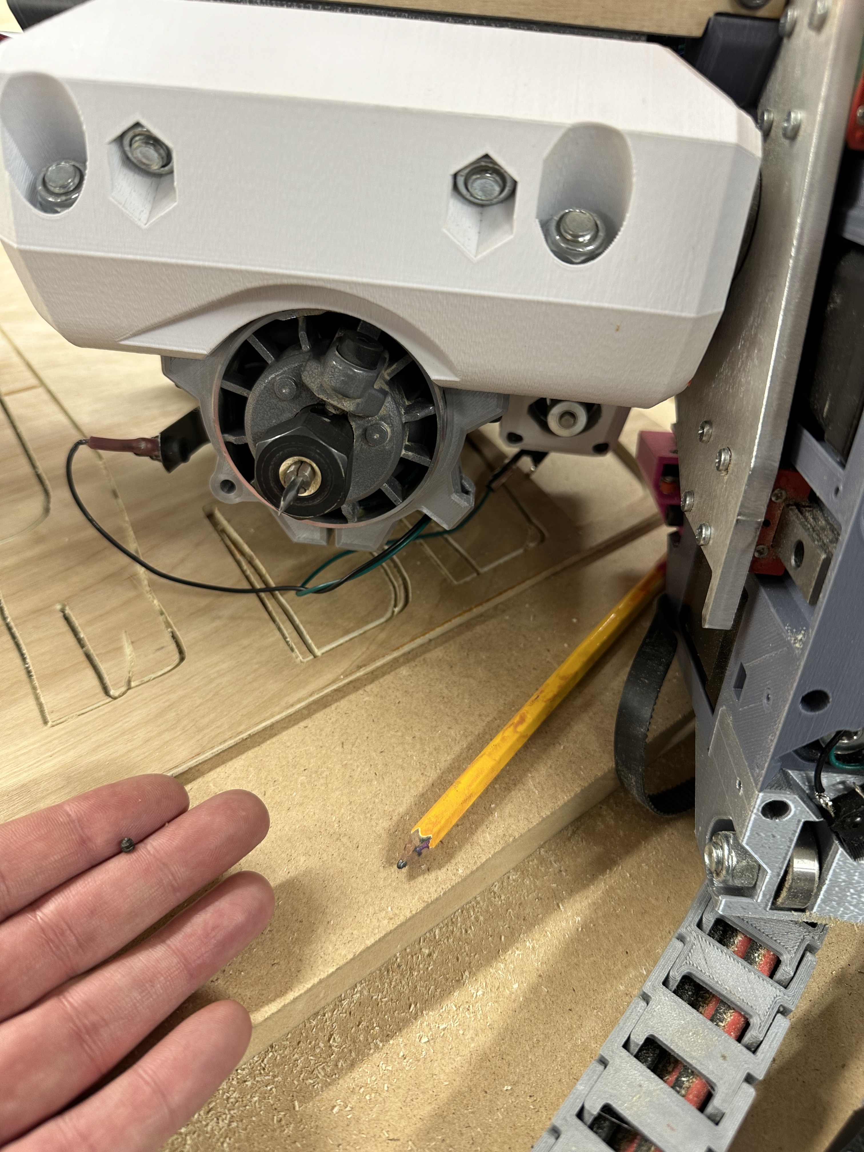

Basically… When I run 3/4 plywood, sometimes I can run a full sheet without any issues, and then sometimes it seems like on the second pass of a cut the x axis drags or bogs and steps out of line like a spirograph (I’m dating myself here)
I will try to send a Pic of a bad sheet on Monday…

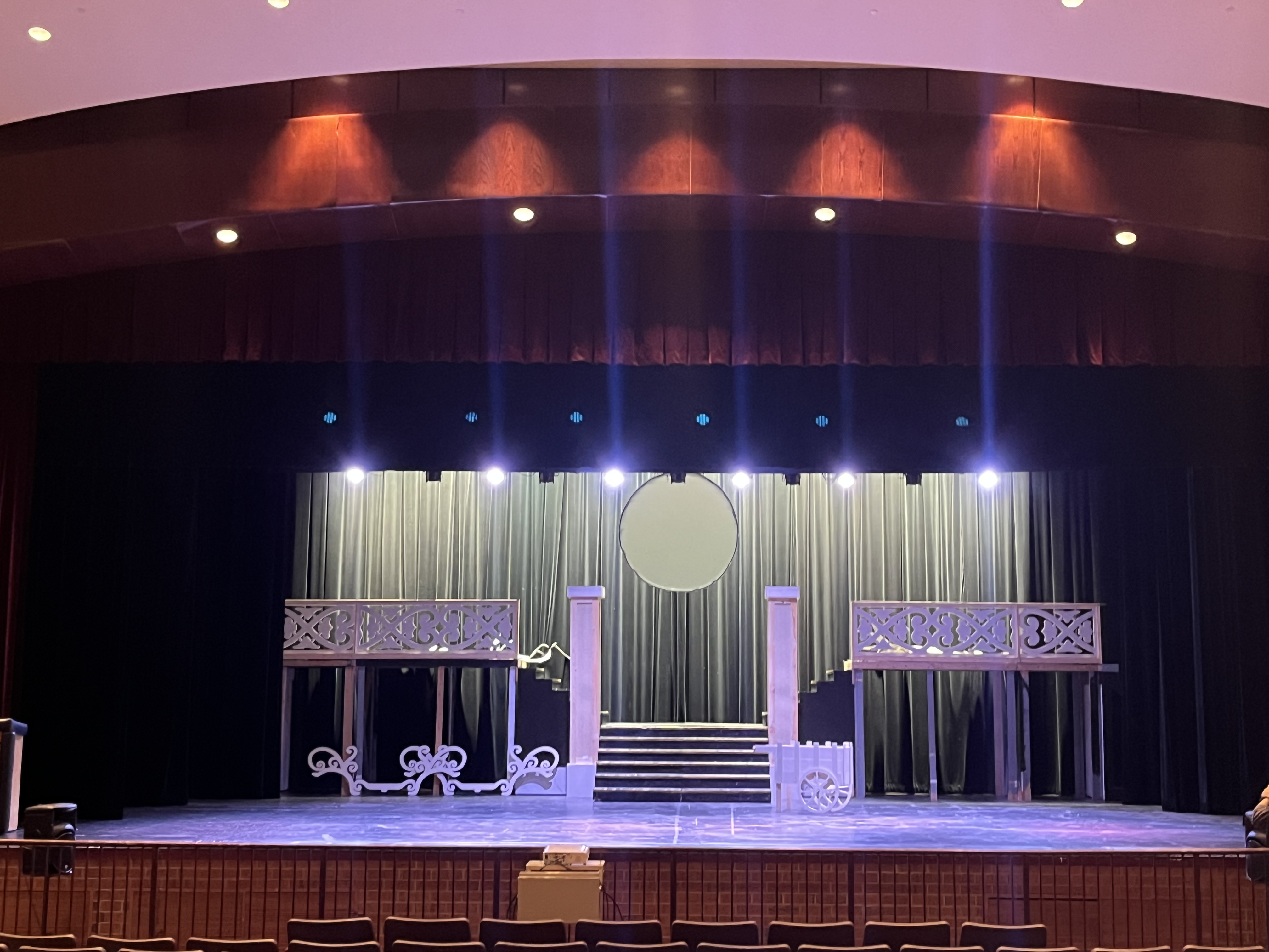

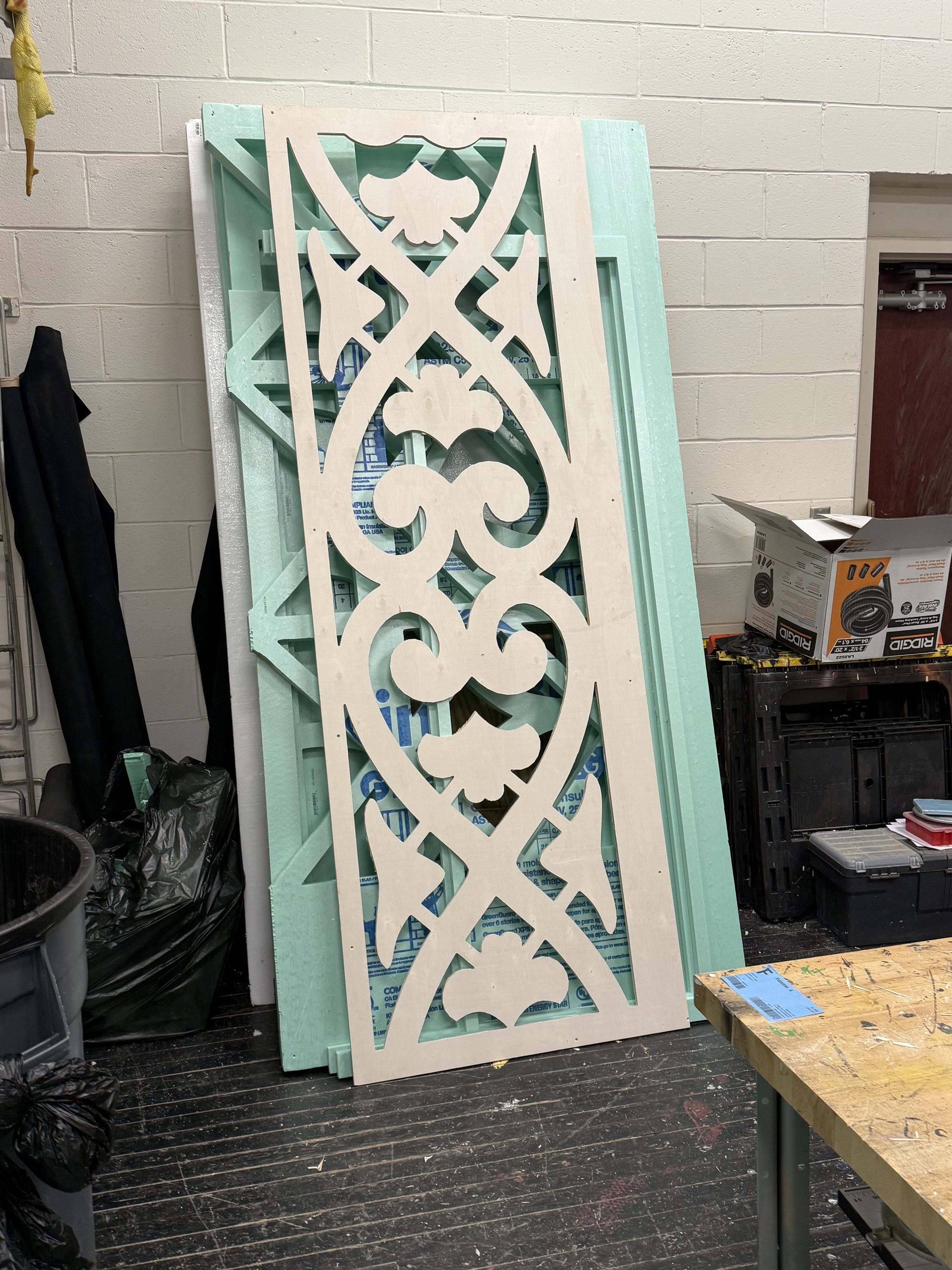

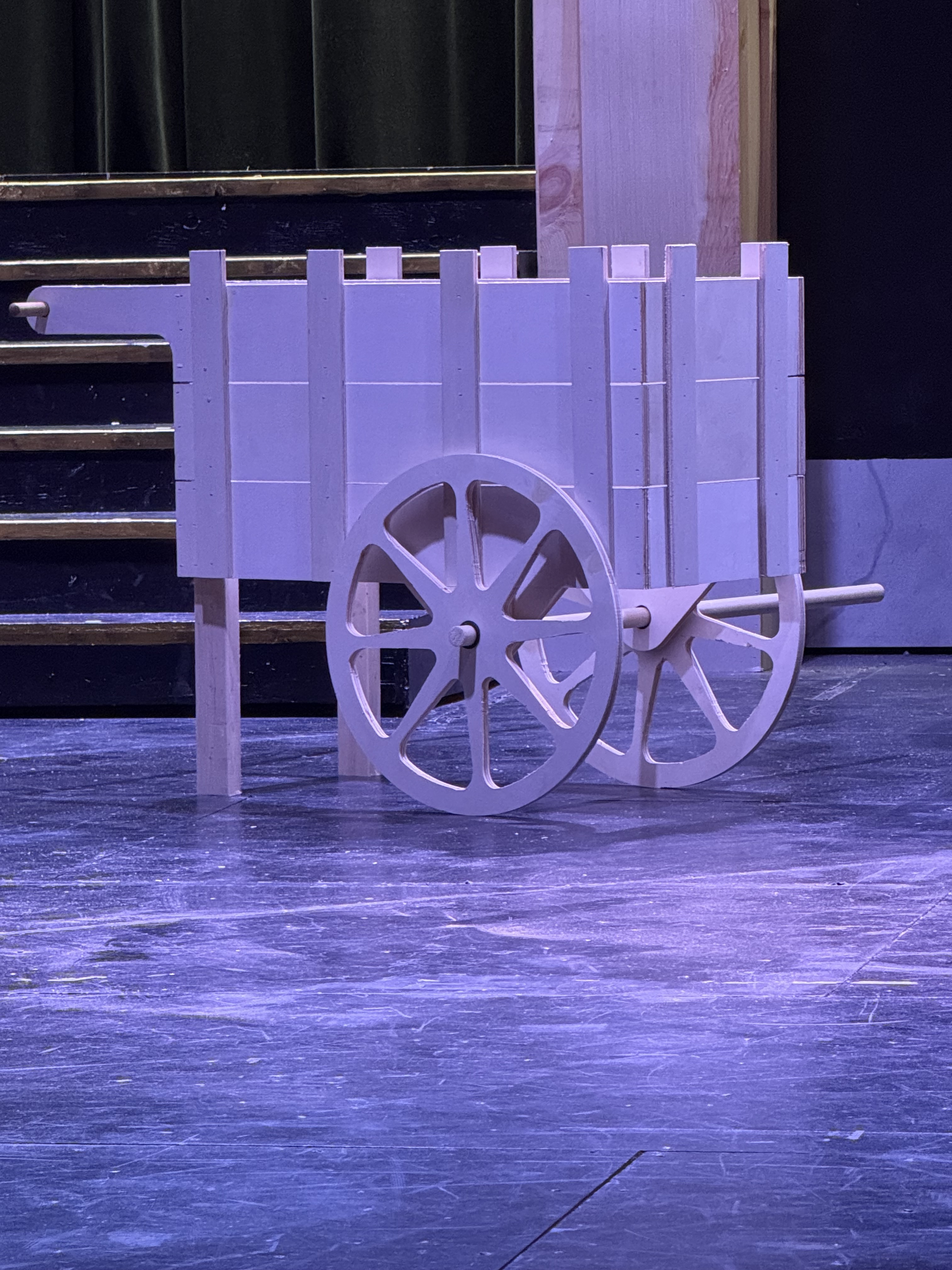

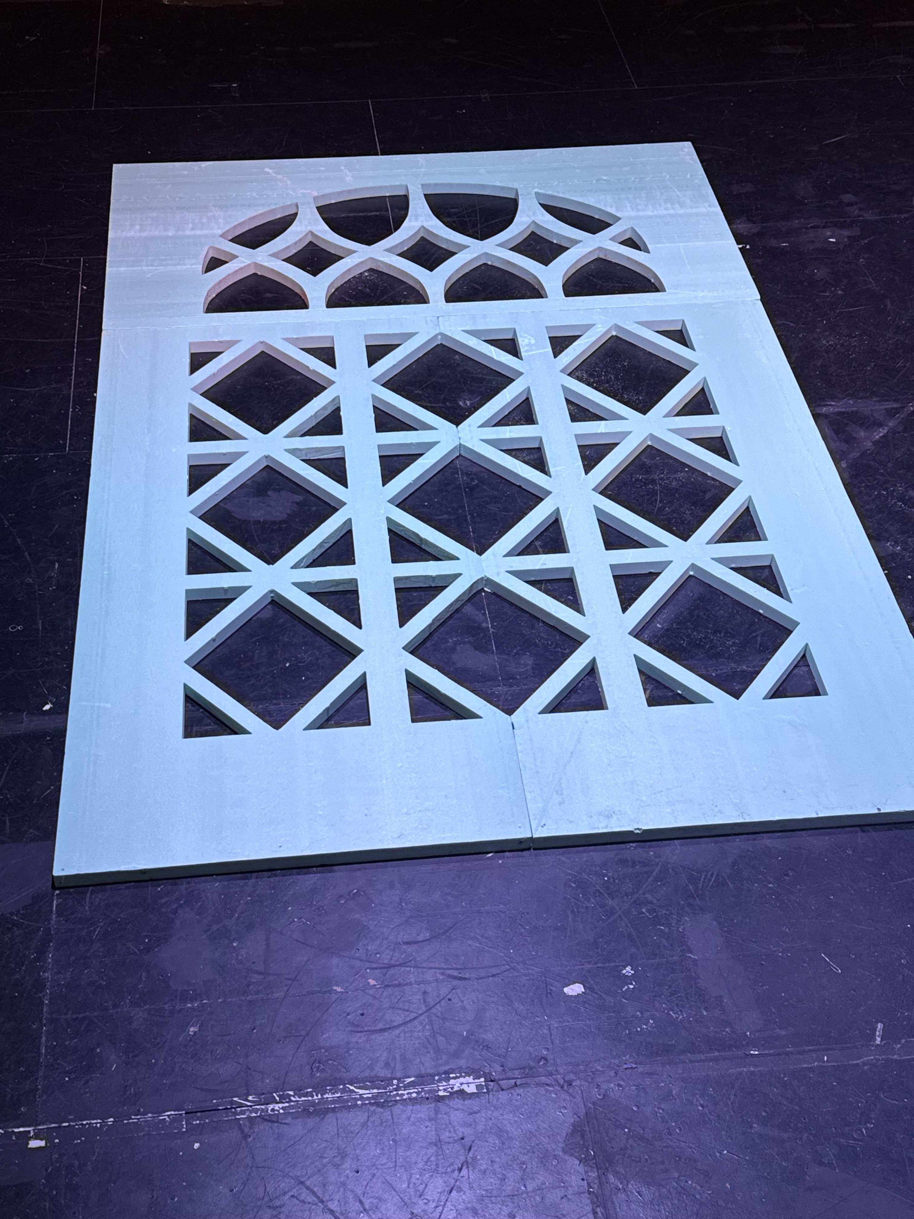

Here’s some perfect cuts…
Wow that’s a lot of work. It looks fantastic you should be proud of that! Wish I could give you some help to figure out the issue however I’m pretty new to this.
That looks awesome.

In the gcode file, I see a feedrate of 2700 mm/min (45 mm/s). That’s with a 1/4" bit and 6mm passes. That seems pretty aggressive. I know the LR4 is more capable, but that’s certainly more than I’d attempt on my LR3 anyway. Is that the same as the other files?
Note that if this worked before but is becoming an issue now, it could be that your endmill is getting dull. If you’re approaching the limits of the machine with a sharp bit, a slightly dull endmill might cause issues sooner than you might think.

My working theory is that maybe your endmill is getting dull, which caused some minor skipped steps during the first pass. (Or maybe some other reason but still skipped steps). Since steps were skipped, during that second pass, you end up needing to cut a full 12 mm for some of it since it doesn’t line up with the first pass. That would cause more skipped steps and “spiral” into chaos?
I would be curious to see a picture of the endmill after experiencing these issues.

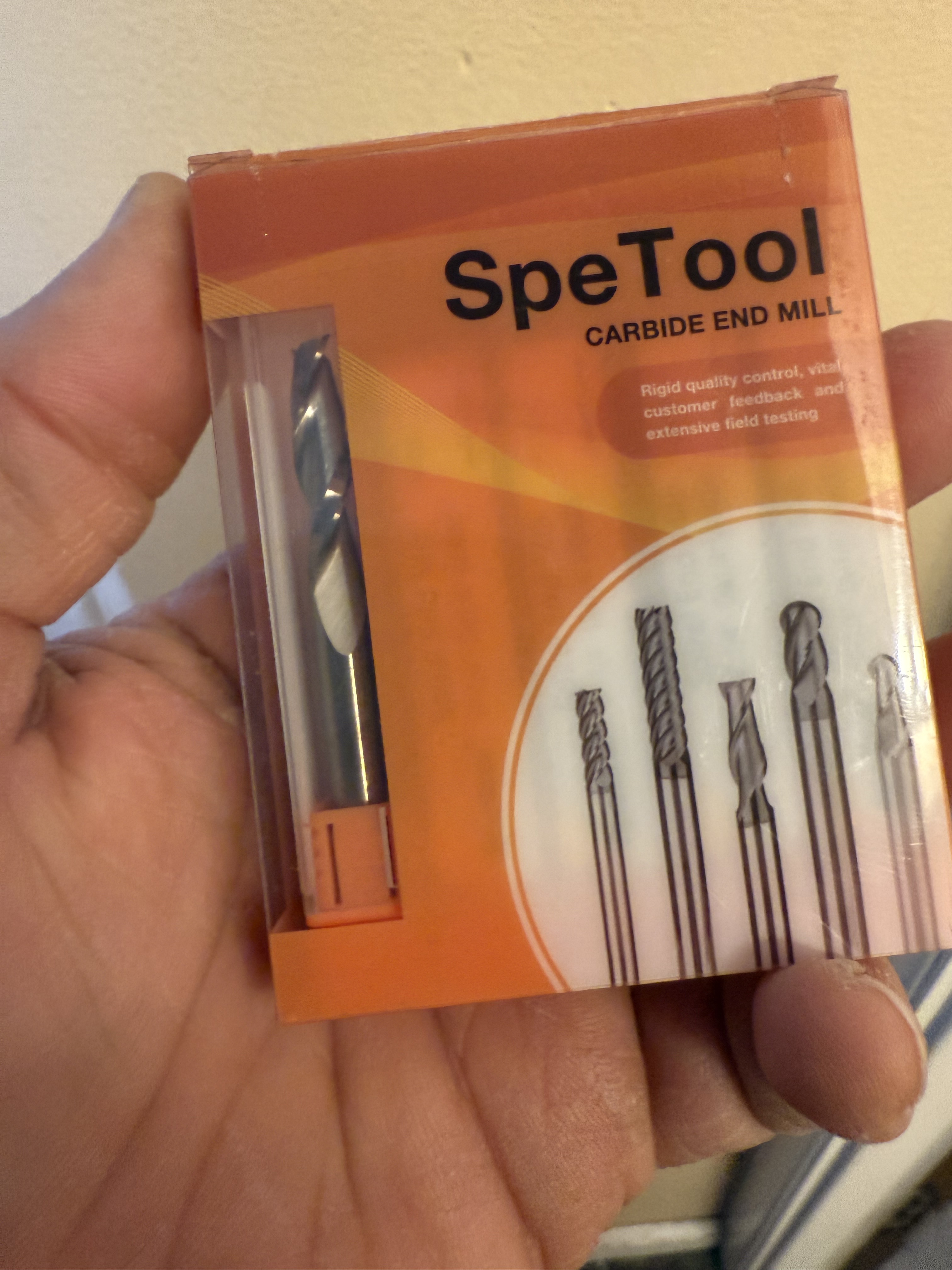

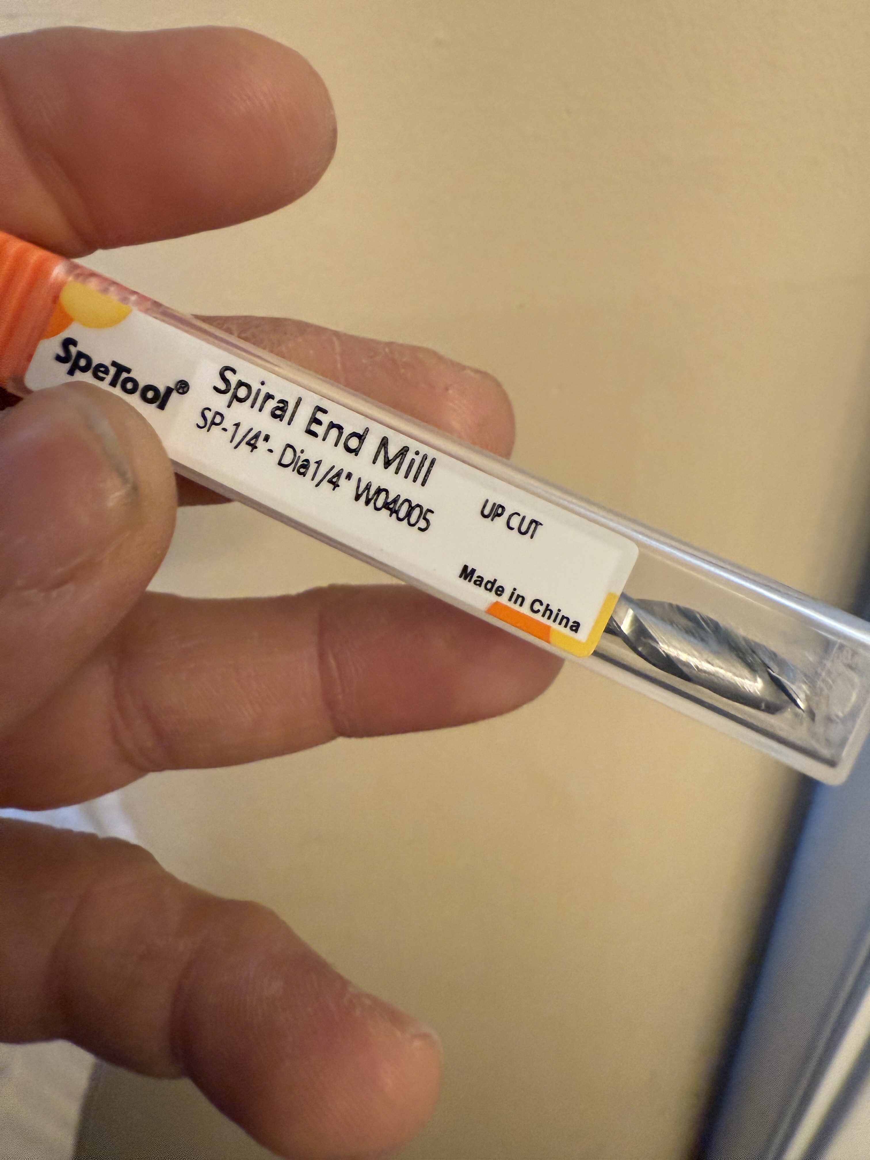

Oh and I just picked up a 5-pack of these to try… 2 flute spiral upcut… Any thoughts, experiences?
look for the amana 46315-K chipload and thats your target/initial values (do your own tests in some scrap material you have left/damaged and go up or down from there)
