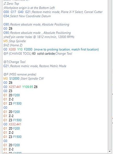

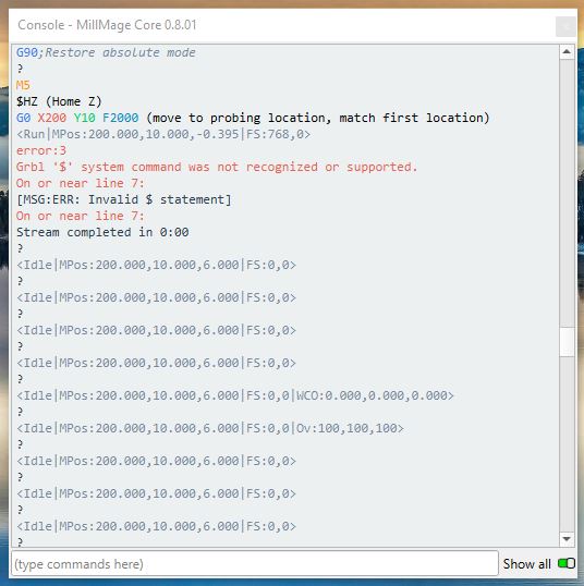

Error 3

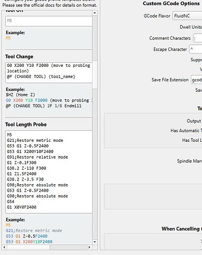

i updated firmware to 3.9.9 v1 on esp plugged it back into board
now i get this error in mill mage things we things were working fine prior to update
im lost on this one
UPDATE : i put my other esp back in which is still on firmware it was shipped with and everything works fine again
if i restart device i get this

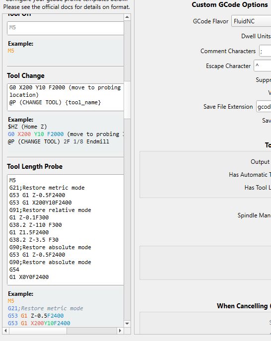

THIS is what MM told me to use for probing

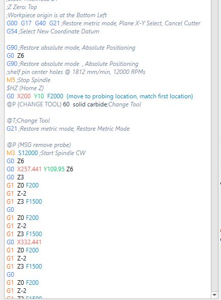

Replace $HZ (Home Z) with just $HZ. I don’t think you can include comments on lines with $ commands.
I just checked some of my old posts that had screenshots of my settings
back in sep 25 in the millmage quickstart post the (home Z) is there , and ive not had this error before
is this something that has been changed as fluid nc has updated firmware ?
as it doesn’t error in the old firmware 3.9.1
I don’t recall any related changes but I know if I enter a $ command with a comment in a terminal, I get that error 3.
cheers Jason
was that on an older version of fluid nc also that you got the error
ill swap back to the esp with 3.9.9 and remove (home z )
and see what happens
Hmm, I get the error on 4.0.2 but not 3.9.5.
def random , i get error on 3.9.9, but not 3.9.1
Yea something changed between 3.9.1 and 3.9.5. I’d just get rid of the comment and call it a day.
