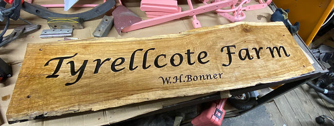

Epoxied farm sign in oak
First time milling oak, 4mm pockets with 2flute 1/4 upcut on my Lowrider2 - pingpong build text direct in estlcam, no dxf etc, as having issues with solidworks 2026.
Took it steady, and super pleased with the result. Backfilled below surface with epoxy, so could sand surface and oil and varnish after.
one very happy recipient!

Nice and bold, looks like it will last a long time, good job!
