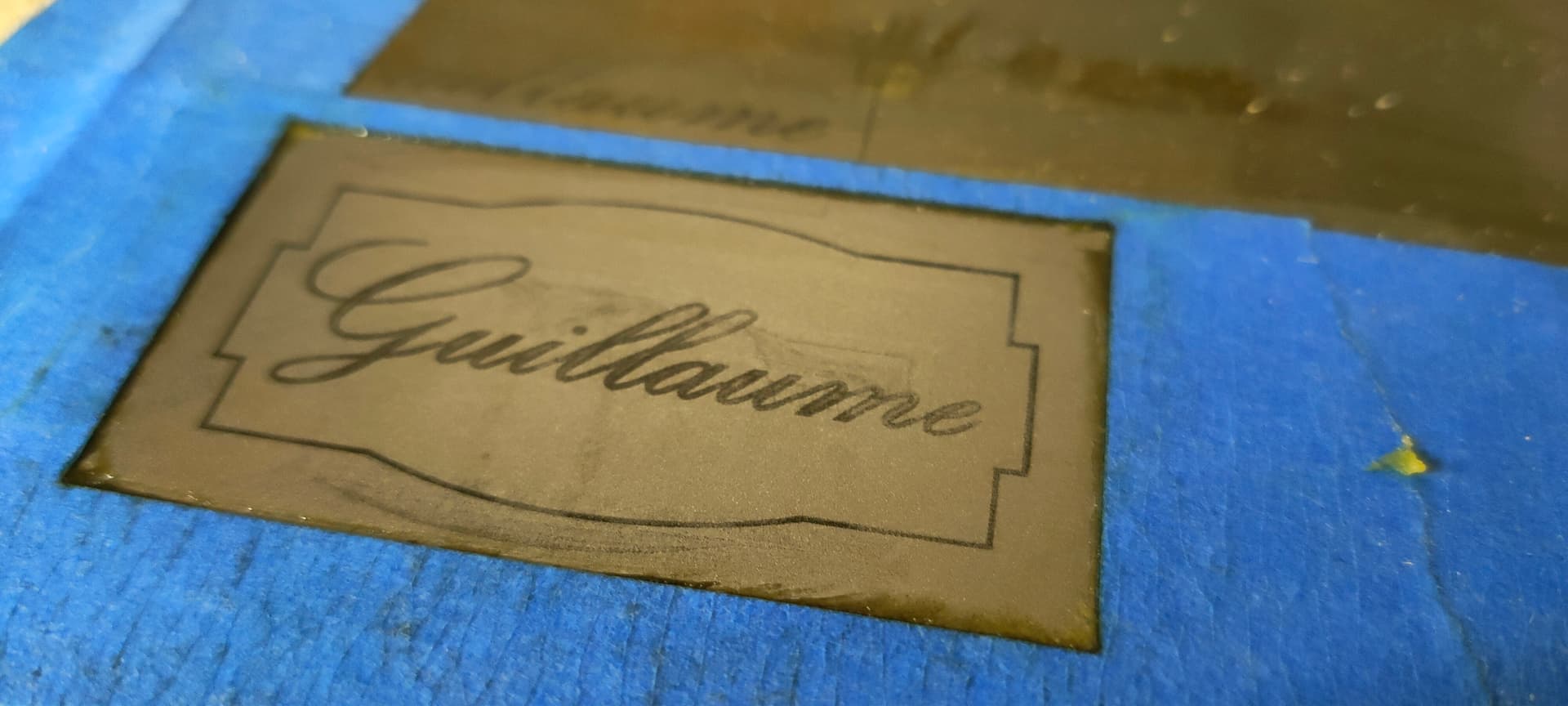

It seems my mustard coating wasn’t uniform, so for the second test I covered the mustard with tape and applied light pressure
I also switched from “English Custard” to french “Moutarde de Dijon” because why not…
This one turned out pretty well but very faint
Washing it with IPA won’t erase it though, which is great

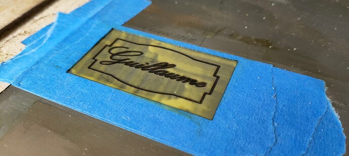

I made a third attempt, stacking a few layers of tape and cutting a window in it
Then you can apply the paste with a small scrapper to get an even layer
I didn’t take a picture of the result as it just failed to mark anything
I think the mustard layer was too thick
I’ll try again with thinner layers and let you know how that worked out, but it’s far too late now and I think I already lost a part of my mind in this :stuck_out_tongue:

Looks like “3 layers of tape thick” is the right amount of condiment…
I refilled and am making a second pass right now
Pretty happy with the result after a slow second pass
In our next épisode: “Can you laser-cook a duck?” :smiley:
What power laser and what are your work parameters for this?
This is with a 10W optical power diode laser
Seems like the mustard etched the steel a little!
