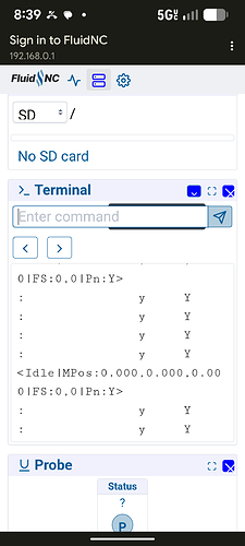

I’m at the point where I have X Y Z movements working from my phone, and I should be able to start “squaring”, but when I push the home X button, it moves about 5mm in the wrong direction, then I get the error message “Homing Failed. Pull off travel failed to clear limit switch”. FWIW, the trucks are nowhere near the end stops when I get this message.

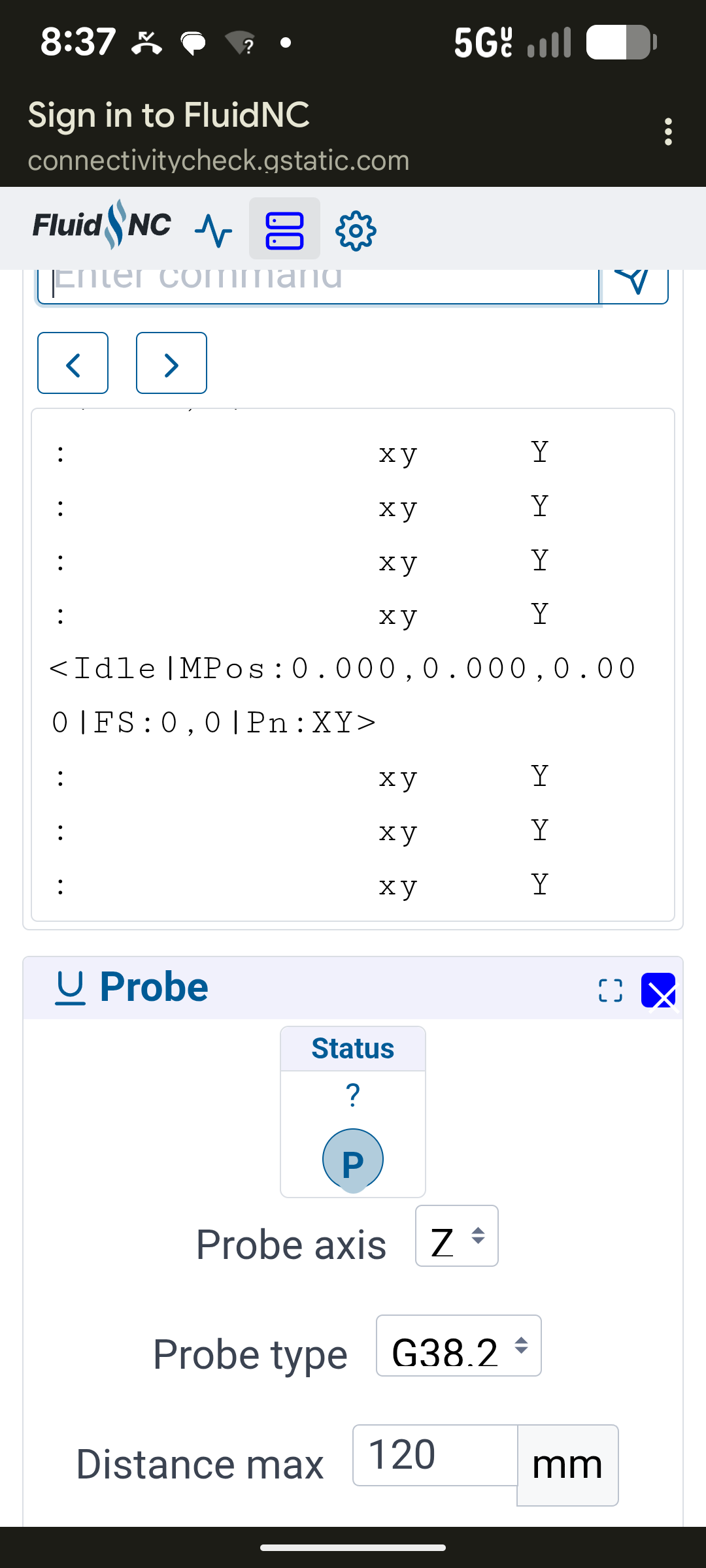

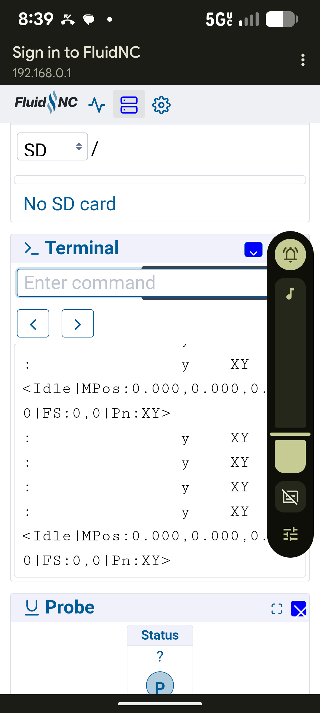

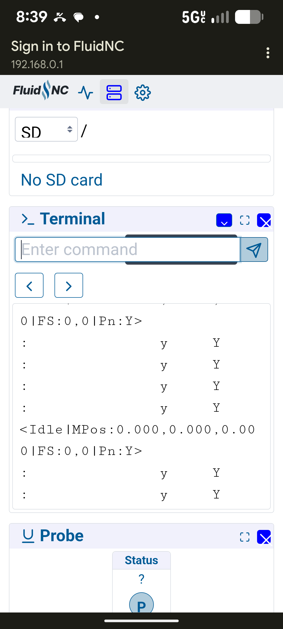

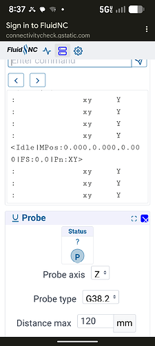

I did the $Limits test, and got these results:
No switch pressed:
X0 pressed:
X1 Pressed: (sorry, volume popped up, but it’s not hiding anything):

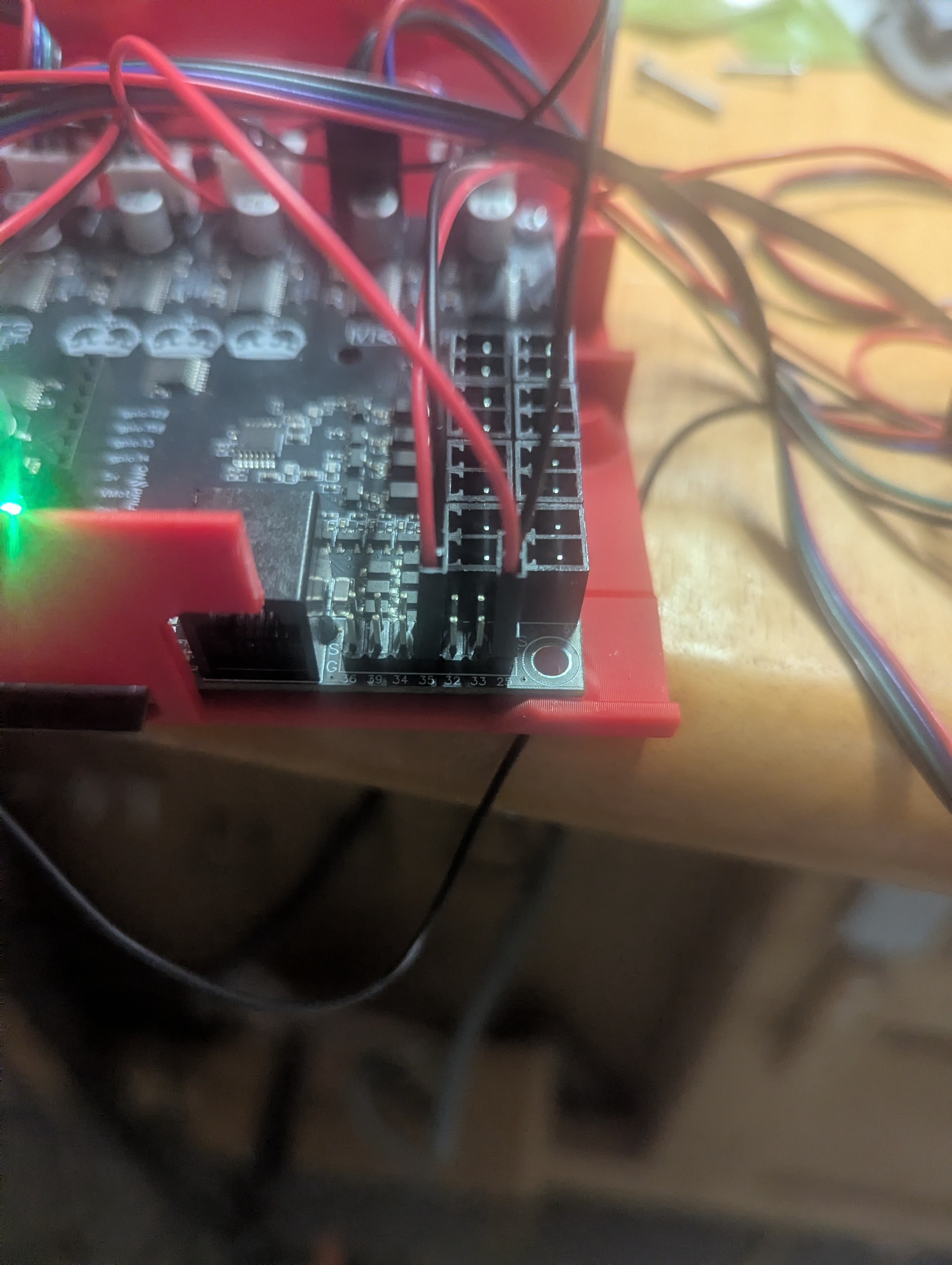

Photo of connections: Note, I have only connected the X switches at this point for troubleshooting:
Anything standing out there as the problem?

Nevermind, I figured it out, I somehow switched my X and Y wiring… I had taken all the wiring apart today to put the computer in the case and screwed it up … ooofff…
