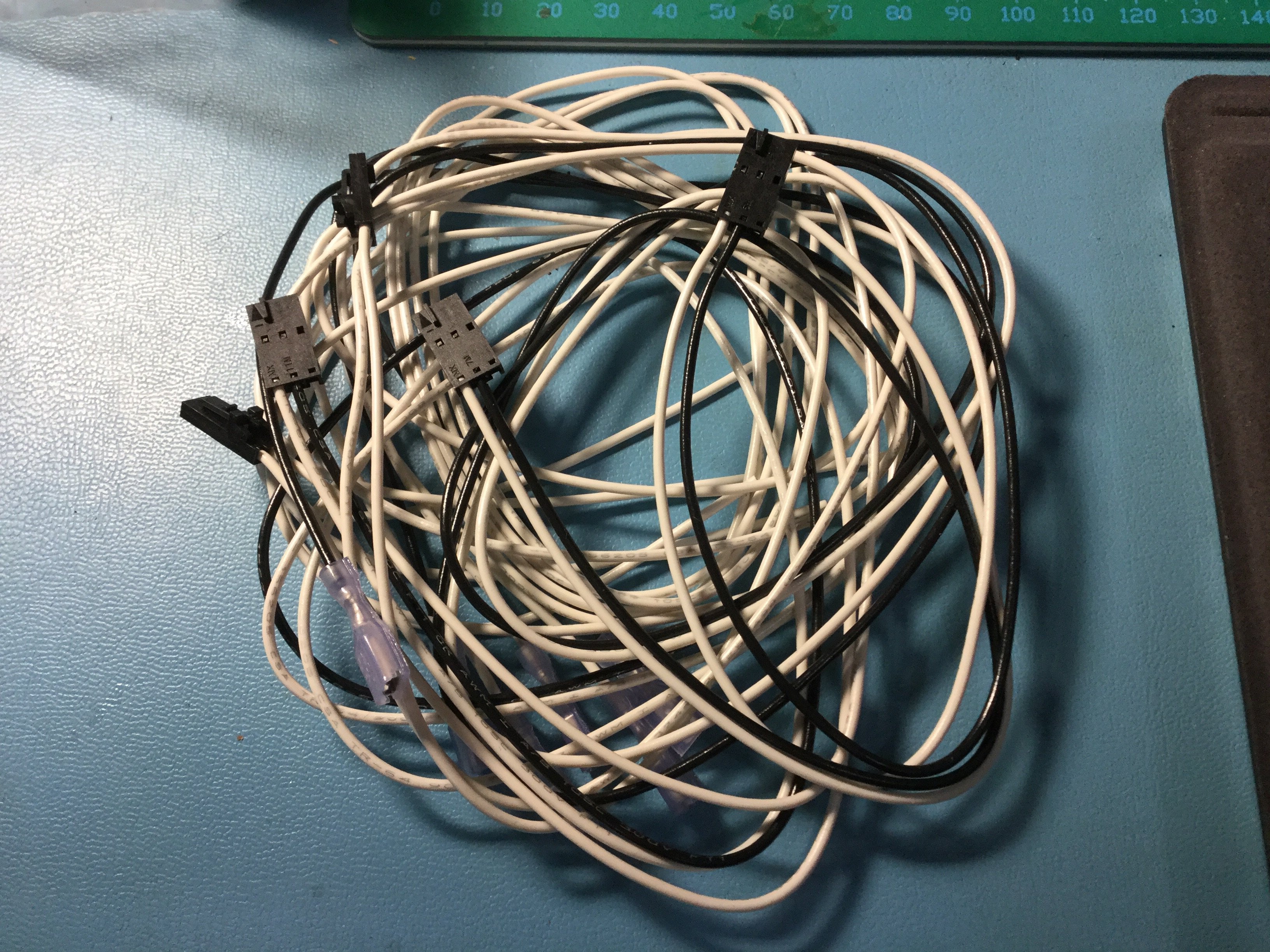

End stops I have connection COM CN NC ? Which is + - s ? min max is there a x- or x+ like does min = x negative direction? Also what’s the white and black wires for? Looks like end stops?

The wiring harness that came with the kit from you was just 5 extensions, I see you sell a easy harness though. Is that what your saying should of been in the kit? I bought the electronics kit that came with steppers , full size Rambo board etc. Are the black and white wires (I’m guessing it’s for stops)

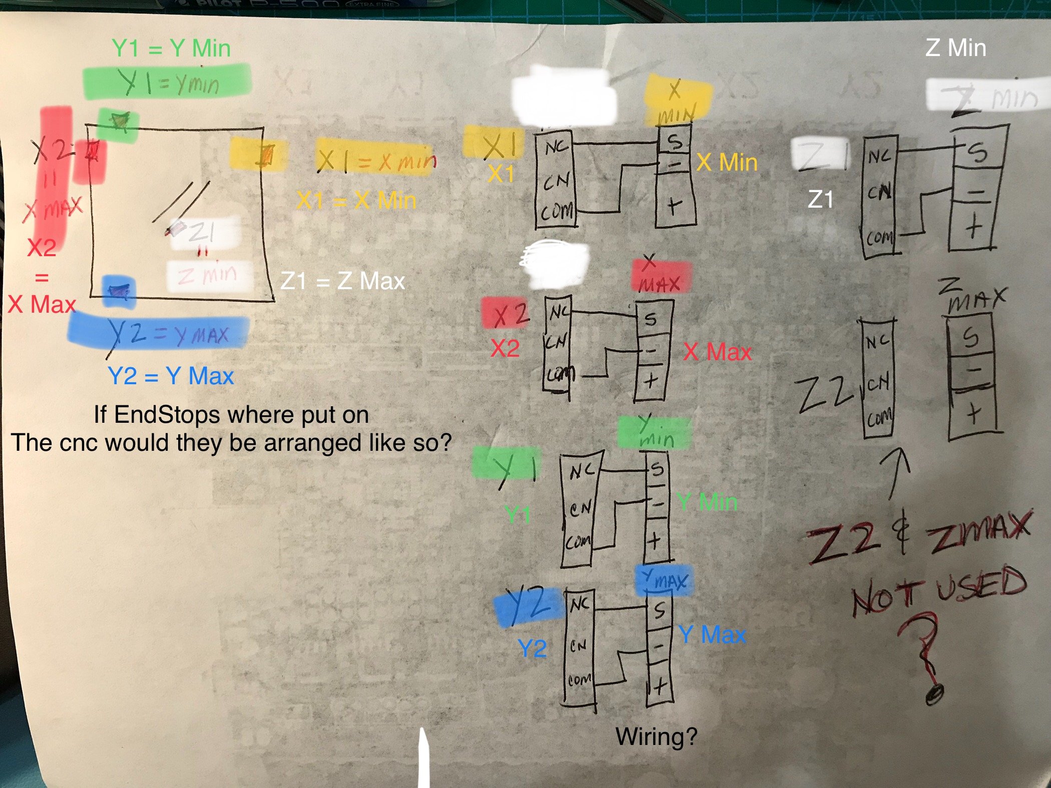

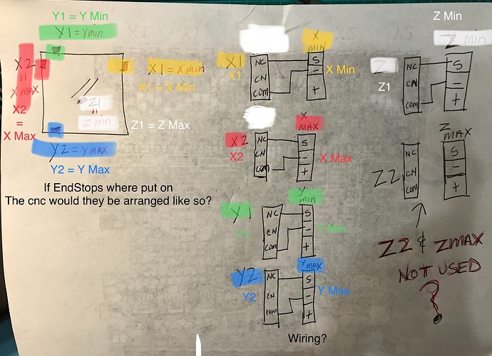

Now I’ve been researching, from what I can gather …
endstops are wired as Nc ——— S
COM——— (-) NEG
- ————- NOT USED
Now you say I still have to hook them up so if I mounted the endstops out of the way would you place them on the same ends see my picture if you can make it out.
I really am am trying to understand all this.
I wire every day at work (I supervise an electrical shop for F16s) I’m used to having a wire diagram.
I think I’m really close here though.
Sorry I forgot to answer that. Yes, your diagram looks good. I can’t tell with the layout but the x axis is typically left to right, and the Y axis is away and towards you.
Pay attention to the signal pin position on the Board they are back to back and opposite.

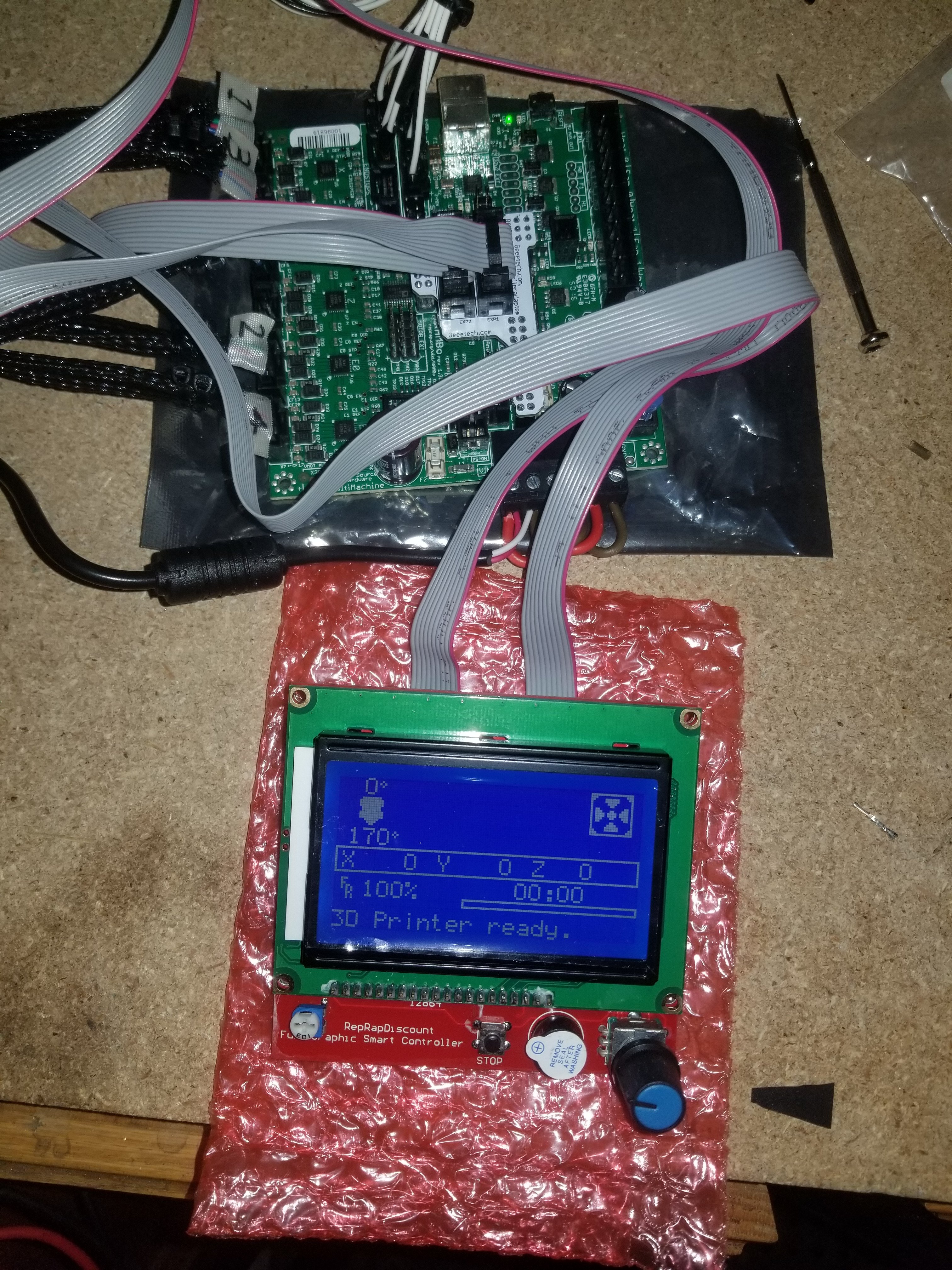

As for the LCD it depends on where you got that adapter, if you got it from me you just need to swap cables, if you bought it from somewhere else the plugs are on backwards.
You were out of the adapters so I bought the adapter from hongkong
are you saying the adapter plugs are keyed wrong by 180 degrees?
The keyways on the adapter if you look in the picture face the 15a fuse, is this wrong?
Should the lcd work without me having to install anything?
Or do I have to install the firmware first?
as I haven’t installed marlin/firmware yet on my computer …
Just looking at your adapter on your website, to then one I got from hongkong… my plugs are keyed 180degress different!
so it looks as though I need to pull the plugs off and key them and rotate the 180*
Sorry I couldn’t get back to you sooner.
Correct spin or take off the black “sockets” I heat them up a bit with a hot air gun and they come right off. Or you can just force the plugs in there, I think they will fit backwards.
You are freaking amazing thank you so much for your help I switch them plugs around and it worked like a charm !
Sweet. This adapter is the only problem I see with the rambo boards, or maybe I need to start looking into a different type of screen.

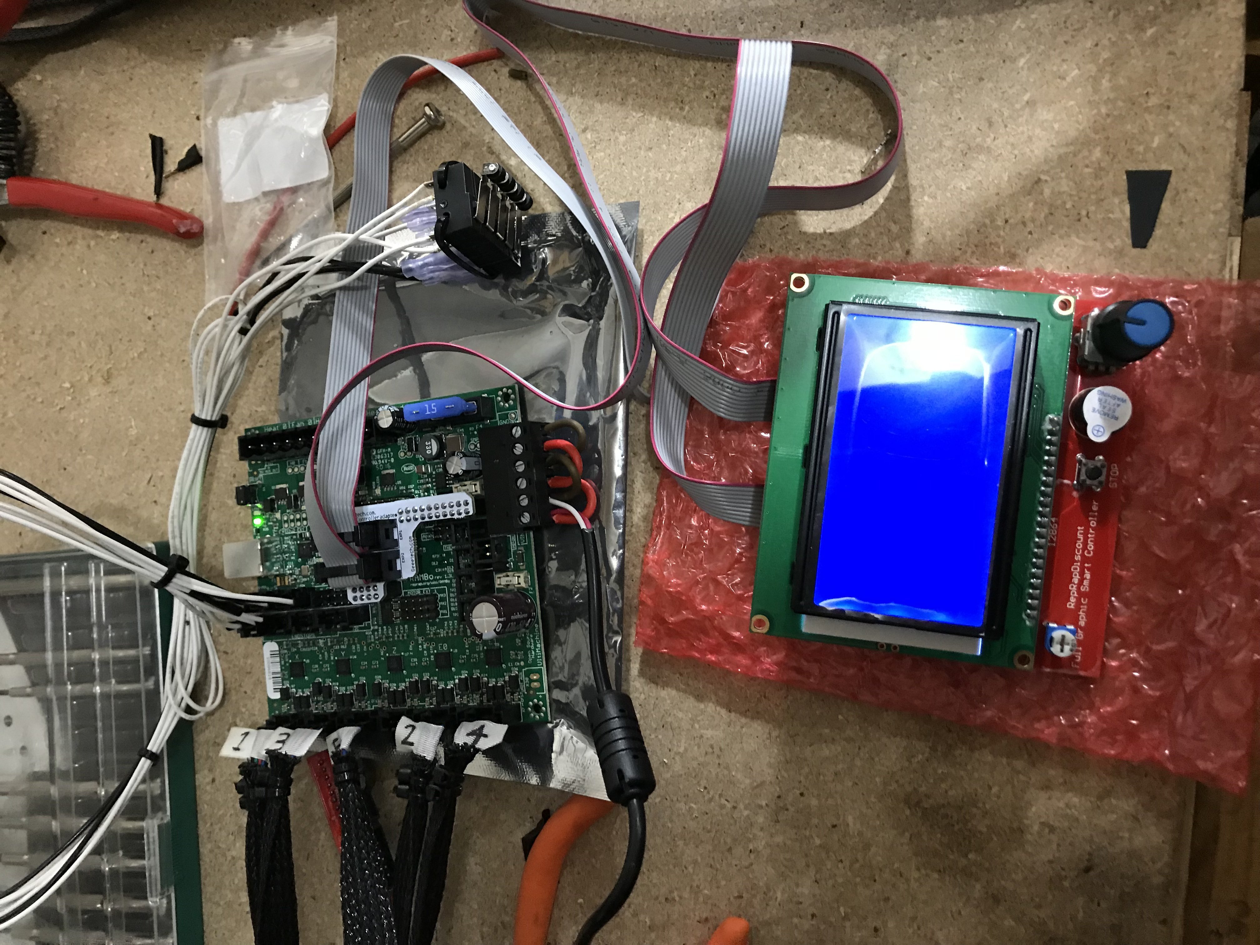

Paul, Thanks for the pic of your board wired up. I tried to mock assemble mine in the basement Christmas weekend (a total failure, broke a few parts and hit a wall with setting up the RAMBo board) and was very unsure of how to wire in the power from the kit. Once I get mine moving around with the computer I might look into that screen as well.
