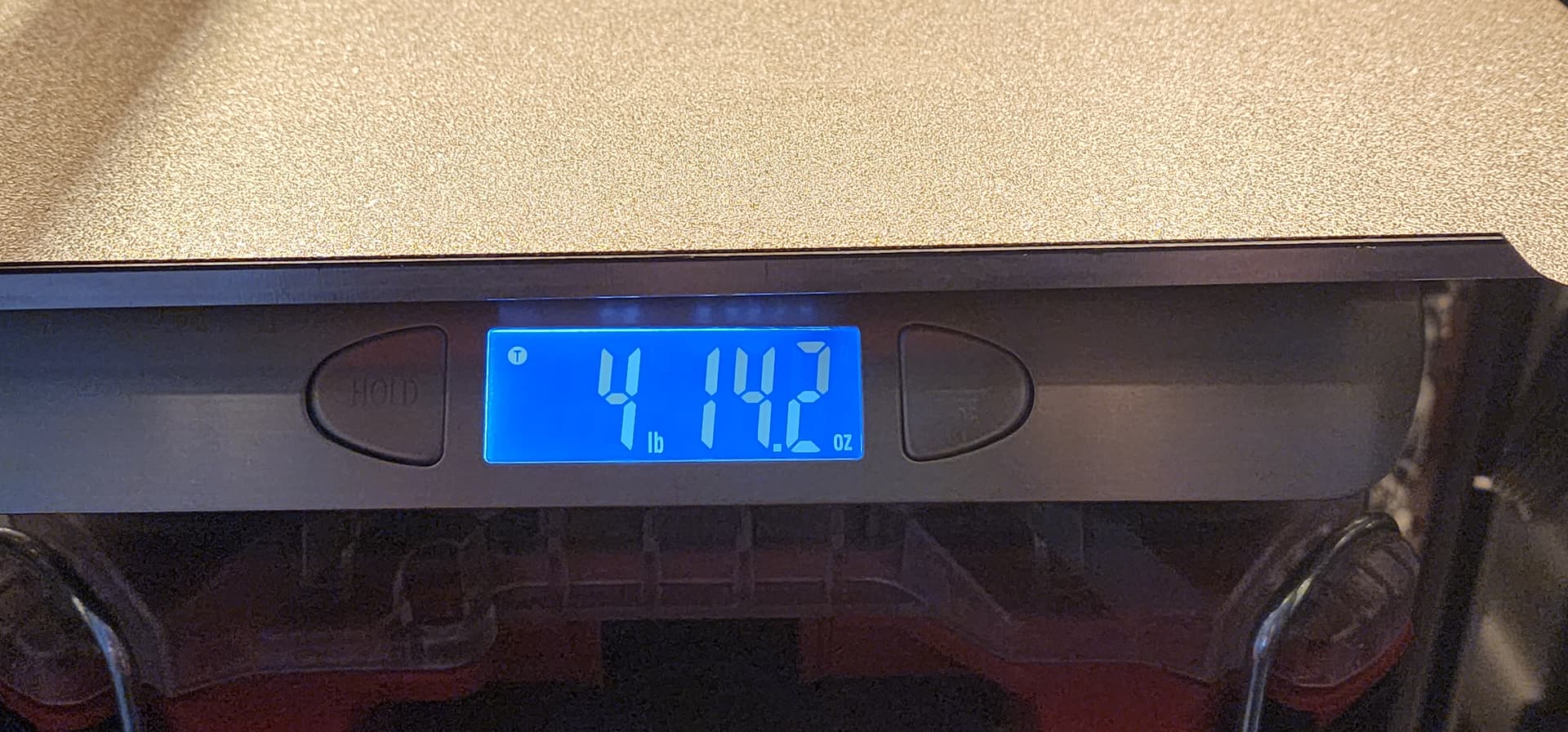

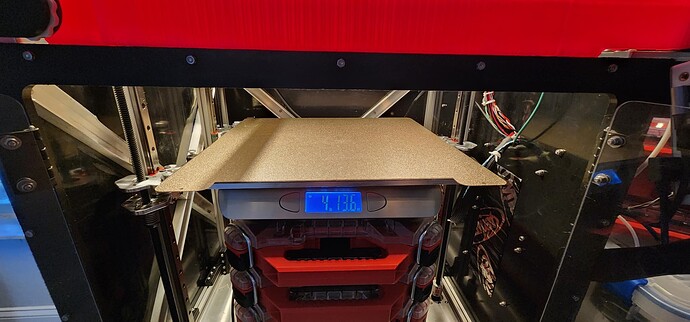

my 350X350 1/4" mic6 with heater, mag sheet, flex plate, and half the wobble wing bearing mounts.
What we are finding is you still can kill it, but it takes a lot more. JJ’s printer can handle a little more than 8lbs dropping on three steppers, but 12 gets it over the top. So the chip can probably handle one stepper no problem, probably even 2, that third one is just taking it over the top.
Thank you!! Shows how much of our current weight is the steppers.
Okay so I actually weighed one of mine last night as well. I got about 3 lbs for a 200x200 V4 bed assembly still on the printer. When weighing everything separately, I got between 4-5, so in my mind the 3 rails and the 3 steppers’ friction/detent hold more than 1 lbs, less than 2.
