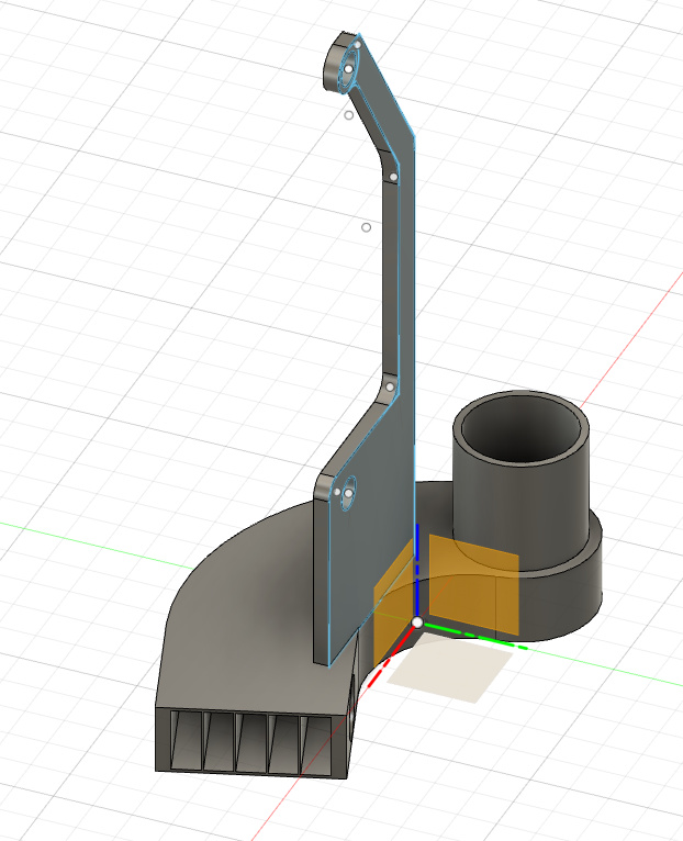

I now have a working prototype that fits most of my objectives I set out in advance.
  1. The dust extractor system is modular and connects to the Z Axis core (not the gantry).
  2. It allows different head adaptors to be easily designed and added.
  3. It allows different work heights using different height head adaptors.
  4. It allows the Z probe to be used easily as the head adaptor can simply be pulled off and changed in secs.
  5. It connects to the core Z movement, not the gantry, so the hose doesn’t introduce torque (or at least a lever effect).
  6. Works with a Katsu/Makita router which is wider than a dedicated CNC router. It can actually fit any router though (within reason).
  7. It works with a 40mm OD/32mm ID hose. This hose routes around the back of the gantry and doesn’t take any space up. This is the size of the Henry vacs which are popular in the UK.
  8. It uses 16mm magnets to hold the head adaptor to the base. These are cheap and powerful.
Here’s the Fusion 360 view
and a view of the first head adaptor
Here’s a picture of the actual prototypes with magnets,
This is the unit that will stay permanently on the Core.
This is the base plus a straight head adaptor. The silver disks are the magnets. They are strong enough to hold a substantial weight.
And this is it on the dummy core I built to prototype it all together.
You can see the hose attachment at the back. This doesn’t reduce the working area of the CNC which is nice.
There is also another head adaptor that drops the height down by 7.5mm if you have a lower work height. My intention is to have different heads for different work heights. Also the hole in the adaptor is for a Katsu/Makita sized router, it would be trivial to make a smaller hole. I haven’t printed this yet, but it’s about 30 mins work to design different height sizes from the main Fusion 360 design. I’m doing a 12.5mm one as well.
I need to test the brushes I have to see how much I can get away with in height variation, but at the cost of 46.04g of filament (approx $1) plus two magnets, plus some brush material, it’s no big deal to have a wide range of them, especially as they take seconds to change.
All pieces are printed in one go, so no joining anything together (magnets excepted), and no supports needed on my Ender 3 Pro.
The next job is how to work out how to attach the base plates to the Z axis easily without having to dismantle it all. Mmmm.,…

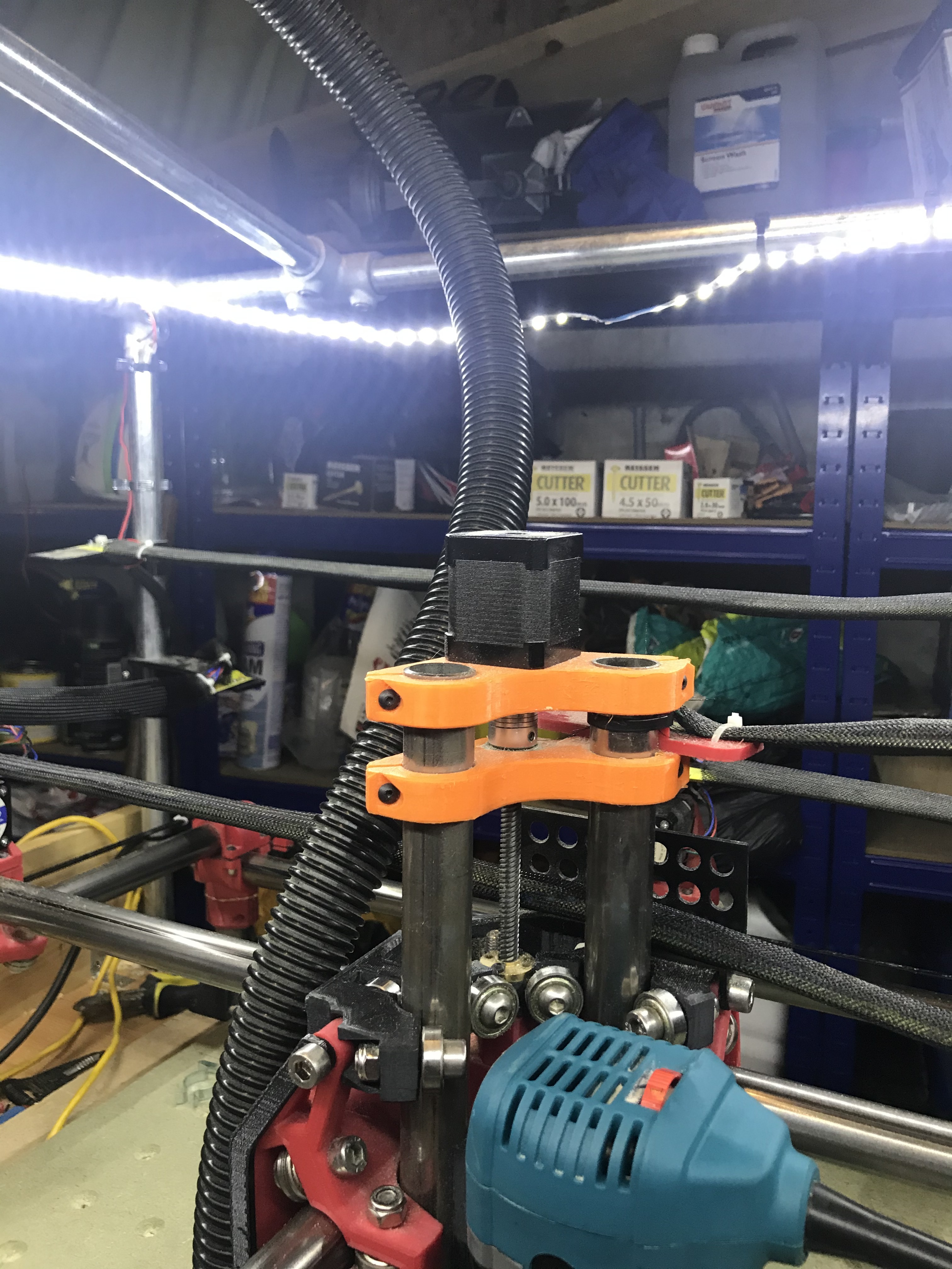

I’ve now attached the dust shoe adaptor to the Z axis and attached hoses to the base.
Somewhat surprisingly it actually fits together. The magnets hold the front very neatly and firmly but I can change the height adaptors in seconds. I’ve now made height adaptors for every height from 0mm to 15mm at 2.5mm intervals.
I’ve hooked the hoses up and am trying to route them to put as little leverage on the Z-axis as possible,
I’ve used red surgical hose (catapult hose) to tie the 40mm pipe on to the super structure frame, the natural curve of the hose keeps it mostly upright and there is little weight or leverage BUT there is some and I want to try and minimise it.
This is experimental and is a first effort. No idea what it will look like in a weeks time.
I’m interested to know how do other people route their hoses to reduce friction and leverage. I’m certainly not the first to do this.
Any ideas welcomed.
Thanks
Rob
Cool to see your vacuum idea working. It is well thought out. I elected to attach my hose to the top of my enclosure centered over the spoil board. The YouTuber Winston Moy used a hinge on the side of his enclosure and an arm off the hinge to keep his hose over the top of his router. I thought that was an interesting idea.
Wow. Looks great.
I have the router power cable (and will eventually route a dust hose) routed across a horizontal piece of 1/2” conduit that can swing over the work table with ease. The conduit elbows into a vertical piece held to the corner of the work table by two loosely connected conduit straps on the table leg. The vertical pipe rests on a stop block at the bottom. This allows the router to swing the arm over effortlessly when it moves.
