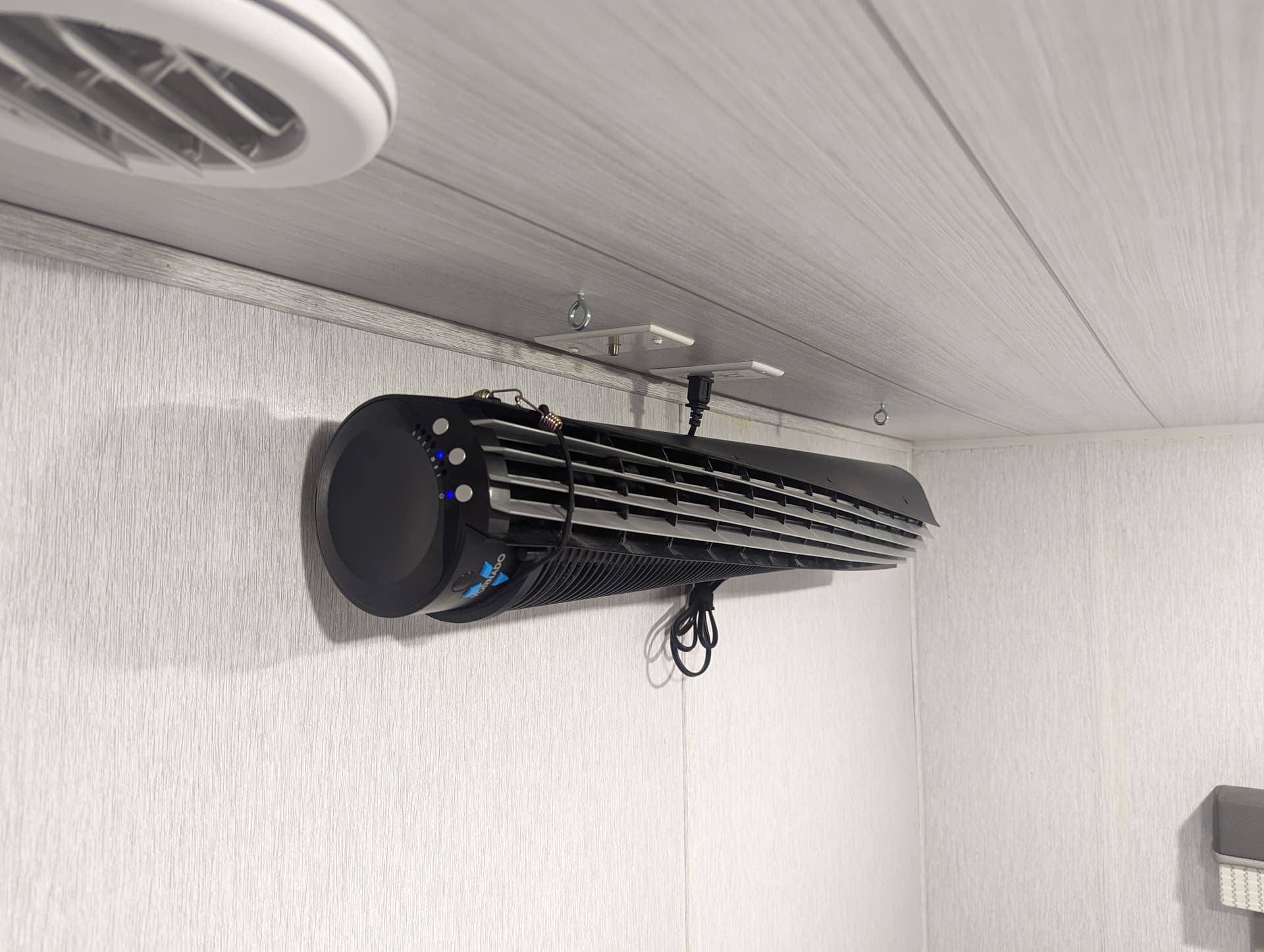

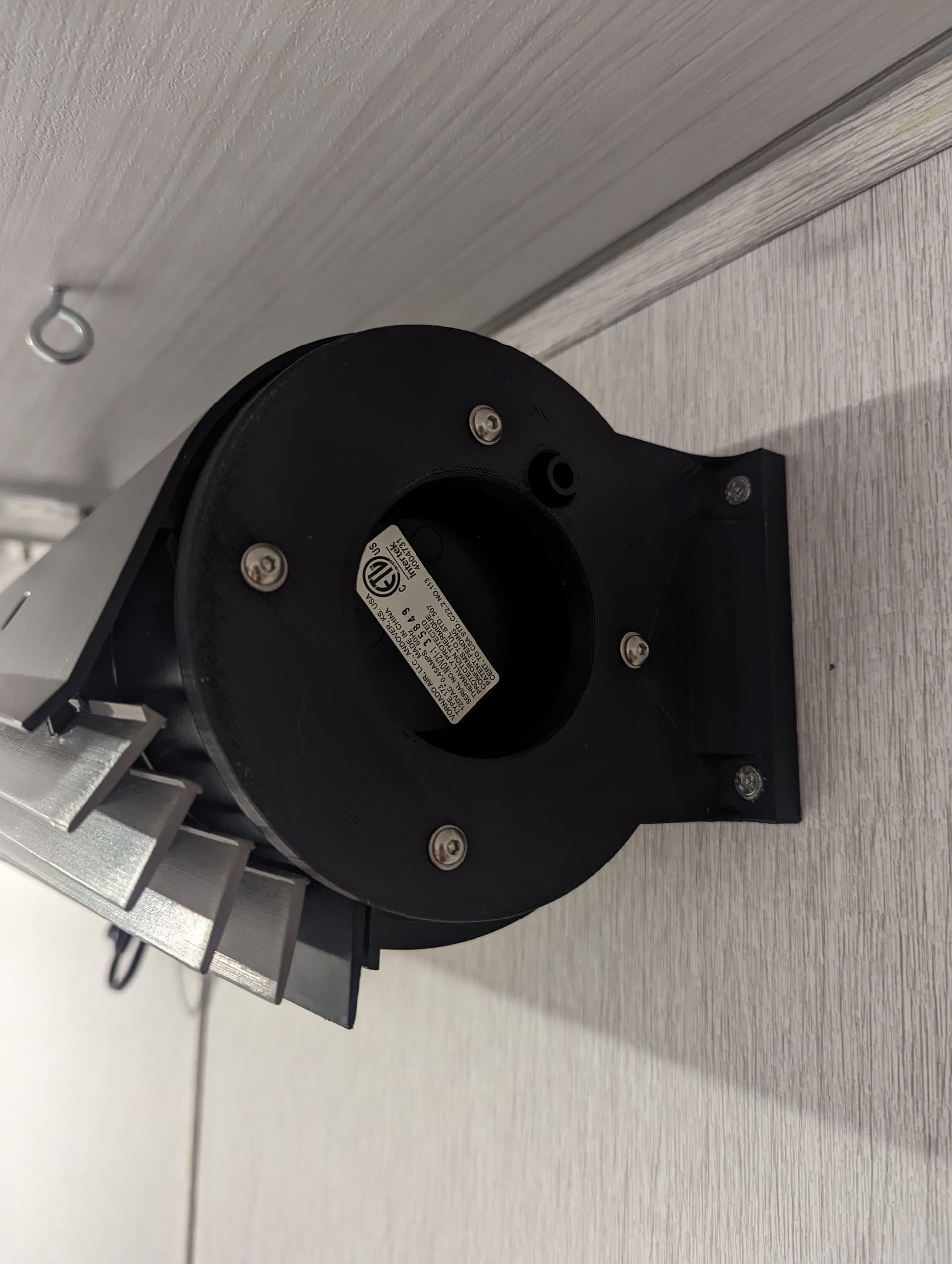

I’m working on a wall mount for a floorstanding vertical fan.
The designers of the fan have a removable stand on the bottom. Great! I can use that to mount one end of my mount.
Sure.

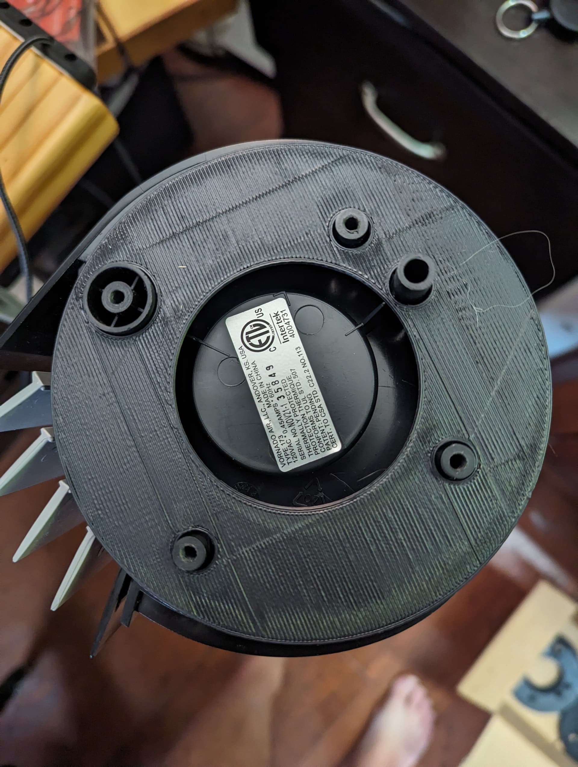

9 iterations later, I think I finally have the holes lining up. None of these holes are directly across from each other or even at the same distance from ‘center’ of the device.
Oh. And the base isn’t an actual circle.
What I ended up doing is making a circle template large enough to go around all the holes. Then use offsets from the outside edge to get a starting point for each hole. Lastly I picked one hole as the reference point and measured the distance from it to the other holes to move them around their circle to the correct location.
The first 3 holes lined up perfect first try. The last two holes took maximum effort

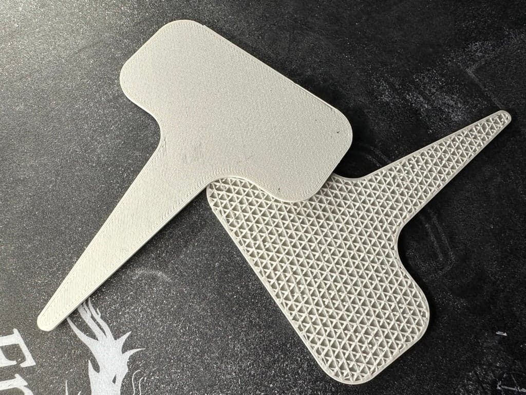

Here’s my pile of test pieces.

I did finally get the test piece to fit.

Good idea. I did 1mm test prints. Most tests took 5-10 minutes to print.
I finished the parts. I need to adjust the one on the left to add more support.
