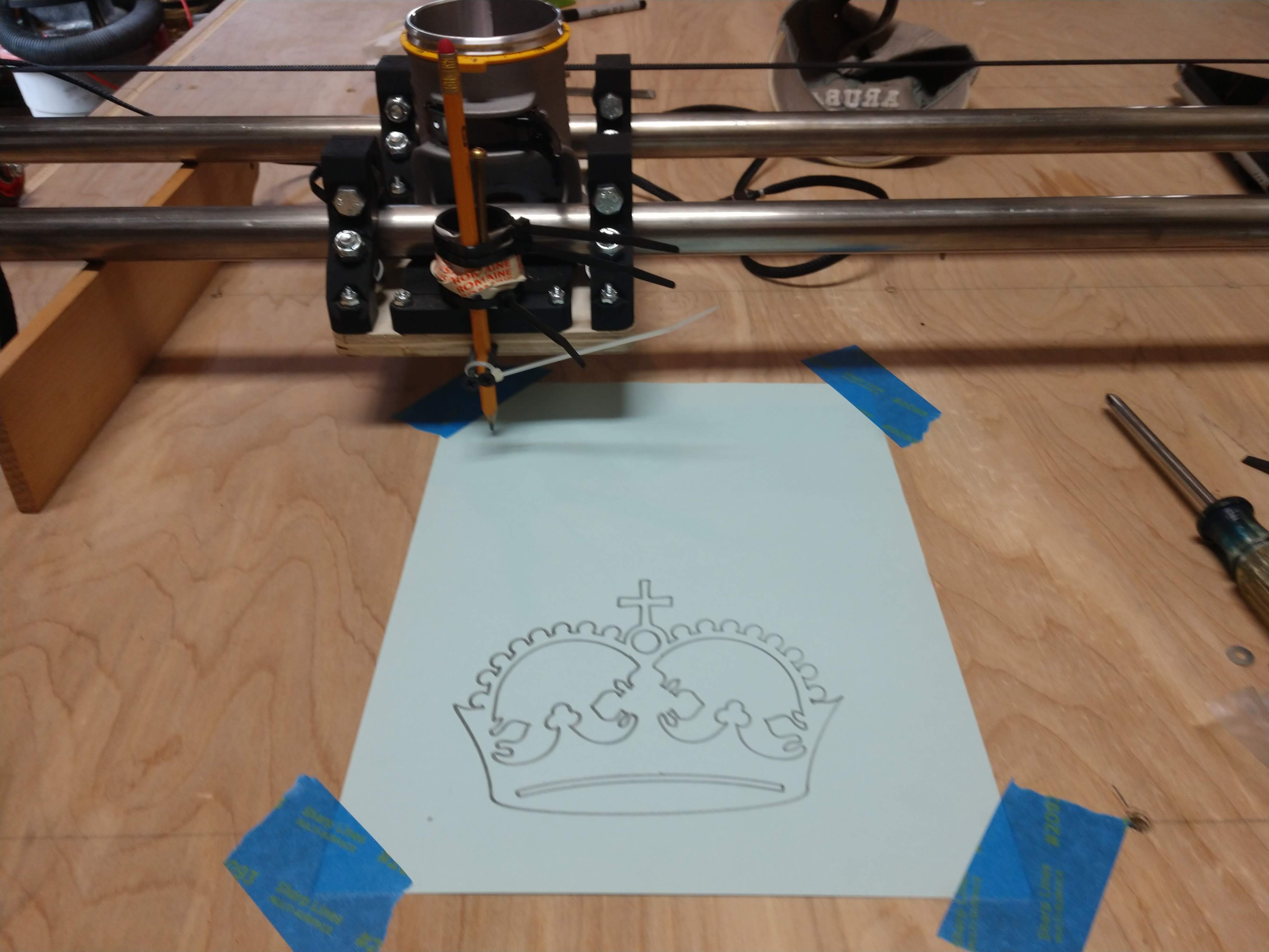

I got it now!! See all end stops and connected find. I’ll be updating once the package from V1 arrives. BTW how can I get the crown to test this baby?
Thanks again All!!!
Just type test crown into the forums, and it makes a link for you :slight_smile:
Tequila for everyone!:confetti_ball::tropical_drink:
Check this out! Yea yea yea!
I am ready to mount spoil board and start cutting. Thanks again everyone for your help and support! More later :sunglasses:

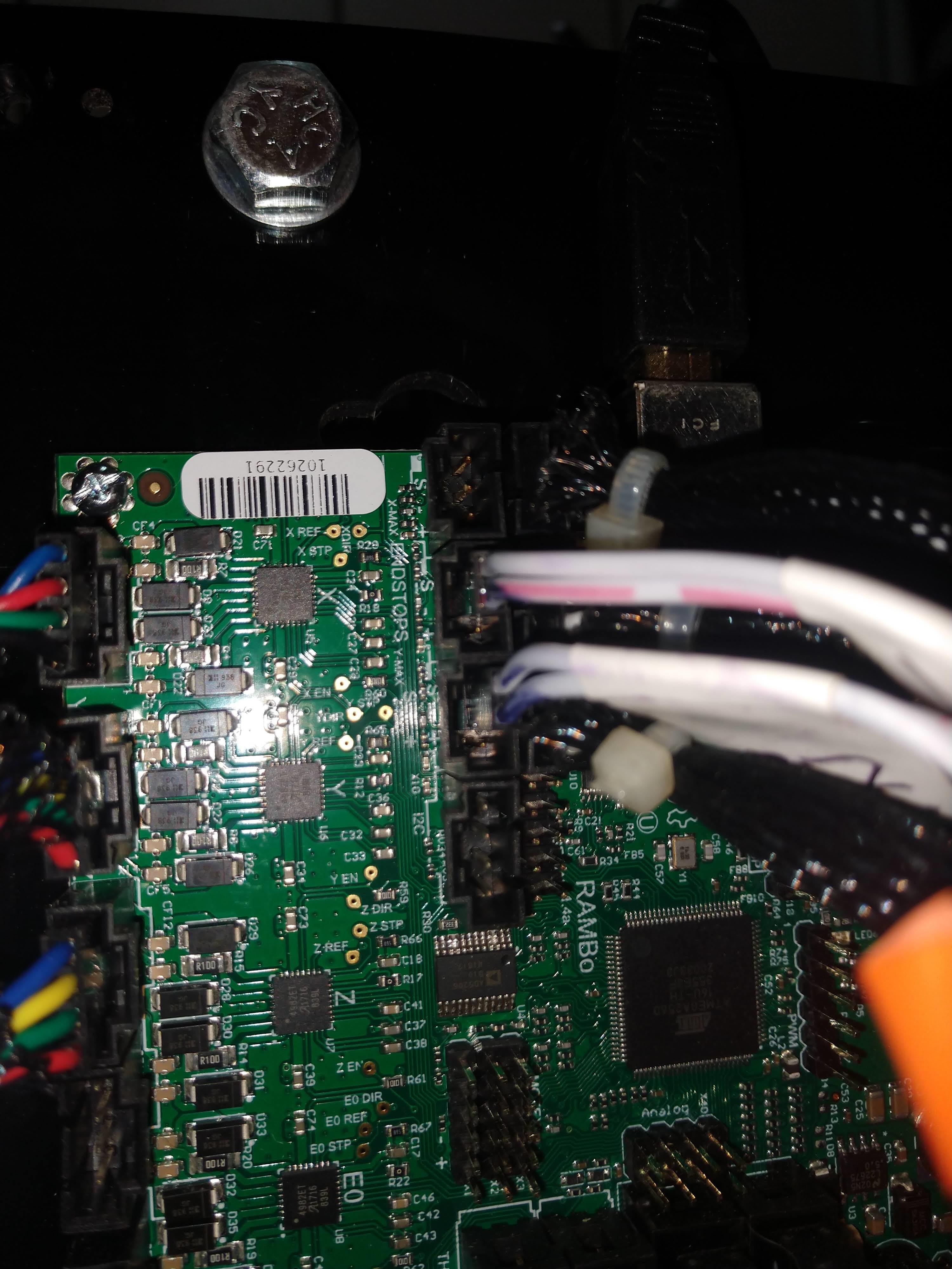

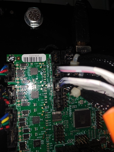

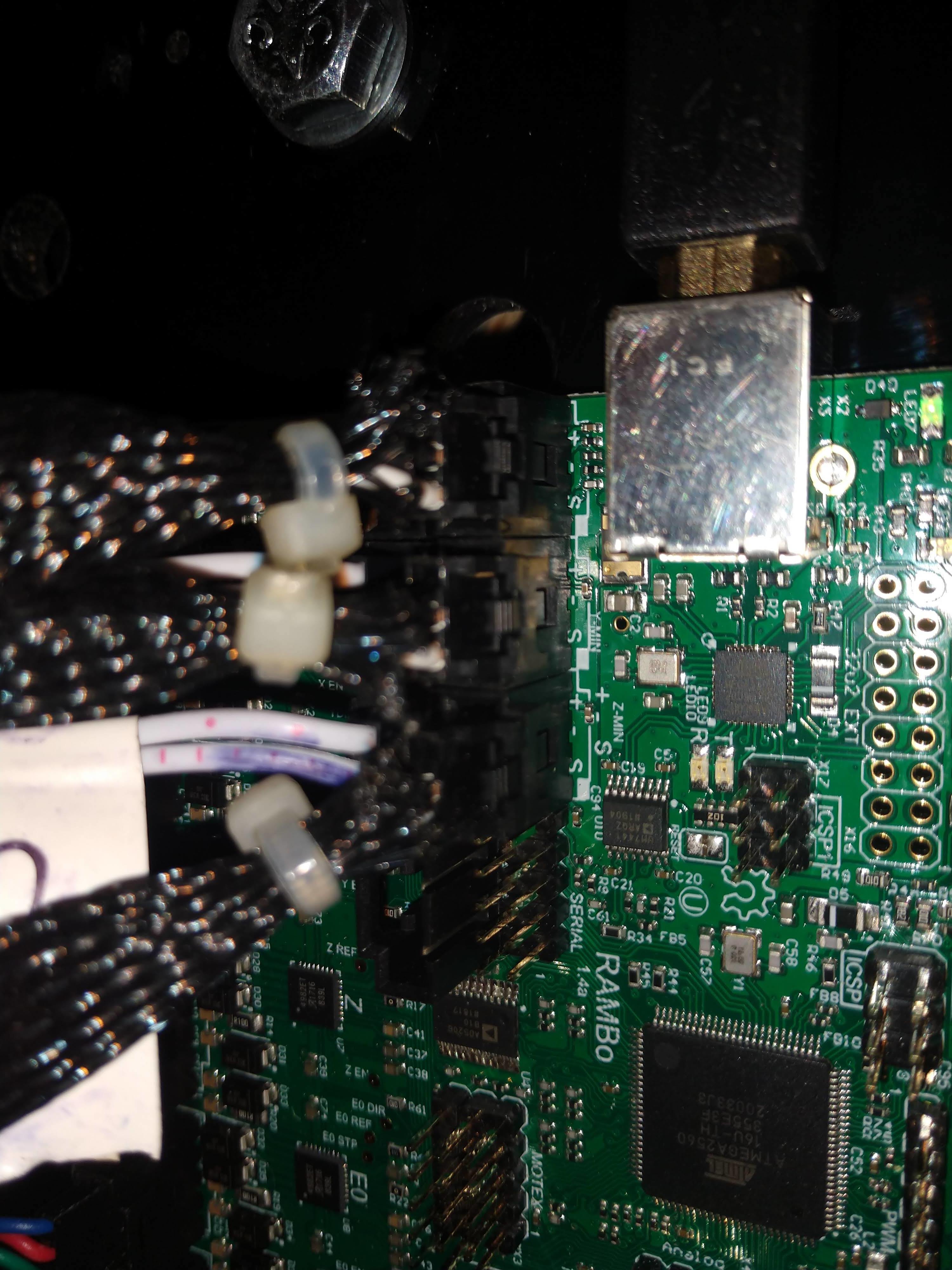

Question: I don’t see Z Max when doing M119 Command?
Any thoughts?
16:42:22.324 : Reporting endstop status
16:42:22.325 : x_min: open
16:42:22.329 : x_max: TRIGGERED
16:42:22.329 : y_min: open
16:42:22.329 : y2_min: open
16:42:22.329 : z_min: TRIGGERED
16:42:22.329 : ok
I am using 5 switches
Z1, Z2, X, Y1,Y2
Thanks
Interesting. I’m not sure why it shows x_max either. I would have expected that to be z2_min.
Here are pics of connections
I’ll send config shortly.
Configuration_adv.zip (72.1 KB)
The physical connections won’t affect which fields are set in that printout. I can peek at your configs to see.
