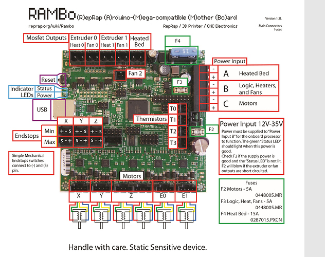

I have all my endstops hooked up and recognized now on my full Rambo 1.4, I’m just changing a couple of things on them. I really need ZMax squaring and a Z touch plate for the workpiece. Dual YMins and an Xmin would also be useful for some of my multi day cuts etc.
Does the rambo have this capability?
In the diagram attached it shows 6 total plugs for endstops. I just couldn’t find anything on the forums where people use all 6.
In Pins_rambo.h I see this starting at line60. Would I just use that X_Max_Pin for my Z probe? How do I change this? I’m still trying to wrap my head around this code, but I’ve got everything else working it seems so far.

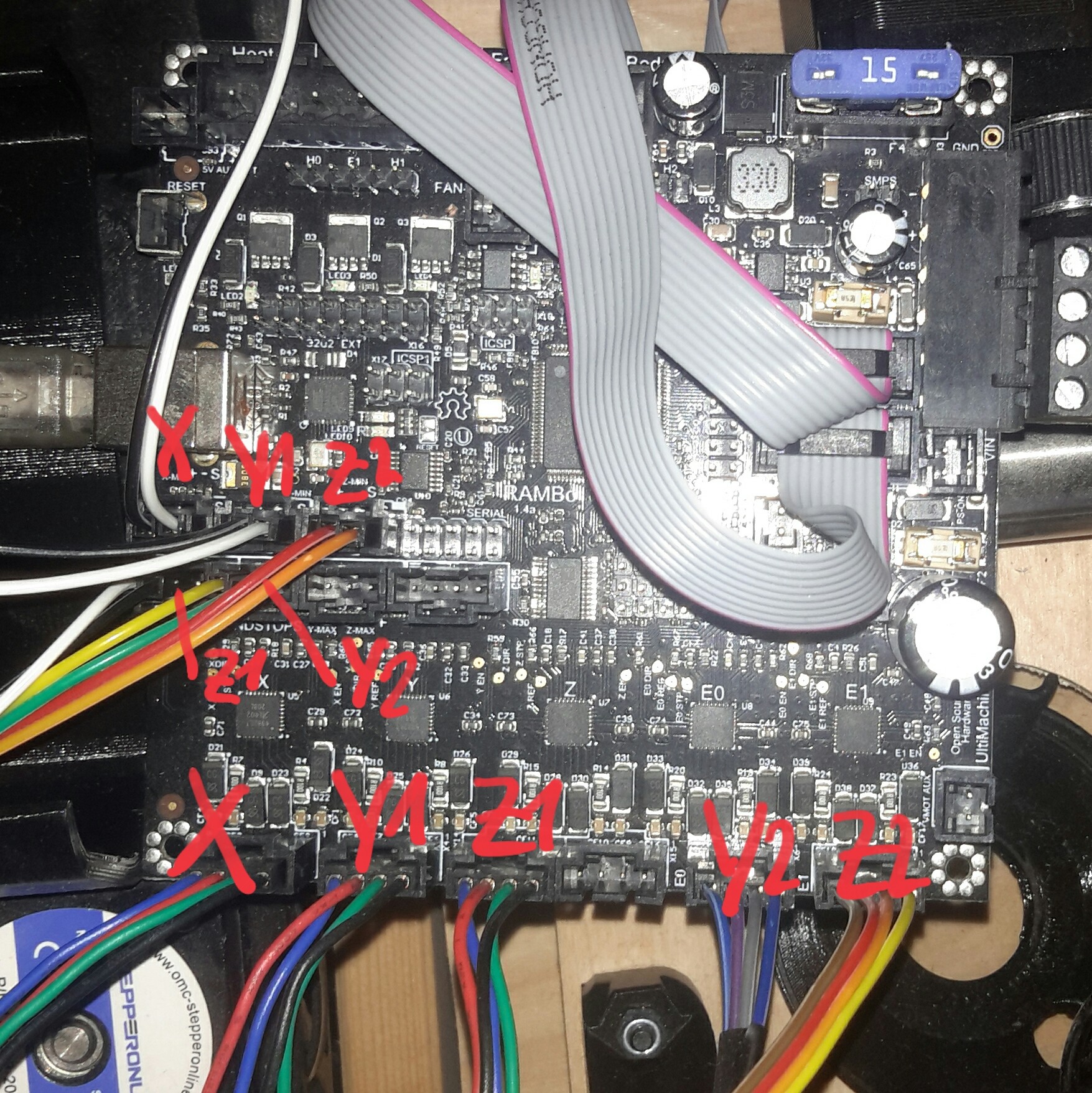

My Lowrider is still in work and i can’t figure out how to use dual endstop for the z-axis. The z1-endstop is pluged into z-min and stops both z-drivers. The z2-endstops pluged into x-max doesn’t do anything. That is sometimes, but another times i need both endstops triggered to stop the drivers.
I’ve made this easier since you were here last. Head over to MarlinBuilder releases and find the v1cnc rambo dual lr version. It homes up, using Zmax and Xmax. It also probes with G38.2 Z down with Zmin.
Thanks.
If I use the new firmware I have the same problem and one triggered endstop shows multiple triggered endstops with the M119 command. Maybe I wired it in the wrong way. Here is a photo, ca n you spot some mistakes?
Check out this:
The Z doesn’t look right.
Thanks a lot!
Now the only problem is that z homes up and when we change Z_HOME_DIR +1 to -1 in configuration.h one backstop triggers 3 to 4 steppers.
If you want to home down, there is a lot more to do. Unfortunately, we had to make some choices for the LR config, and we chose to home up so it wouldn’t rest on the switches, and then use G38 to probe down. We also had to make Y the dual axis, because it isn’t easy to offer x or y.
This is really trouble from the popularity of this project. There are so many users that we have to sort of take a common road on some things. If you want to venture off, cool, but it won’t be turnkey.
