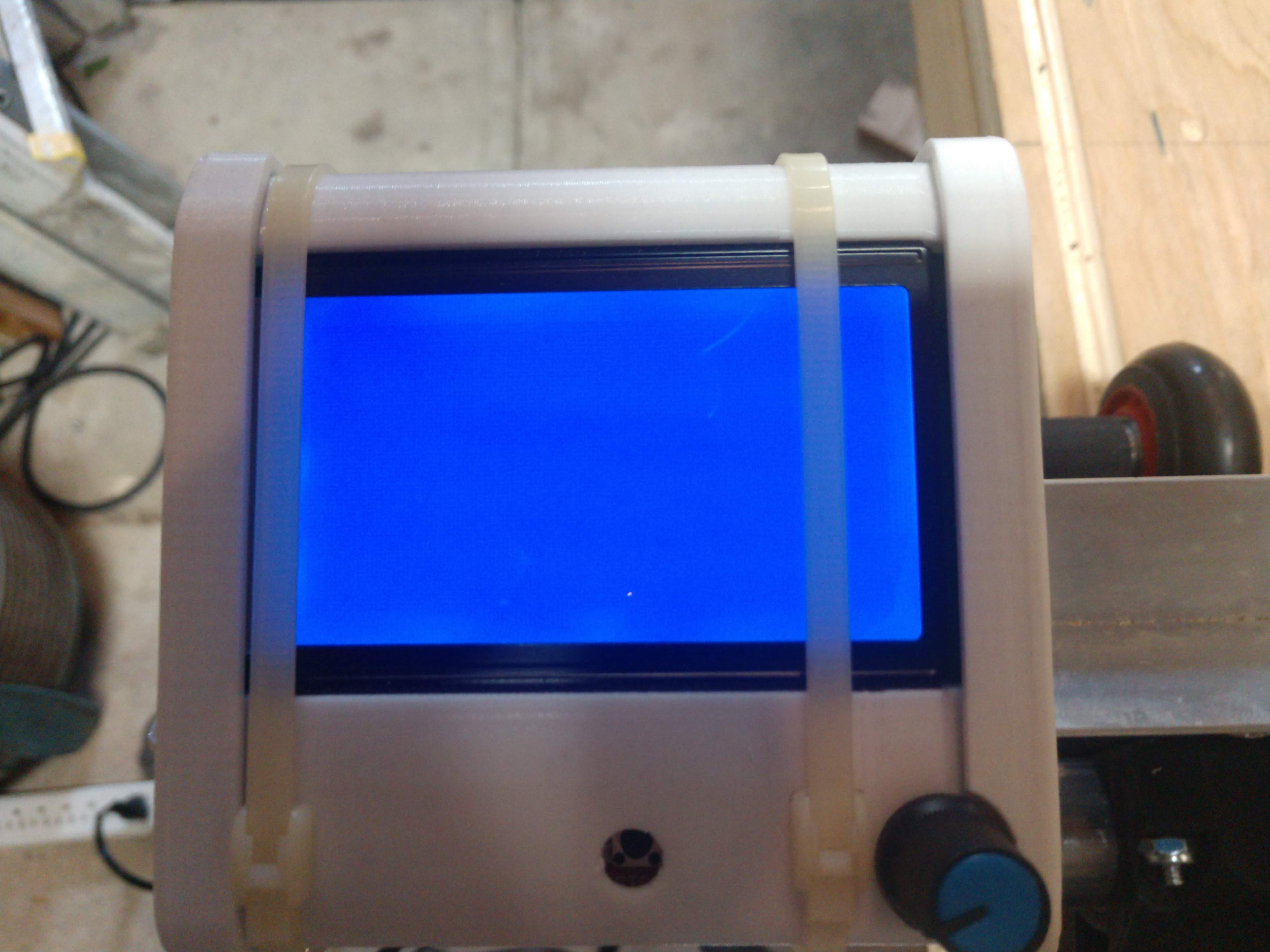

This is common. The lcd cables need to be rotated, swapped, or both. Sometimes they put the keys on the cables backwards and you have to shave them off, or pull the shrouds off of the PCB.
Okay, so the display lights up but no other info on it. I swap cables display no power. I flip the cables and get some as original. Display lights nothing else displays. Waited for a boot strap of some sort, nothing just display backlit.
do I need to install some from SD card?
still testing no luck. Connected my new Windows 10 laptop with USB cable see device. How do I look at configs?
There are 4 ways to wire it, and I’m guessing the keys are on backward. You have to rotate the cable in its port. Do it to both cables, and only do it to one end. 9/10 this is the problem and 8/9 of those times, people don’t believe me.
The 1/10 time is that you don’t have the right firmware flashed on the rambo. If you connect with repetier host, the console will print a bunch of stuff from the board, including the author, and there will be a version like ‘427D’. If you get that version, then it is configured properly, and you are in the 9/10 case again.
Tried every wiring config possible. This is the data from the boot of Rambo 1.4 sourced from V1 with end stops. Why I am having issues is very disturbing. I didn’t realize I need to debug so much stuff to do this
This is the log from the boot of Rambo 1.4 from V1.

19:24:17.204 : ok
What now???
Getting upset that I have to go through this since i sourced the board from V1 expecting it to be almost plug and play.
I have spend many hours today chasing this! Getting OLD!!!
Then I guess I’ll need to flash this thing and I don’t know how to do that then I’ll spend hrs looking how to do this. Please help me get through this!
@vicious1, looks like it didn’t get flashed.
That is a bummer.
There are instructions for flashing it here:
i’ll give it a go. Some FINE QC FROM V1!!!

Jeff has steered you correctly to new firmware. Somehow I did not flash it, but you will need to flash it occasionally when there are updates so it is good you have both our attention to help you do it. The instructions are step by step with a picture for each one. Start from the top and make sure to get the ug8lib in and see how it goes.
Fantastic news I was finally able to flash the board with PlatformIO with VS Code. I still like the puppy after chasing his tail
. I how have to move on to modify the config for dual end stops X1,Y1,Y2,Z1,Z2. I have to modify them to work in this design. I have read almost everything in the forum on LR2. I think I can use VS Code to modify the configs. Any additional help is always greatly appreciated. Can’t wait to make some dust!!!
