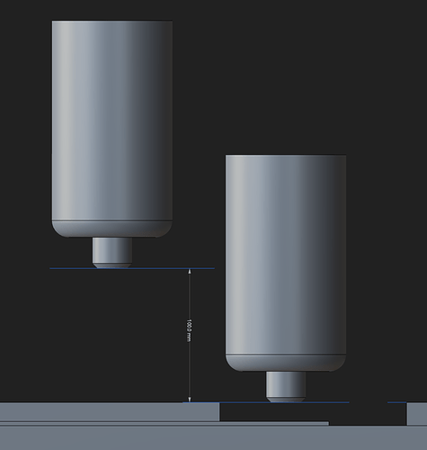

But was thinking about the same thing. Is there any downside to just doubling up the mdf strips on the side rails to get another 3/4 inch cutting depth?
I assume a mill will make up for the 3/4 left? Or am I missing something here?
(The surface on the left represents the spoil board)

Using another set of MDF strips is what I call lift plates on my LR4.
To be clear about what that gives you, it allows you to accomodate thicker stock on your table, but it does not give you more total Z axis travel.
The use case for the lift plates is similar to a drop table, except the lift plates are super simple.
Note that the LowRider machine is very cleverly designed to be most rigid when the cutting tool is closest to the table, and either lift plates or drop table allows you to tune that rigidity to be right at the top of the work piece.
If you need more Z azis travel, you have to go about that in a very different way.

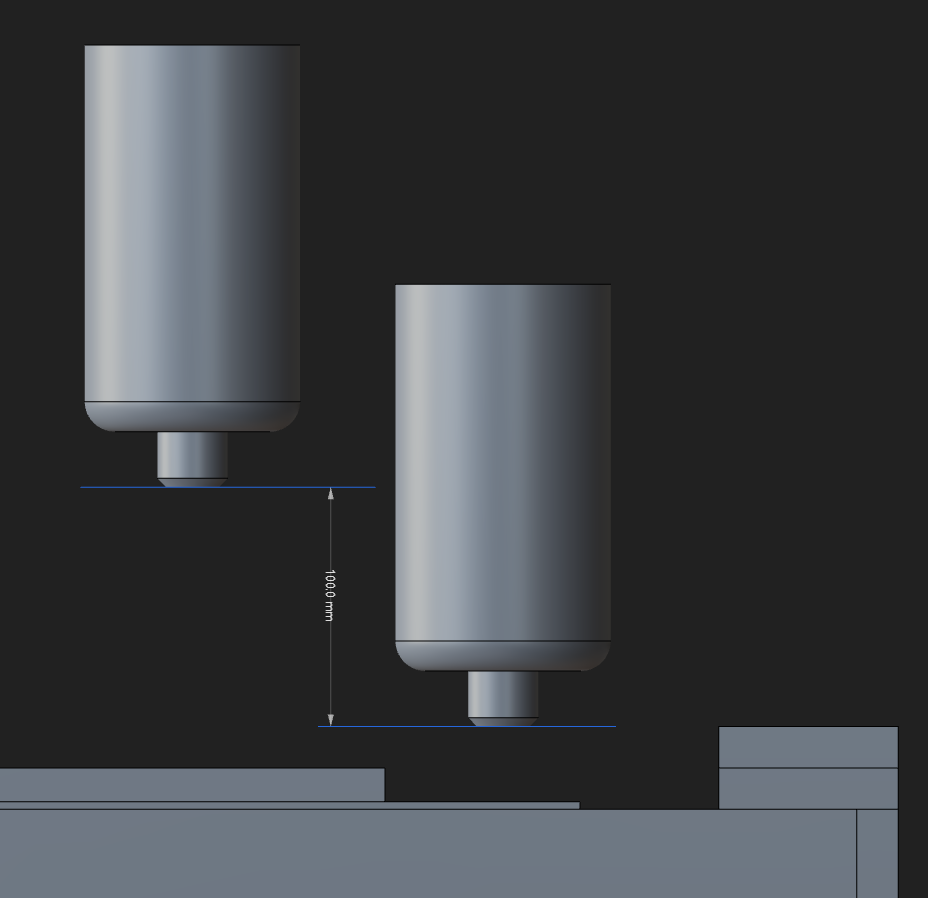

You are correct, what I’m looking for is not more z travel. But being able to accommodate thicker stock.
My question I guess is if I raise the rails by 3/4 will that put the surface of my spoil board out of reach of a normal milling bit, so that I can no longer create through cuts on normal sheet stock? Or is there still plenty of reach?
I think the idea is to add or subtract plates to compensate for differing thickness of stock.
In my case it isn’t, but I’m not going to add much height and my regular endmill for wood is still going to be able to cut slightly into my spoilboard. If using harder materials I’ll need to shim them up to use shorter endmills.
