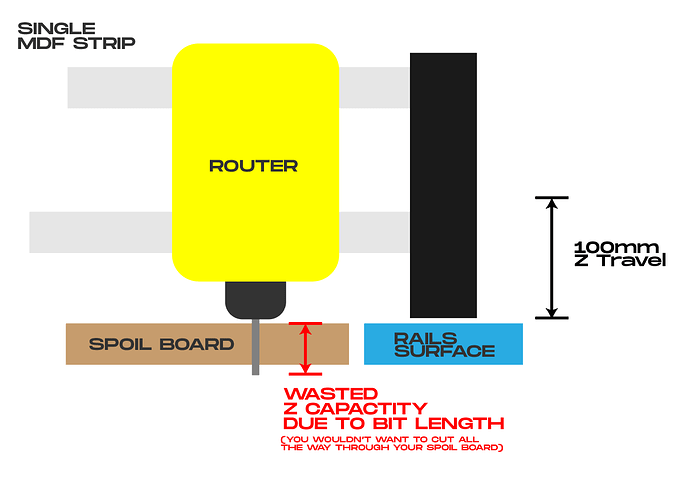

I’m about to start building the table for the LR4 based on the $200 build guide.

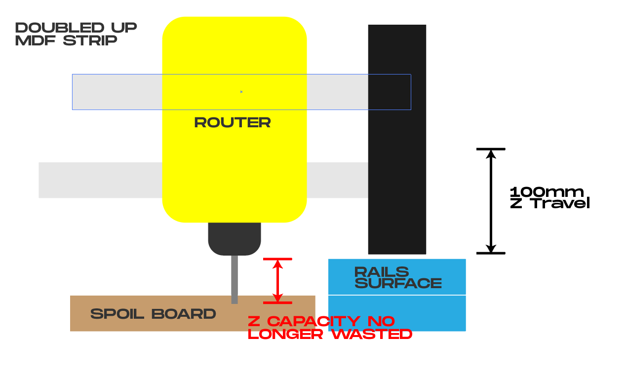

I want to maximize the thickness of stock I can mill, so one of my questions is if I could safely raise the rails by 3/4 of an inch by doubling up on the mdf strips, without loosing any through-cutting capacity.
At the default setting of “rails” and spoilboard all being the same height, how close is the collet to the surface of the spoilboard? It sounds like it will touch the spoilboard, which I imagine is not something you would ever really need since most milling bits will stick out at least 3/4 on inch, so couldn’t you just raise the rails by 3/4, gaining 3/4 of stock height (since your not “wasting” z latitude “beneath” the spoil board)?
Or am I missing something?
Here an illustration to clarify:
That depends somewhat on the router being used, and how it is mounted on the core. The best answer would be to build your machine, and then measure it..
Usually the collet is some distance above the spoil board at ZMin. As noted above, that distance may vary among different builds
Not necessarily. I have mills that range in “stick-out length” from 1/2" to 1.5" . Some V-bits are very short, and larger (1/4") shanks can be much longer. If you always use the same bit, you can standardize the height of the router collet above the spoil board, but changing bits for different uses will require varying the collet height.
Yes, raising (and lowering) the rails (and running surface) using additional layers of MDF to optimize the amount of Z travel is a thing. In general, for through cuts, you want ZMin located such that the bit is just cutting a few mm into the spoil board. This adds to your build stability.
Note that your spoil board may have height variations (warping), so adding a few extra mm of depth cutting into the spoil board may be prudent.

I measured that when the rails and the top of the spoilboard are at the same height, there is about 16 mm of clearance below the core. Since I want to machine aluminum with a shorter end mill, I would only raise the rails about 5 mm above the spoilboard height. On my LowRider 4 the Z travel is around 110 mm, so I still have plenty of movement available.
In my case, the bottom of the core is exactly at the same height as the bottom of collet of the router.

Oh okay. If that’s the case with mine, it shouldn’t make much sense for me to raise it much then. Some of the 1/8th bits I have are only about 1in long.
