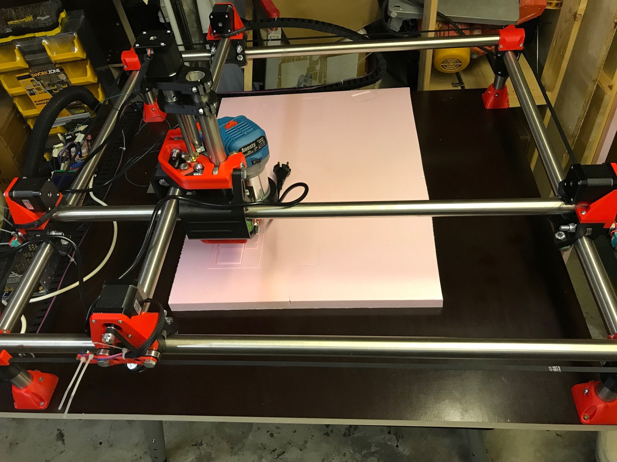

Hi everybody,
I have a somehow spooky behaviour of my MPCNC running an Arduino Mega with Ramps 1.4, double end stops.
If I try to drill/mill in hard foam as a test the drilling depth measures exactly what I expect it to be. But when I change to some harder material like wood or some plastics the drilling depth can’t be controlled. So if I want to mill a pocket the machine goes straight through the whole wooden plate.
The test showed that the g-code did work as expected in foam.
Is it possible that the current of z axis is too low to hold the position?
Thank you for every suggestion!
Greetings
ramps14megabuild

@Guffy: I’ll upload a photo later even I don’t think the stepper looses steps. Loosing steps would lead to stopping earlier than expected, wouldn’t it? Sorry for the bad quality. Spindle is a Makita R07xx-type.
A few more pictures of your overall build will help.
Well you do have a very large router on you Z axis so it will need to be extra smooth but knowing nothing about your build I will wait for some pictures before making too many guesses in the dark.
Afaik this makita weight is 1,8kg and it could use 6mm, 8mm, 1/4" and 3/8" bits. No 3mm, no 1/8". On the photo it looks like 6mm
@Guffy: You’re right. I’ll post some photos later this day.
The first thing I see, which might not matter but could, is you have the nut for your Z axis lead screw on the top. If it’s on the top the only thing keeping it from ripping loose when you raise Z is those little screws. Better is to mount it on the bottom so gravity holds it in place when lowering Z and the lead screw itself pushes it in place when raising Z.

ensure that you can’t slide down spindle by a finger when z stepper is on
check current on z stepper (voltage on the driver. i use 0.82V /DVR8825/)
@Guffy: I can’t slide down the spindle by finger but turn the spindle by hand when z stepper is on. Voltage on z stepper is about 0.71V on A4988. I’ll check raising the voltage to 0.8V.

Sorry for my late reply: I can’t read what resistors I have on PCB. I’ll test today. My steppers can take up to 2A. I’m aiming at 1.7 to 1.8A as stepper current (w/ active cooling).
Vref1=1.7/2.5=0.68V (RS=50Ohm)
Vref2=1.7/1.25=1.36V (RS=100Ohm)
I see the voltages might double depending on RS. So I have to verify what resistor is set on PCB.
Edit: Verified Rs=100Ohm.
Thanks for your hints. Raising the voltage to 0.87V did the job! MPCNC is working as expected!
You guys were a great help! Nice experience to listen to your advices! Thanks again!
