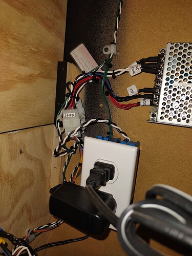

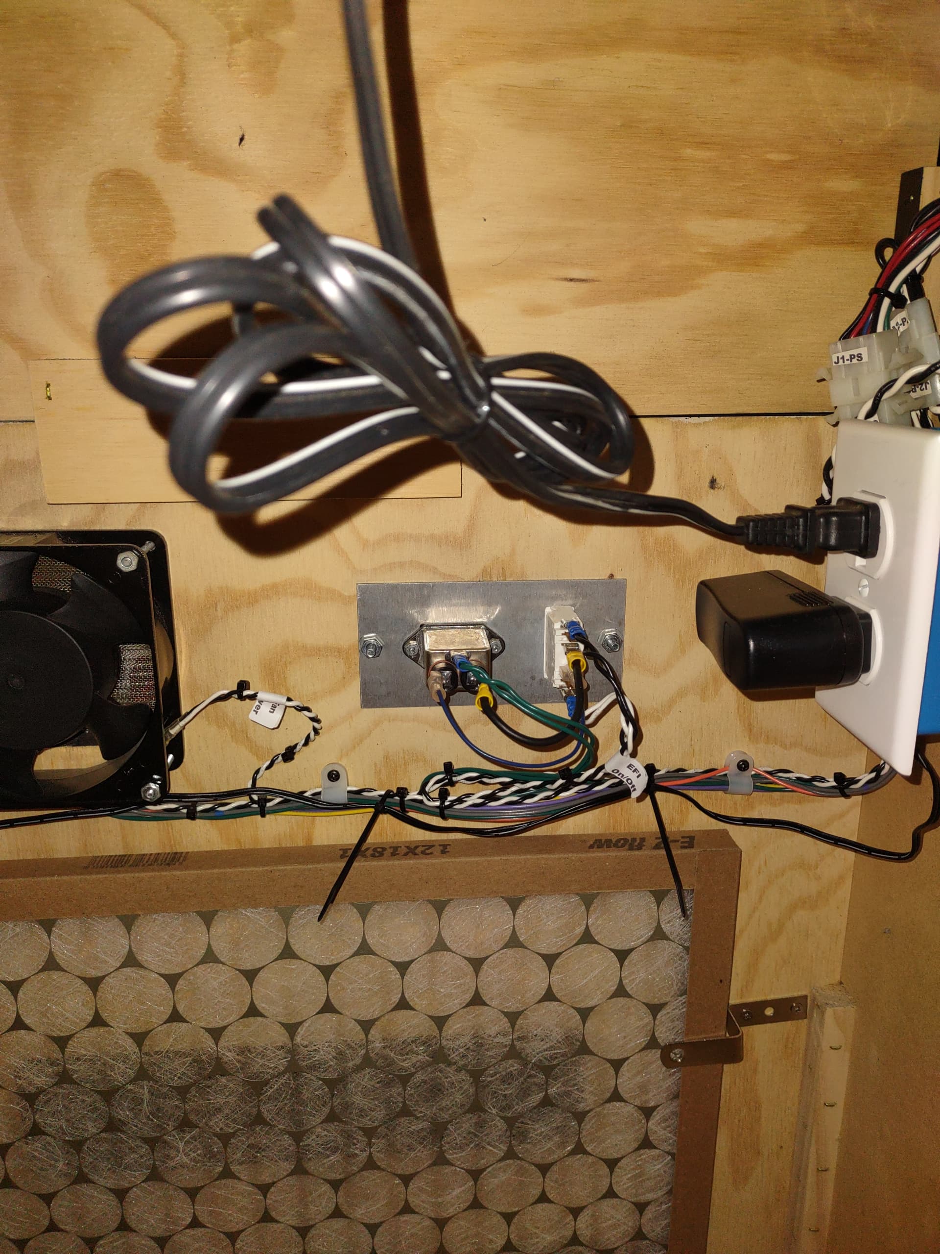

Hello! I am getting to the wiring stage, and I have a question. I got the interlock switch/power plate but dont have a clue what wires goes where on the interlock? I cant find anything on searches outside of those single on/off switches. Can you give me a picture/pictures of your power/lock wiring? I looked at your build pictures but I couldn’t find any shots of it. Also, did you run your power outlet right off the power supply? This build cost me a small fortune and I dont want to screw it up! Thanks a ton!
Hey man, I got you! I’ll take some photos in the morning of the interlock! I just got back home tonight, and I’m beat, but check back in the morning and I’ll have some photos for you.
As far as the outlet goes, I just wired it into the harness using the monitor power if I remember correctly. Since I wasn’t using that section of the harness, because I have a TV in mine now, so I think that’s the part I used. I’ll also verify that in the morning when I open up my cab to take the photos for ya.
And yes, it’s easy to sink a ton of money into one of these, because of all the expensive parts!!! haha I think I have close to $3000 in mine, so I get that ya wanna know for sure before you start the electrical! And I don’t blame ya one bit either.

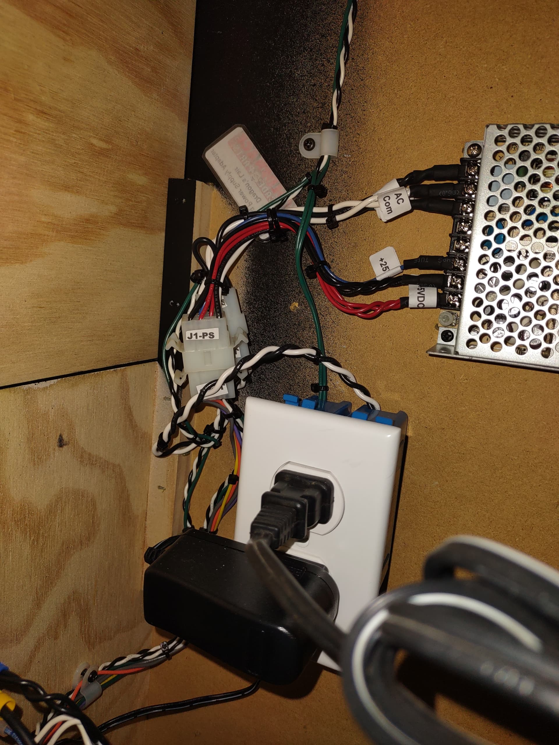

Ok, here are a couple of photos. If you need more, I’ll slide it out and do a deeper tour of the machine. If you’re using the Golden Age harness, this will make sense to you. If you’re making you’re own, I’m not sure if this will help.
It’s been a while since I did mine, so I have to refresh myself as well. Here’s the outlet I put in, and it’s tied into the cab’s main power.
Here’s the switch panel, mind the little blue wire. It jumps from the plug, to the interlock. Then the right side post, ties into the interlock as well, to give you 2 way power (interlock pulled, or pushed) Not sure the ‘push’ part is necessary since the cabinet doesn’t have anything there to keep it pressed. But that’s how the original was, so that’s how I did mine. The ground is from the main harness, as is the hot and neutral. I used the monitor power to supply power to the receptacle since I’m using a TV and those were free to use. The TV and the Dexter are plugged into the receptacle to supply power with the switch. Works perfectly.
Let me know if that’s not clear enough, and I’m happy to dig in deeper and try get better pictures.

That helped a lot! Hopefully I am good to go for now, I really appreciate you taking the time for this, nice pictures and explanation!
