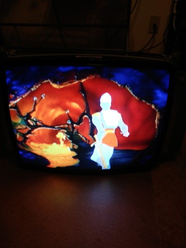

Just a lil eye candy for ya… Not a bad picture for a 40 year old monitor… Zero burn in at all. That’s what fresh caps will do for them tho. Make them vibrant and pretty again.
