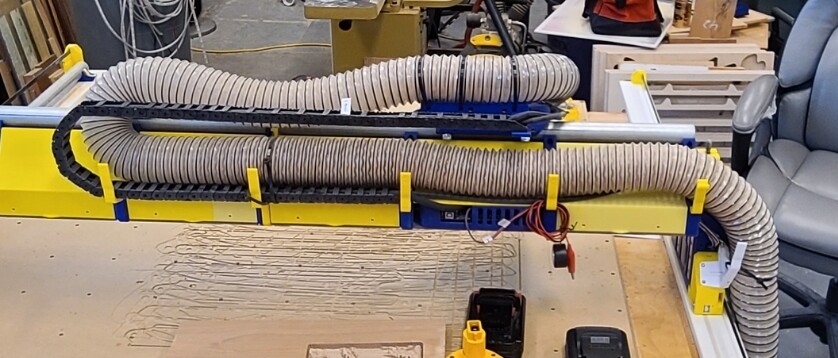

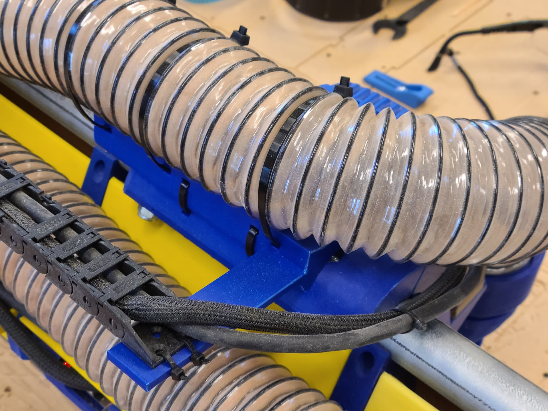

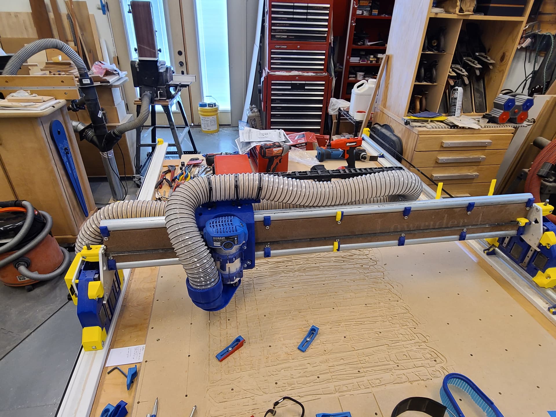

Unlike many LR4 installations, my dust collection MUST come from the side. My ceiling is 12’ high but my central dust collection is under my raised floor, so, together with the need for pretty high static pressure for the router, a dedicated shop vac is the only practical solution.
The problem that I had is that the dust hose and the cabling are not actually aligned for part of the path, so I initially had lots of problems with wiring getting caught or it causing the vac hose to lift out of the tray. But, in the end my modifications work pretty well (>90% without issues.)

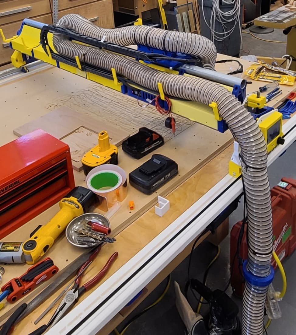

Here are some pictures.
Note that the cabling and drag chain are on a separate path almost immediately…they are never attached to the vac hose. This allows nearly complete independence of the two motions.
This shows a slightly different angle. (Please ignore the clutter!) You can also see the magnetic disconnect for the vac house as well as the LCD display for the SKR 1.3 control board that rides on the end of the LR4.

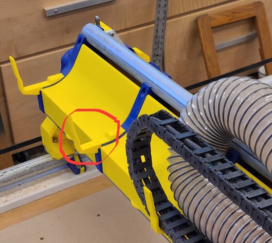

Front view. It may be possible to see the “core extender” that I added to keep the two paths separate.

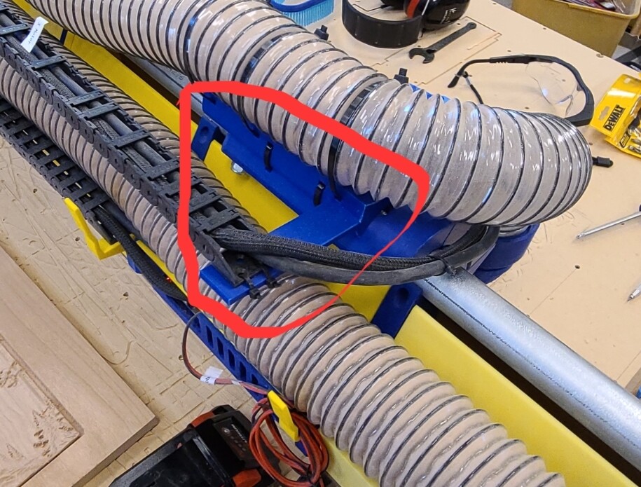

The extender does two things. First it provides a location to attach the drag chain so that the cables can be fed into it. Second, it extends beyond the end of the core so that the vac hose has a couple of inches more surface to which it can be attached.

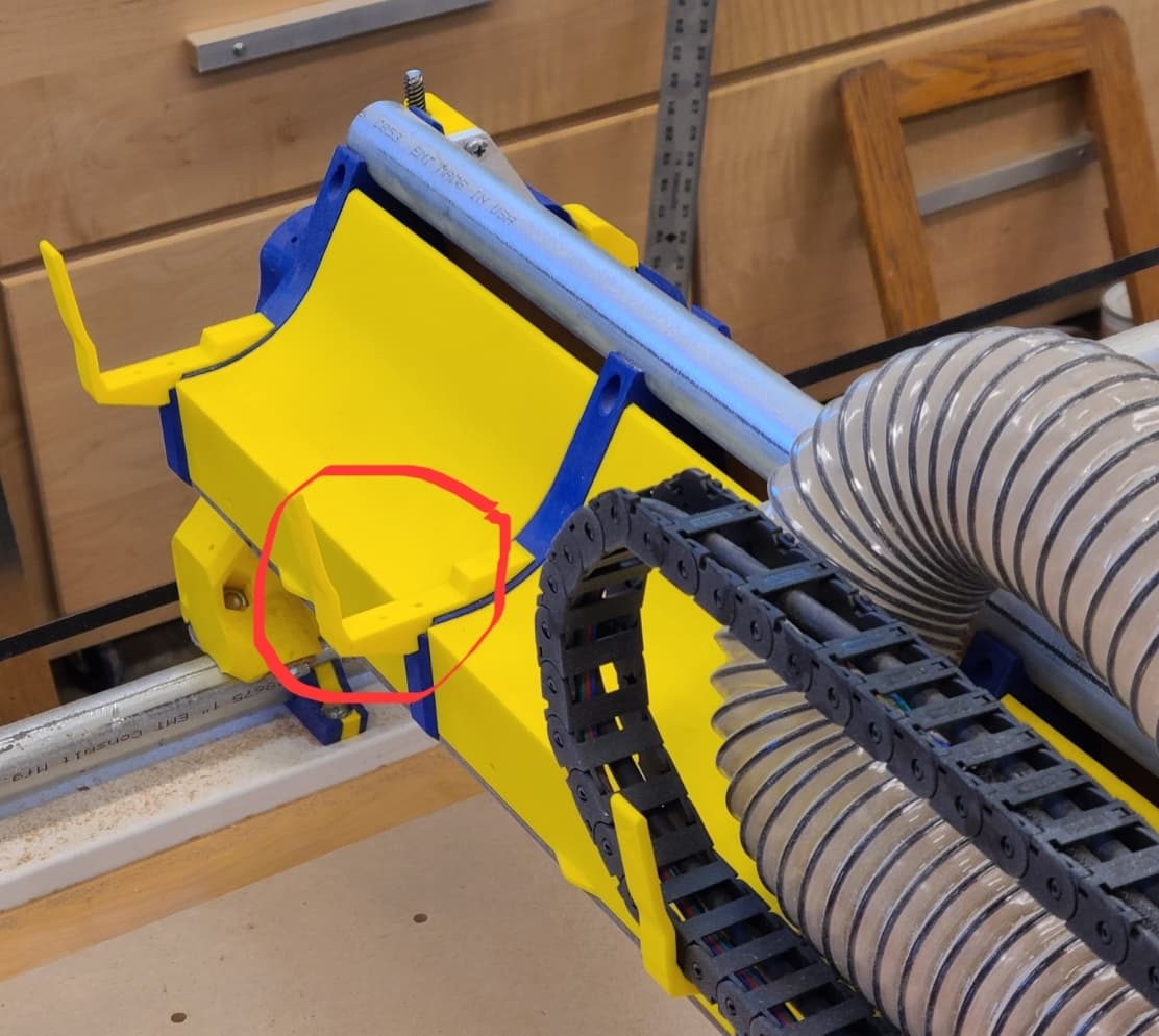

And, a closeup of the extender:
The extender is my own design and is just cable tied to the core. There are some tweaks that could be done, but so far have not been critically needed.
Finally, I have slightly modified the braces that hold the vac hose in place. They also provide a location to attach the drag chain.
Hopefully this is fairly clear without being unnecessarily detailed. At some point, I’ll try to post the ”extender" design on Printables, but that may take a while. The design is in Onshape, so if someone needs it, I can post a link here or something. (I also plan to post a video but that will be even longer…

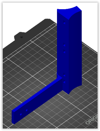

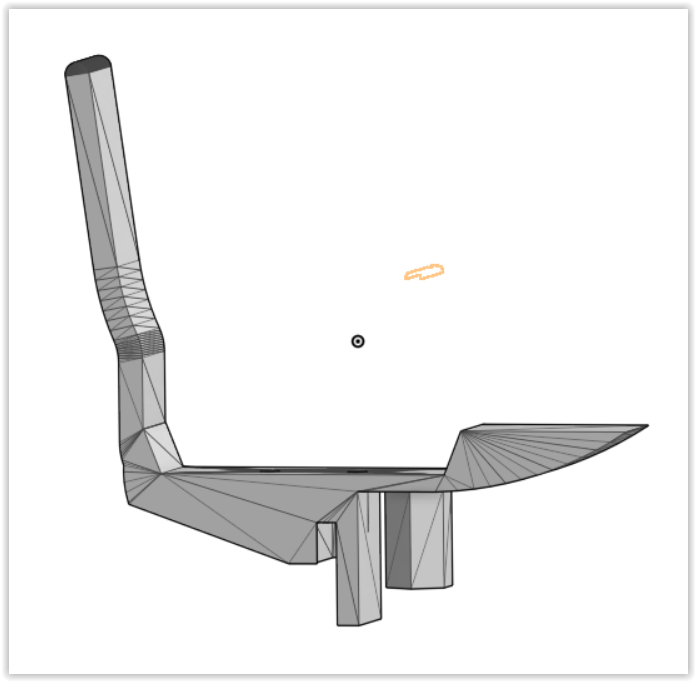

Here is the 3MF file for the hose hook and drag chain attachment bracket. I replaced all the default hose hooks with these.

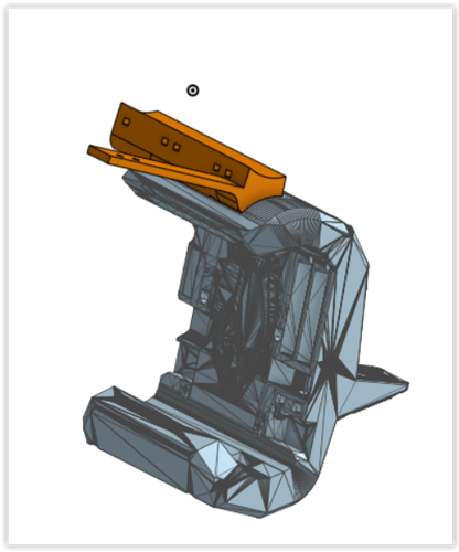

Apparently, this is not my design since the figure which is imported into Onshape was clearly an STL file. It’s possible that I combined a couple designs the get this one, but I don’t remember and right now can’t find the original Onshape design which probably means that I combined the STL files…
Anyway, here’s an image:
And, here are a couple of images of the core extender, one installed onto the core.
And, the core extender file:

Hose bracket file:
hose hook and drag chain parts.zip (99.4 KB)
I must alert you to the fact that in the interest of doing this quickly, I wasn’t able to find the design file for the hose bracket. The core extender is in Onshape, but, the version that I found seems to be slightly different from the one that I finally used. (Sorry for this sloppiness…. )
If you try these pieces and they don’t seem to work properly, I can spend more time on this. But, hopefully, you’ll get the idea easily. (And, yes, I really DO need to fix the core extender model. It’s not anything special, but, may be useful for others so it belongs on Printables…)

In case it’s not obvious, to mount the core extender, you will use two cables ties to attach it firmly to the core using the two holes that are in the core, normally used to attach the hose to the core. The other three holes are used to attach the hose.
I think that the photos and images should make this clear, but if you have questions, let me know.
