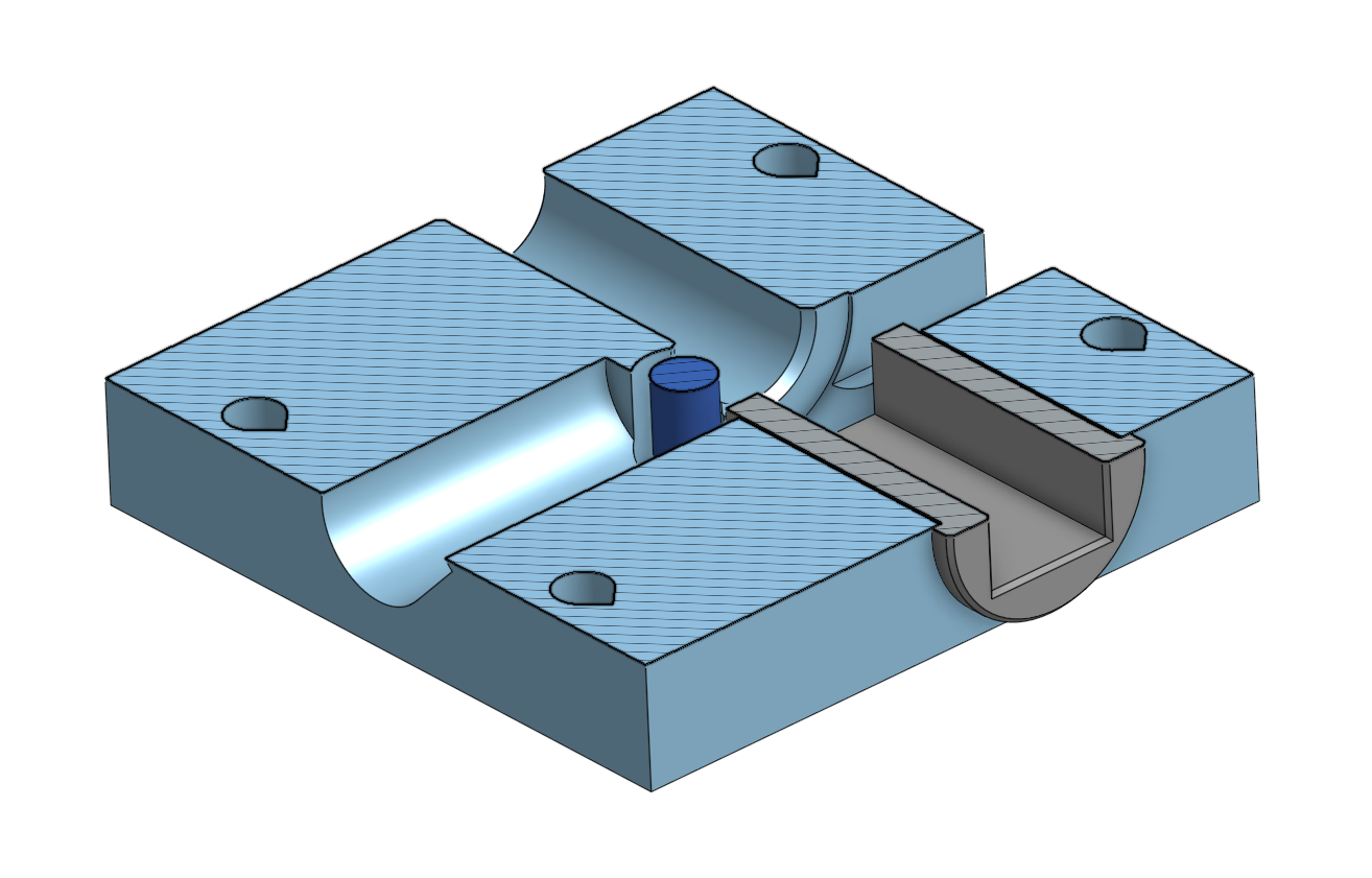

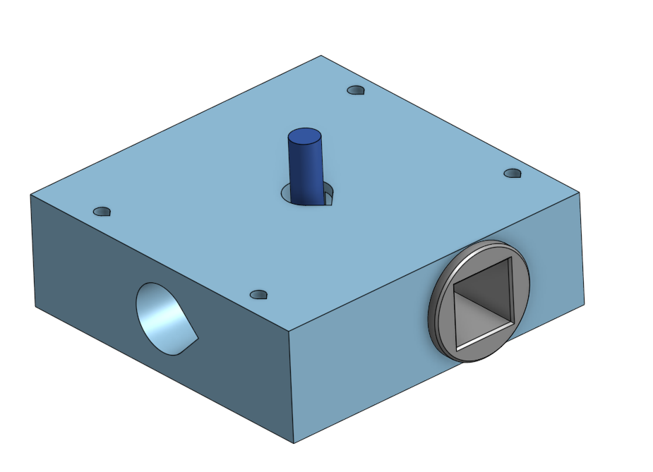

I’m still kinda hung up on the router/live tooling idea. This is where I got to a while back:
My thought was to print a block body with a dowel-sized hole going through the middle. Router mounts on top positioned so the tool ends up tangent to the final shape and a hole through for the tool. Counter-bored section for a rotating plug to support the square piece going through. Cross-hole bored for a shop-vac for chip extraction.
My main concerns are:
  • I think the router will need to be positioned quite accurately if I’m going to get it to cut on size so I probably need adjustability for position, even just +/- 1mm.
  • There’s no visibility into the jig so I’ve got no idea what’s going on… I could mount the router upside down and cut an inspection hole in the bottom, I guess.
  • Until the dowel is all the way through, I suspect it may chatter really badly.
So I’m really not sure whether to pursue that further or to try a more conventional lathe type approach.
Might add an additional guide bushing on the exit (for changing the dowel diameter) and an adjustable position for the router, so you can sneak up on the right diameter.
That should help with chatter until the start of the dowel fits into the exit guide bushing, at which point you can take heavier cuts.
Edit: might also move the dust extraction cutout to have more of an opening on the side the router throws it’s chips towards.
The adjustable bushing on the exit to change the diameter would be a great next step. For the moment I was keeping it a bit simpler by focusing on making one that’s a single size. Can always just print another one for another size!
Having a rotating bushing to support the square section on the output is an interesting idea that would allow for lighter passes which could in turn make it plausible to use with a palm router rather than my 3HP 1/2" behemoth. I had intended to be single pass but with relatively slow feed rate, but multiple shallow passes seems like a less ‘all in’ first step.
The router would be on top in this orientation. I’ve put it in this orientation so it would be conventionally milling and should be ejecting the chips towards the dust port in the ‘bottom left’ direction. The cutout in the ‘top right’ direction is to allow airflow in to keep the airspeed up, in theory.
That’s not what I was intending to go at, but a heavy cut is going to cause the workpiece itself to chatter more, no matter how big the router is.
So I was thinking to sneak up on the cut until it fits the (round) exit bushing and once you got the leading end of the dowel to the right diameter, hog out the rest with whatever bite the router can manage, wood is now properly supported on both ends.

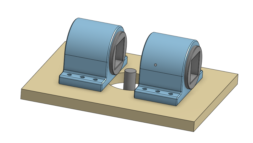

Yeah, I think I follow you. I was meaning that there’s currently no way to support the outfeed unless it’s all the way to size, so having the same rotating bushing at both ends would work and allow shallower cuts, at least until the piece is round enough that it’s not well supported by the square bushing anymore, at which point it could just be swapped. I also thought a possibility would be to use either an existing correctly sized dowel or a 3D printed piece screwed/doweled into the end to ‘start’ it, if it ended up needing that.
I’m not sure of a good way to do the router position adjustment with it cutting on the side of the blade. I really wanted to use that so it was rotating the work into the side of the blade, but I wonder if it might be better to have the router positioned above the dowel and then I can use the plunge base and depth stop to set the tool position relative to the workpiece.
I definitely like the idea of being able to do this in shallow passes, at least at first.

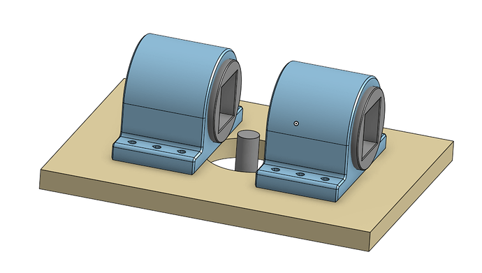

The whole body was proving to be a pretty big/expensive print so I might try to make one that’s in a couple of parts and just screws down to some scrap, for now. That would make it quicker and easier to iterate, at least.
Something like printing a couple of test pieces and screwing them to some scrap MDF that can then be mounted to my router plate.
Like this, perhaps:
Would at least verify the idea without needing most of a roll of filament and 10 hours of printing.
What if you designed it for a router table with a fixed mounting system?

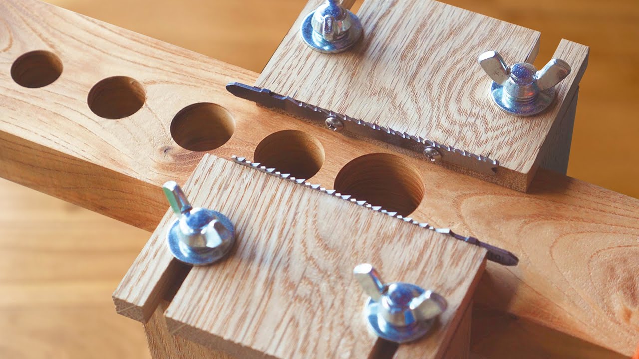

Not sure if these ideas would scale to the length of dowel you require, but this guy is one of my favorite wood tubers and this vid has many ways of making dowels! At the very least it could give you inspiration:
I definitely could. I have a home-made router table and I could clamp it to the fence then shim it into place, I guess. With the goal of having it be sub 1mm accuracy on the final OD, just doing it by adjusting the fence might be a little bit tricky.
I’ve seen the ‘chisel clamped to a block of wood’ approach before but had forgotten about it. Using jigsaw or handsaw blades is a cool idea. It’s simultaneously obvious and yet something that I’d have never thought of or believed would turn out so well.
