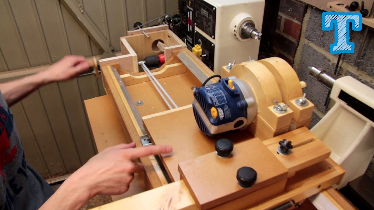

Haha right?? All of his videos are just like that one too, dude is clearly a master of many disciplines
this link gave me the idea , but building it using x and z axis of the low rider but setting Z as y movement if that makes sense thought would be more rigid for the router and controlling it via jackpot board

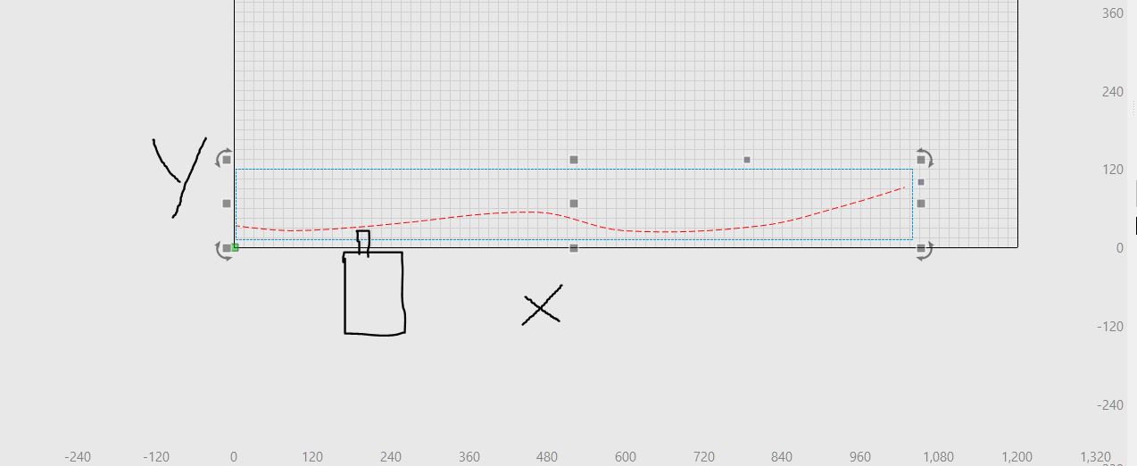

this is my crazy way of thinking weather its logical is another story
using a profile
operation to create design
So you’re saying you’d have the gantry stationary and turned on its side, then moved in and out relative to the lathe using the linear slides. That would probably work but you might see some backlash issues with the lead screws, potentially? I think the LR4 uses gravity to its advantage in a few cunning ways in the design, that being one of them. No idea if that’s an important issue or not.
You could always have the gantry positioned so that it sits on top of the lathe, perhaps? That’s what I’d be tempted to do, unless there’s some specific reason it makes sense to have it out in front? You could 3D print some fittings to mount to the head-stock with locating pins so that it just drops into place or something?
It’s so interesting think about how to approach this in so many ways. I don’t have a lathe and it’s not really something I have the space to dedicate to so I’d be more inclined to get to the same point using a rotary axis type scenario. On the other hand, if I had a lathe then aaaabsolutely I’d be trying to mount an LR4 gantry to it.

agree re cam , trial and error i guess ,as said way i look at it x and y will follow a curve looking down on table swapping y to the z on LR4 should follow curve on lathe
