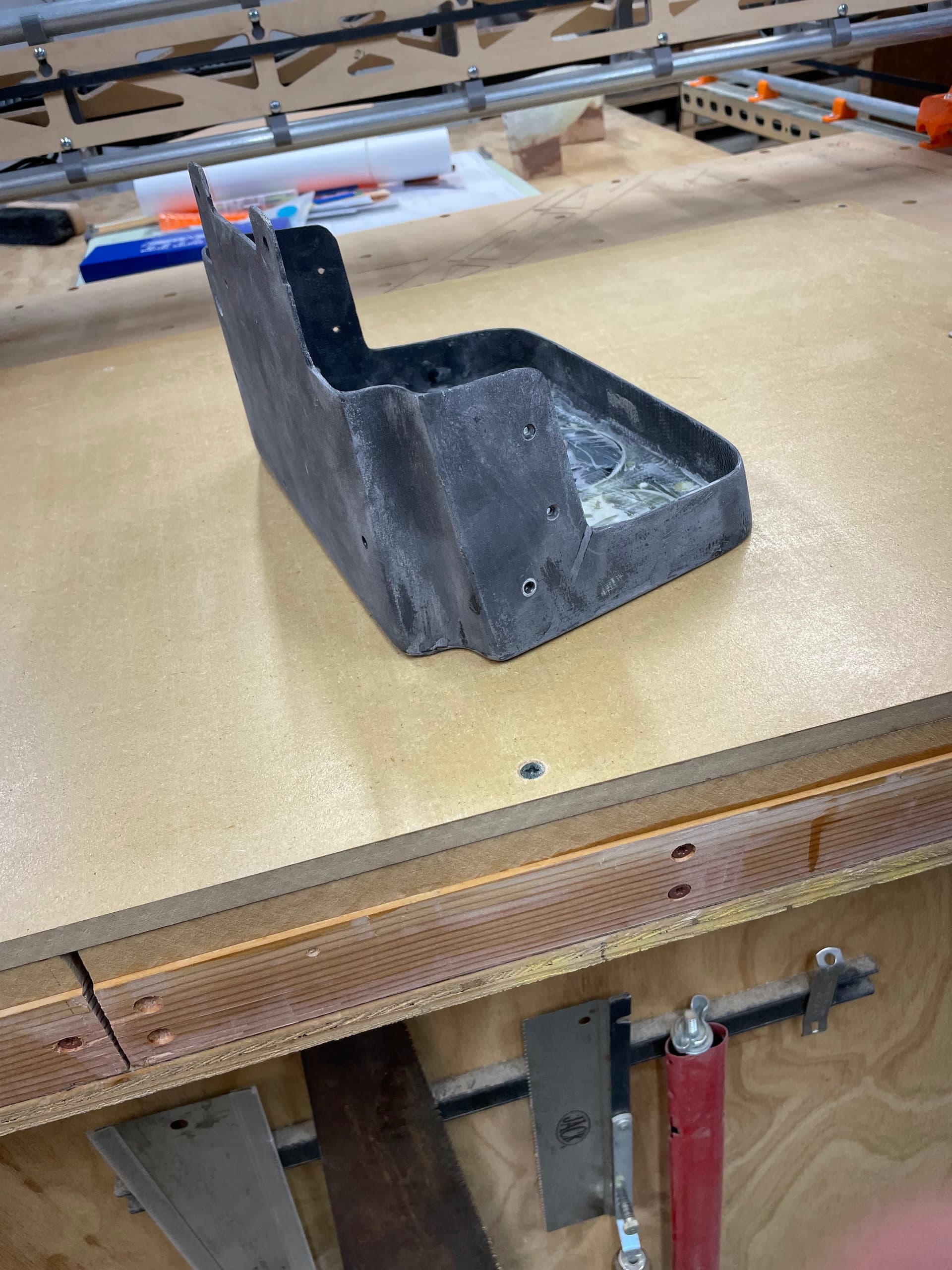

Here’s a example of the most challenging panel I’ve done to date:
Note the inward sloping edges that I need to clear with the back portion of the instruments. In other words the face of the panel, where the instruments are seen, is larger than the available space directly behind the forward edge of the panel. Fortunately, on this panel I have plenty of room.

The front face is always flat, and the back surface of the mounting area is also flat and parallel to the front face. Everything else is whatever the manufacturer needed to do to fit and mount it into the glider.
Here is a picture of several panels, lying face down on the LR3.
The three in the back are for one two-place glider, and the other two are from different manufacturers.
At this point I think the idea of photogrametry is the best option. Back to more research, OpenScan with a Raspberry Pi looks like an option.
