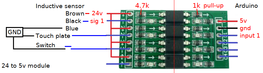

For Arduino inputs Estlcam suggests a 100nF capacitor between the input and ground and adding an external 1k pullup (5v > 1k > input) if needed. My original (still using) probe input has been problem free w/ just a 10nF capacitor (didn’t have a 100nF). All my other inputs (including a 2nd probe) are similar to (no 1k input pullup) the pictured 24v (my stepper power supply, other voltages available) > 5v isolation board which I would recommend to anyone using an Arduino.

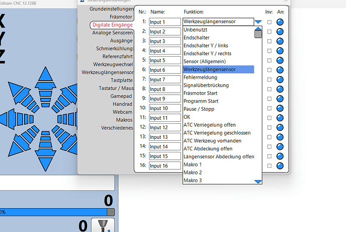

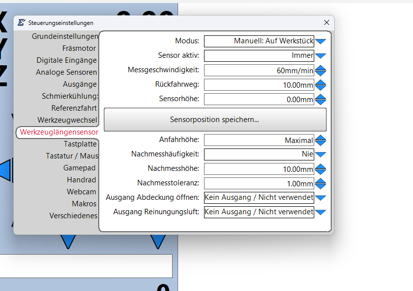

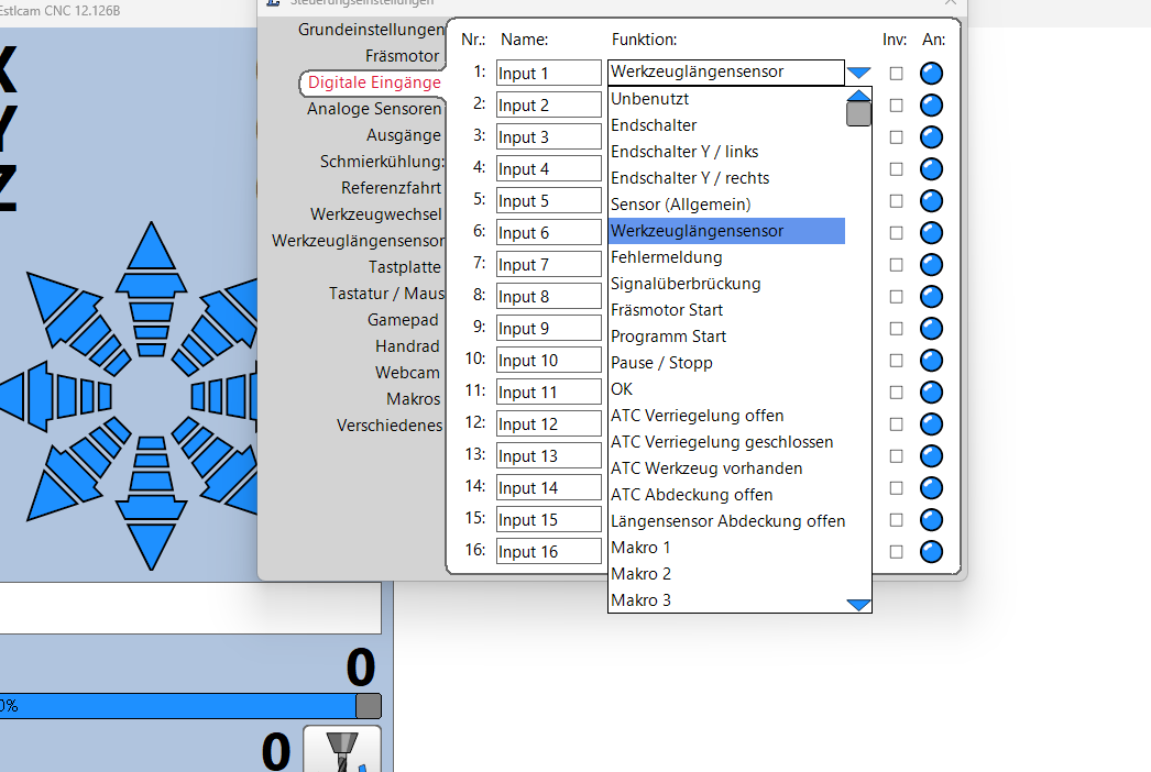

This one? And how do I set it to manual? Or am I looking at the wrong menu?
/edit: Found it, never saw it before. Thanks!!!
If that first one translates to ‘tool length sensor’ then yes :slight_smile:. I’ve also confirmed that the ‘manual’ ‘tool length sensor’ input is inactive when a program is running… The second one needs Sensor Active: Manual (vs Immer/Always).
