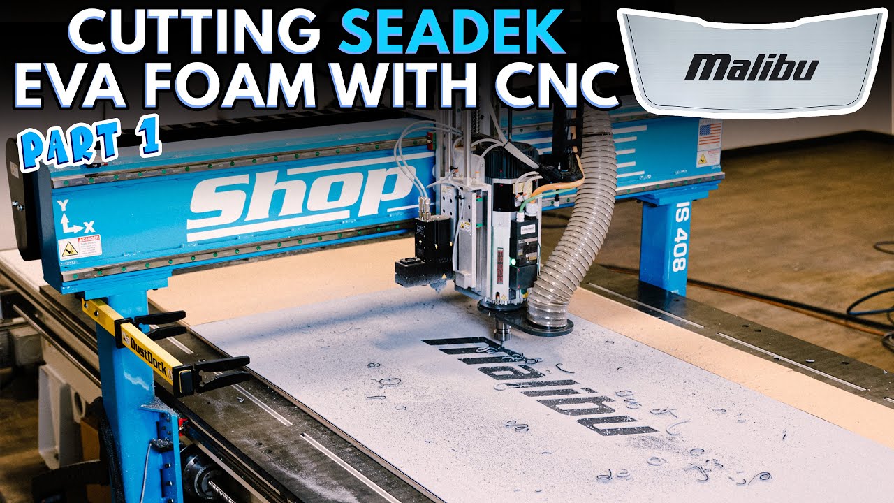

Something like this:
minute 3:06
Manually jogging to capture and trace paths/profiles looks very time consuming.

That seems like a really inefficient method. I’d have to see an example of what you’re trying to do. Even in their example, I would take a bunch of measurements and recreate it in CAD.
So it looks like you want to record a series of points along an existing object (pattern), and then use those points to create a 2D drawing that can be input into a CNC program (gcode).
Using the CNC to record the points looks like a very tedious manual process. If the pattern is mostly straight lines, it should be fairly straightforward, as you only need to record the endpoints of each straight segment, but if there are a lot of curves, the process becomes more tricky. It is possible to create spline curves in CAD programs like Fusion or FreeCAD with only a few points, but the results may not be very precise. The more points that define a curve, the more precise the spline will be compared to the original (but it will also require a ton more processing and calculating, which can create other issues).
I’m not sure of any way to record the individual points from the CNC, other than tracing the pattern using manual moves, then manually recording the points in a notebook or on a spreadsheet, and then manually entering those coordinates into a sketch in your CAD program. Seems pretty labor intensive, but depending on what you are tracing, and how many items you want to cut from the resulting gcode file, it may (or may not) be worth it.
